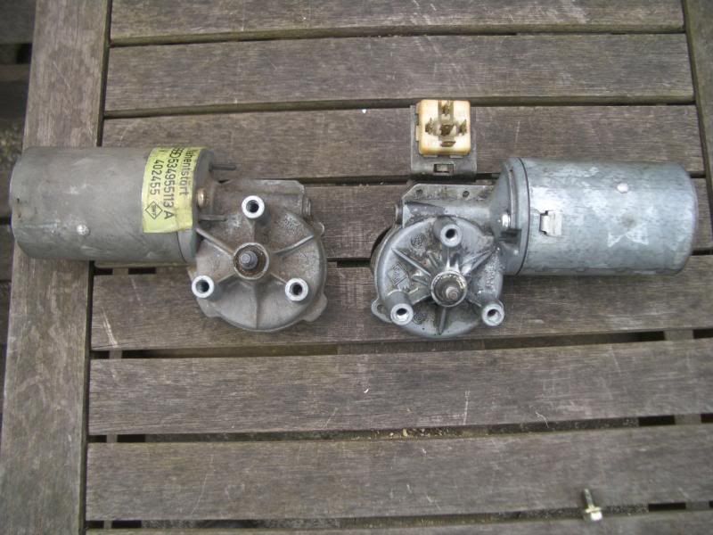

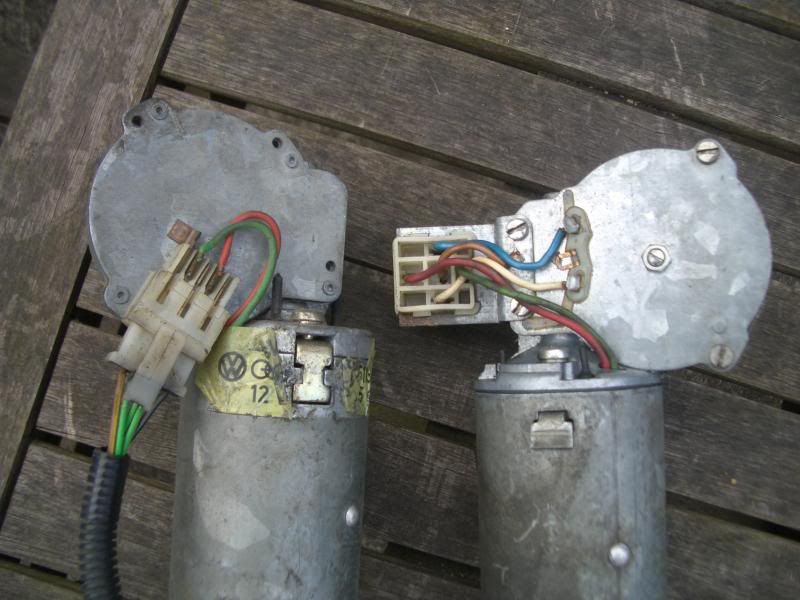

My Mk1 one is at the top of the photo, don't know what the did to end of the other assembly. Also note the differnet plugs and motor angle.

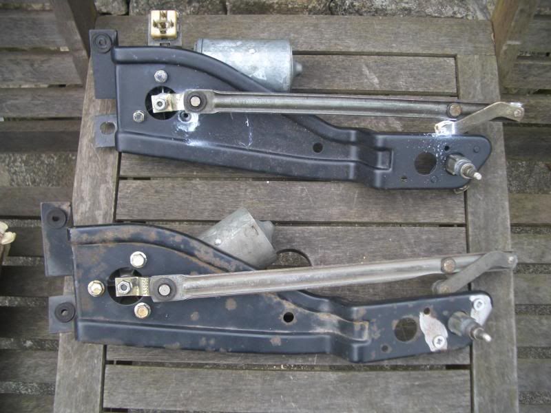

My old motor on the right, one seems to left handed the other right...

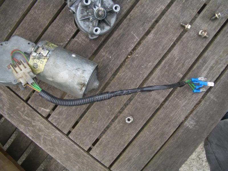

Plug connection on new motor, wiring taken from a MK3 golf in the scrap yard.
I was going to dismantle the new motor and swap them over but the new motor seems to be sealed unlike the old motor.

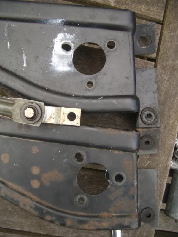

Tried to fit the new motor to the car as it was hitting the scuttle I noticed the holes was different on the assembly, old at the top, new at the bottom.
I had to drill some new holes so the motor would fit.

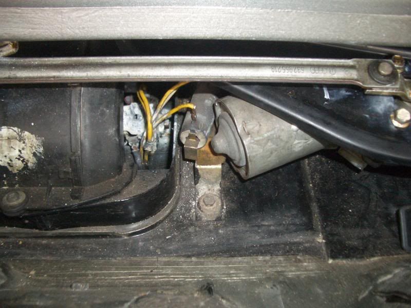

Finally fitted, I had to move the heater motor resistor over a little but when the covers on you dont notice. Now my wiper works even on a dry windscreen :dance:

I found there was plenty of Mk3 golf in the scrap yard, you have to find the wire just below the front windscreen (drivers side) behind a plastic cover, make sure it has 5 wires coming from the plug, I followed the wire as far as I could (about 15cm) then cut it off, striped the wires and put on 5 spade connectors and pluged it into my socket on the scirocco.
