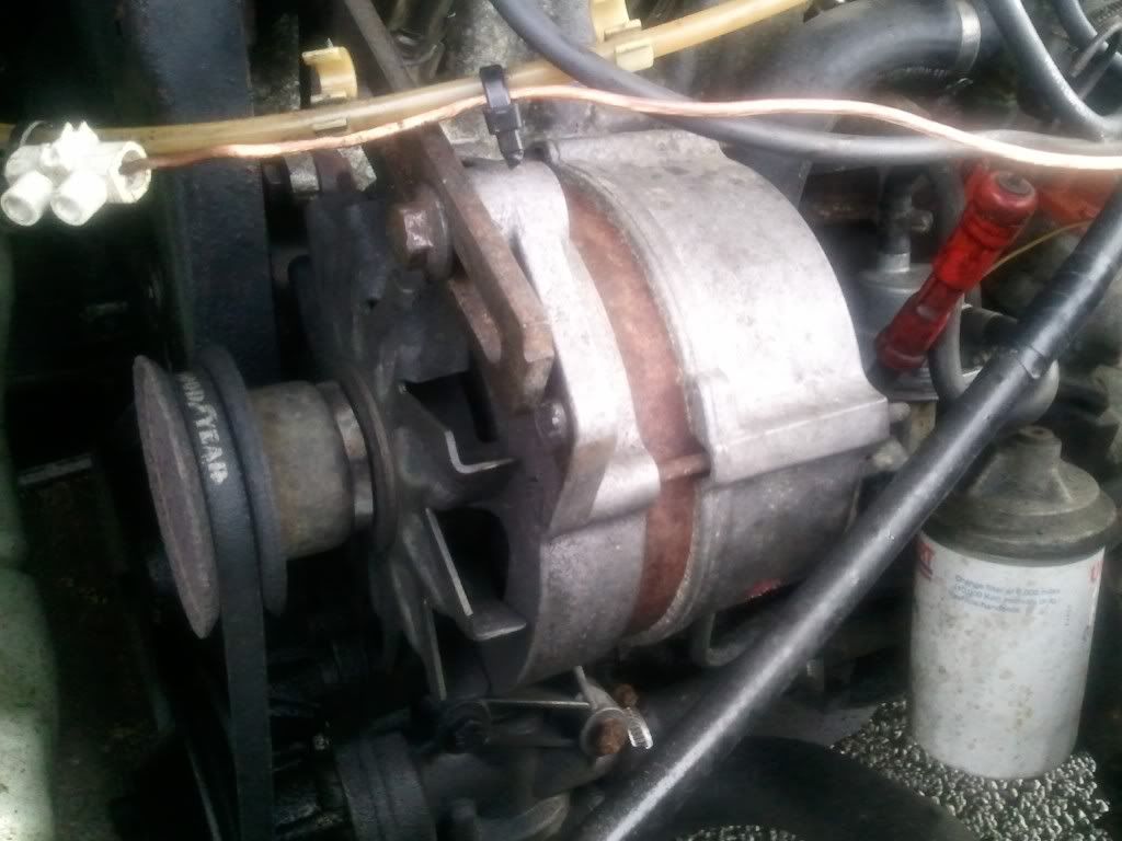

am getting the battery light flickering every now and then have replaced the battery so am guessing its the alternator on its way out, does anyone know if the alternator of a 1.6 gt will fit my 1.6 cl, the alternator on mine now has no sticker on it with a part number so am finding it really difficult to track down the right alternator.

fitted a 40a/hr battery was a direct replacement for the one that was already on it. these are a couple of pics of the alternator which is on the car now

In your last pic you will notice a black circular piece held on by two screws it is called a " ALTERNATOR VOLTAGE REGULATOR".
Remove this part and you will find two brushes, these tend to ware away through time.
If you have a spare alt swop them over or buy a new unit as they are about 12 squid on ebay.
Here is a link to show you what you are after showing you the brushes, but this is a dear one, you can get them cheaper.
http://www.ebay.co.uk/itm/BOSCH-alterna ... 564d546a53
Good luck.

Just checked an old brochure, you CL was originally fitted with a 45 amp alternator.
After seeing the pictures one thing I would be changing is that thing of an oil filter! A genuine VW filter costs less than £4 from the dealer and Synta Silver oil is £17 for 5 litres!

99% of alternator problems are the brush pack, which also contains the voltage regulator. They can be got for £12 HERE and take 5 minutes to fit :)
