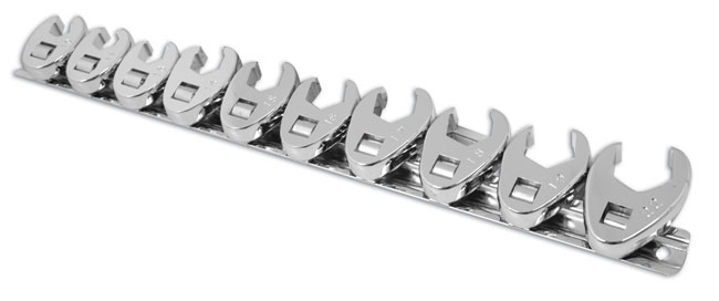

another tip. don't even think of using an open ended spanner on a brake pipe. i.e. one of these:
if they haven't been off for a while chances are they'll be nicely seized in there, and all you will do is round them off. get yourself either a set of flare nut spanners like this:
or some crow feet spanners like this:
and you'll pretty much guarantee to get them off. if they are stupid tight, nip them up slightly tighter then undo them. often helps to break the rust. soak everything in the release lube of your choice before you start, preferably the day before and several times. wd40 is better than nothing, plusgas is the dogs back wheels.

also, if you are replacing fuel lines with copper, check the price at your local plumbing merchant as well as the motor factors. sometimes (but not always) cheaper
