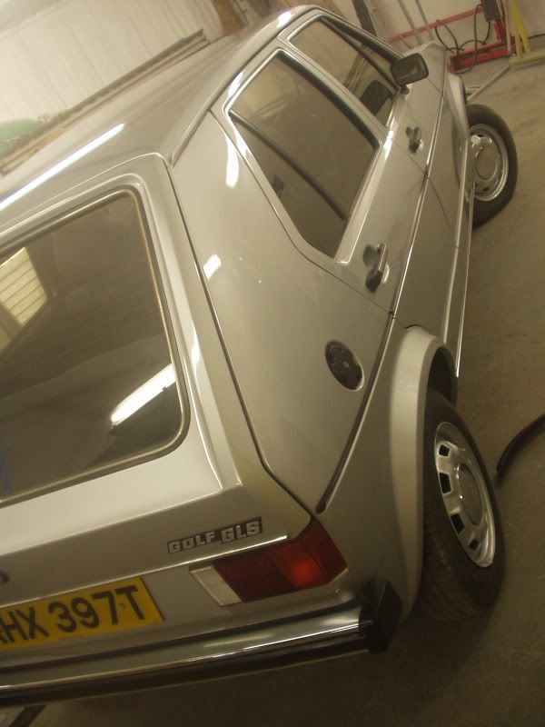

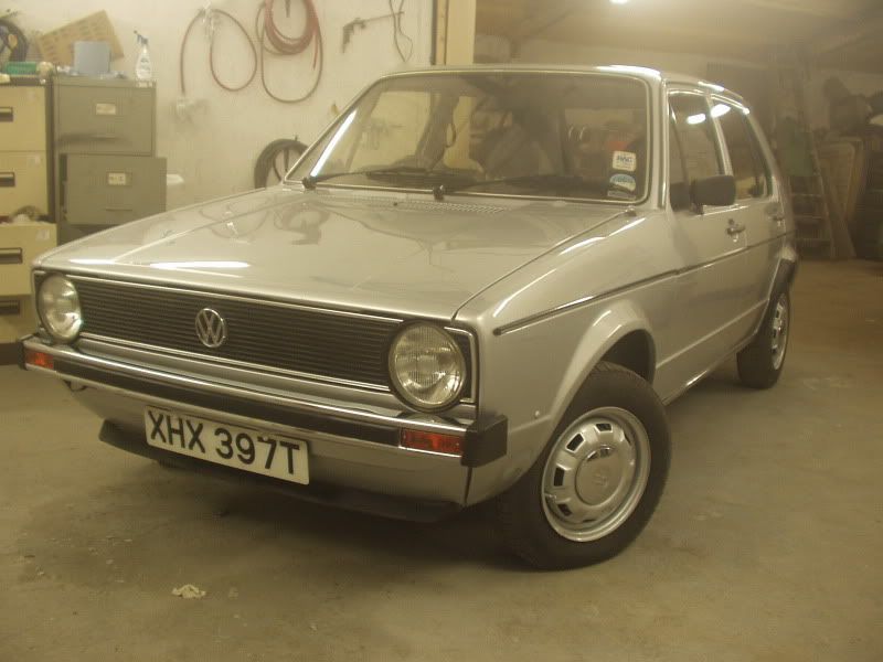

Yes. Just a few mechanicals to do, T&T then its up for sale. All done:GT Matt wrote:Is the golf finished?

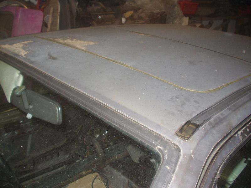

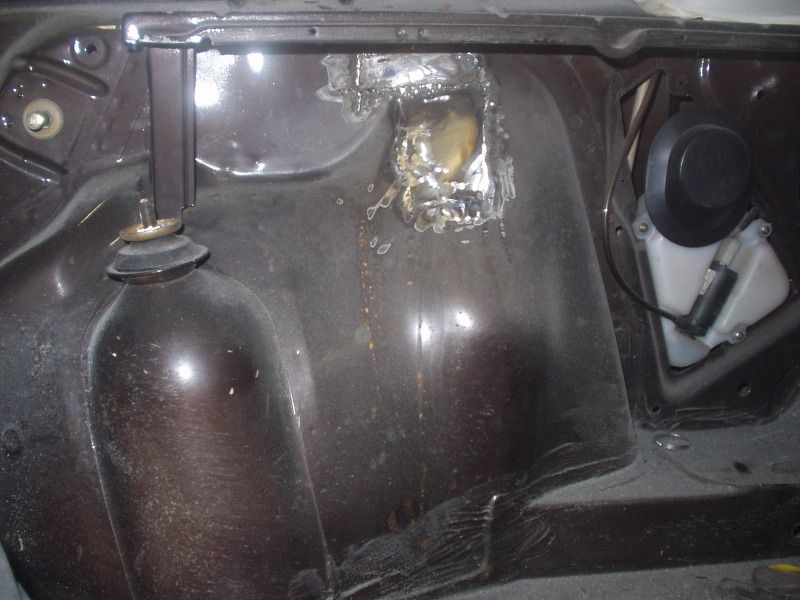

A quick update of Grotto activity this week - my Rover SD1 landed for a respray.
This also involved a little bit of welding (Mr Shavhead had already done an amazing job of the rear end) and then it was time to strip, prep and paint.
Some pictures:
Repair to the front lip of the scuttle panel, new section made, shaped and welded in.
A repair to the front edge of the inner wheel arch
And the rear edge of the same inner arch
Then rub down time!

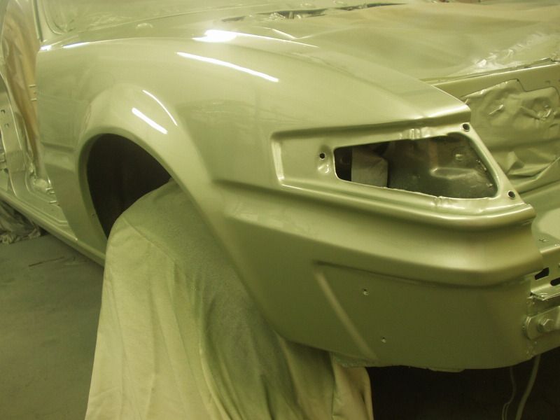

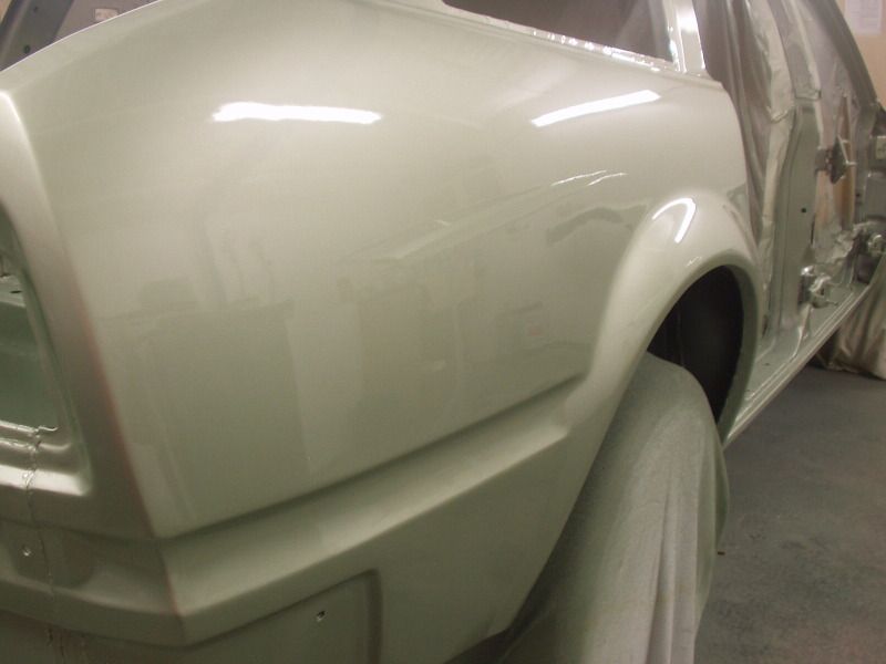

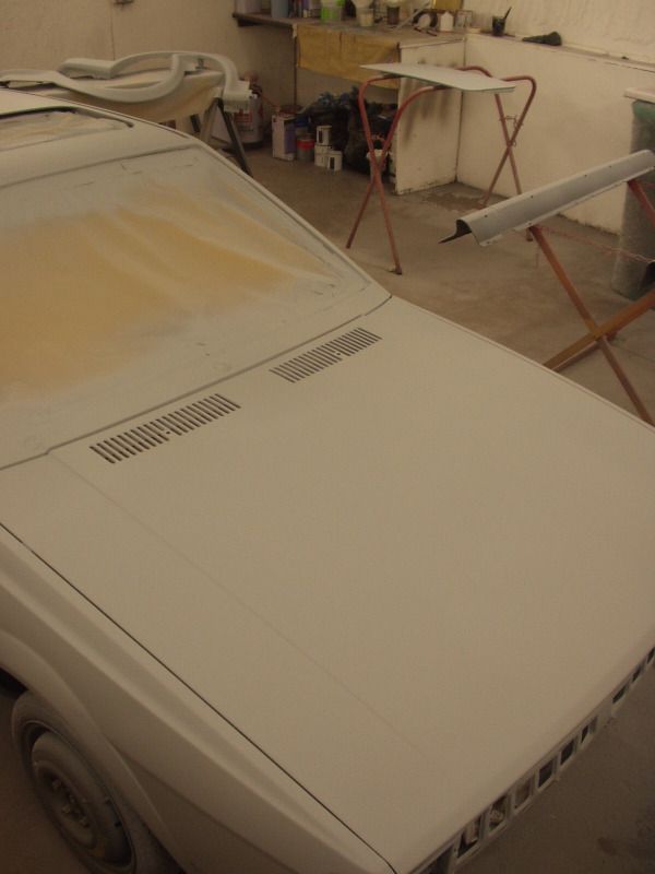

Once masked, etch coat went on first
Then the first coat of high build:
And here's where the front lip was repaired
A fantastic job being done by Ant - cheers dude, see you in the week!

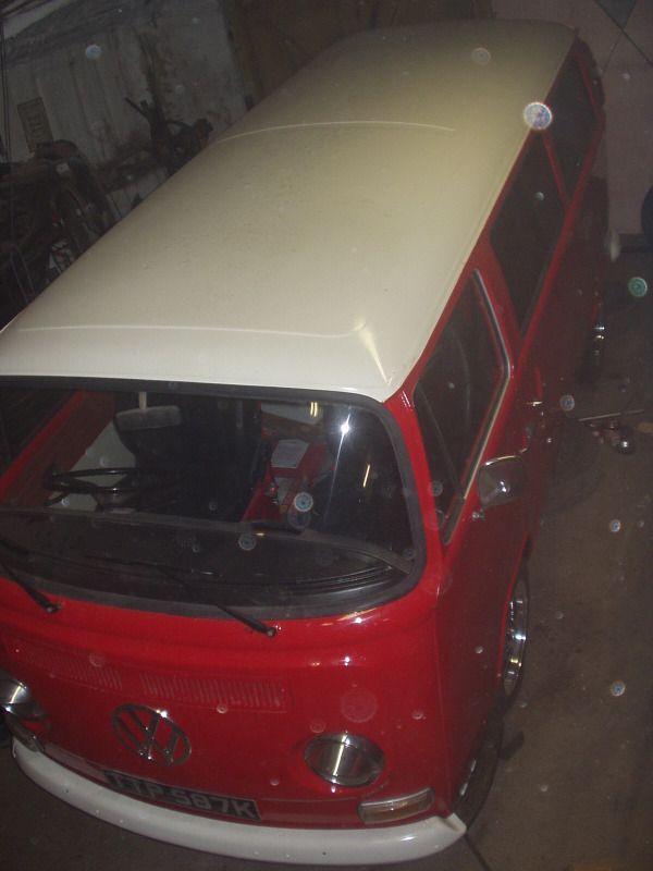

Some other non Scirocco stuff passing through the Grotto lately:
And this fella got to grips with the NSU
Nothing he couldn't handle.

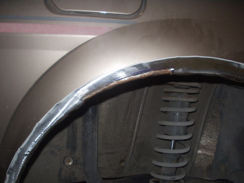

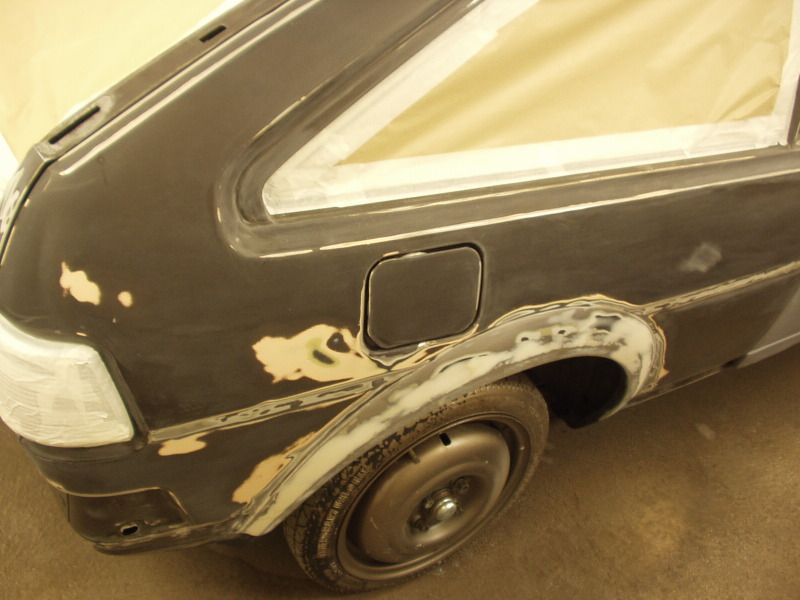

Ed's 1984 GTI arrived for a tidy up.

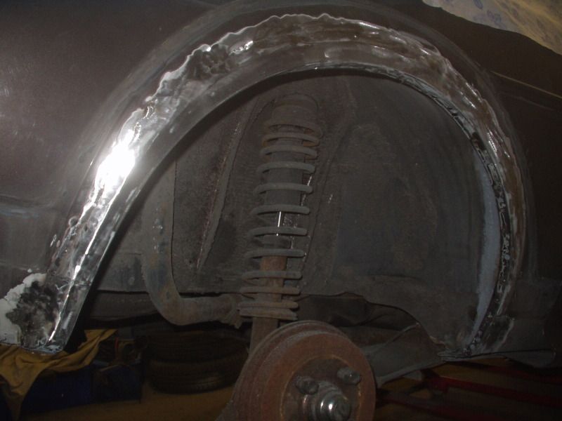

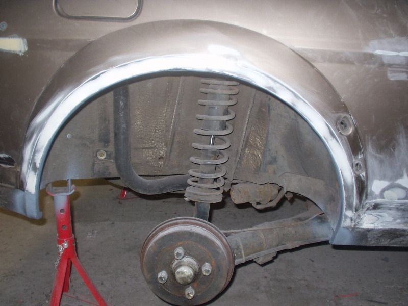

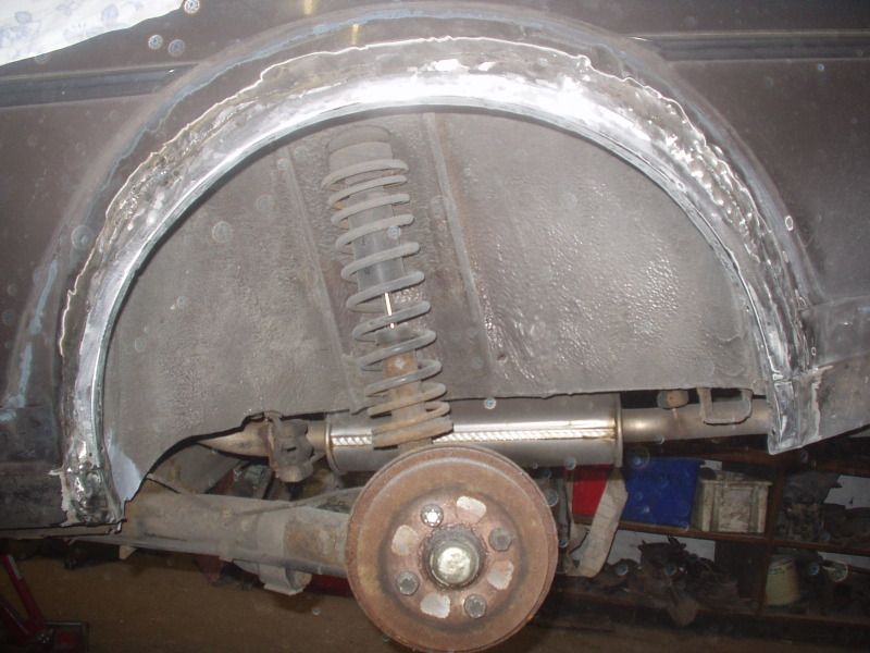

Rear arches needed work. Drivers side here.
Rebuilt the lip all the way around the arch.
The other arch required some minor work also. Spent some time taking shallow dents, stone chips and some scabs out. Bit of spot primer, then onto paint.

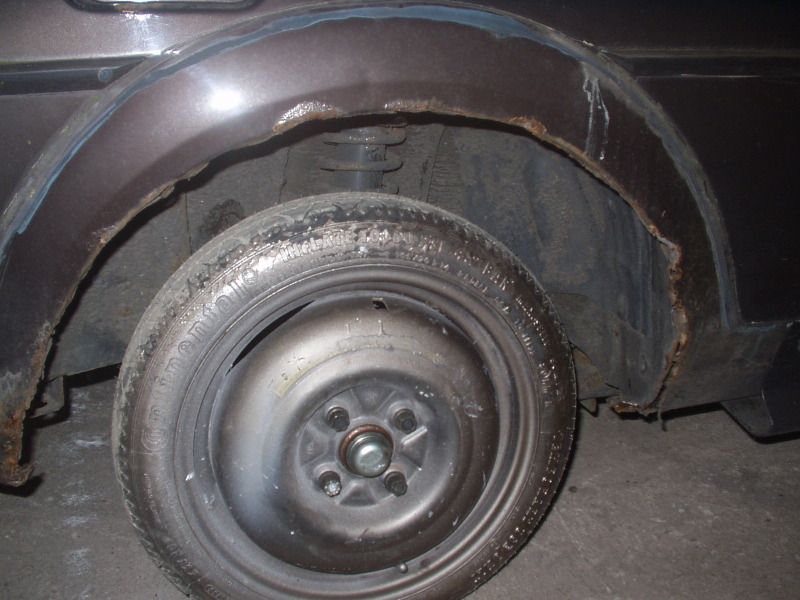

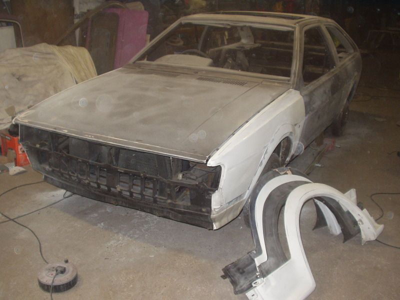

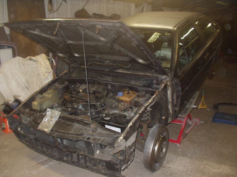

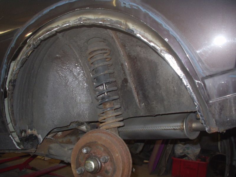

Next in is Dave V's Mk2 Storm.
Dive straight in. Bodykit removed to see what is what.

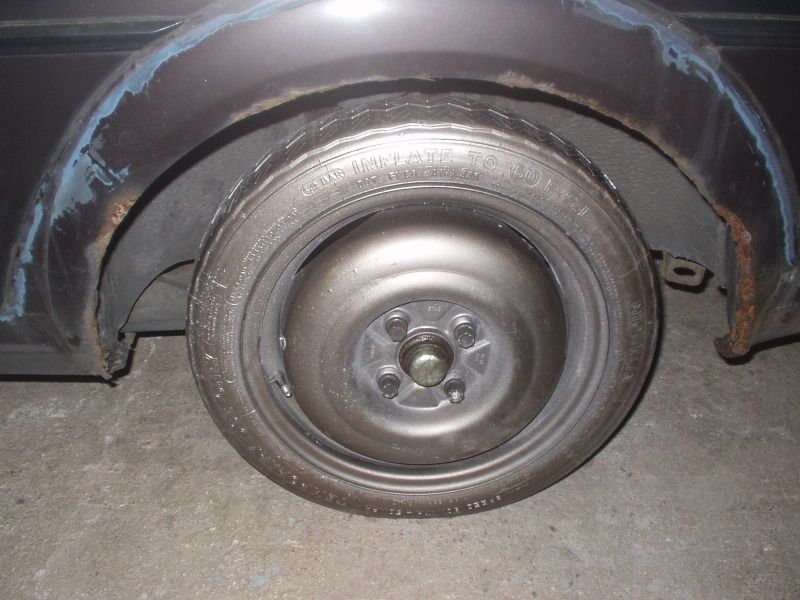

Rusty rear arches.
NS first.

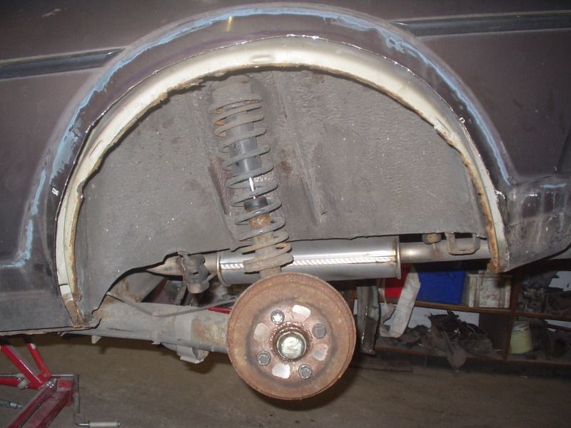

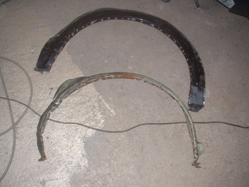

Outer arch cut away to reveal state of the inner wheel arch lip.

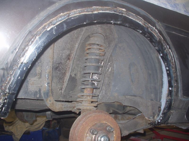

Rebuilt the inner wheel arch lip.
Then added the outer arch.
To achieve this I utilised genuine MarkH repair panels.
A top bloke
OS now.

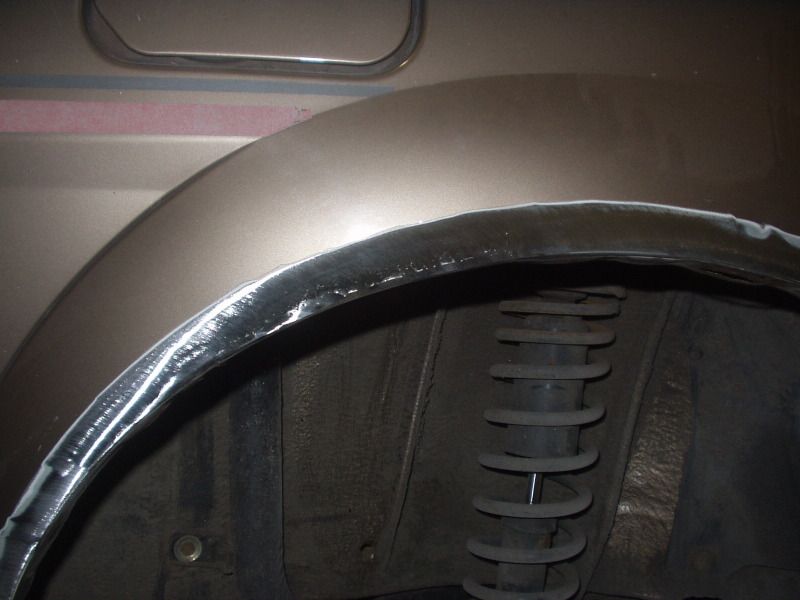

Inner welded in and painted with weld through etch primer, then outer added.
Welding dressed.
Complete paint job on the way, mega lacquer peel here!
Rusty rear arches.
NS first.
A top bloke
OS now.
Welding dressed.

VW do not seem to continue to press the repair panels for the rear arches to my knowledge, only the complete rear quarter, so your closest thing to brand new is from Joost. See here: http://www.sciroccoregisterforum.co.uk/ ... =30&t=6038
Alternative is to use a good arch cut off a wrecked car (as in the Mk2 Storm above), or to make your own using sheet steel (see the 1984 GTI above), I did this to construct the whole lip in sections on one side of the 84, as the repairs were pretty much confined only to the lip only.
Inner lips can be made from adapting Golf mk1 repair sections or fabricate from sheet steel.

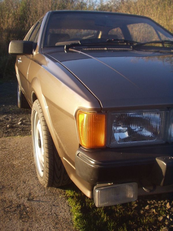

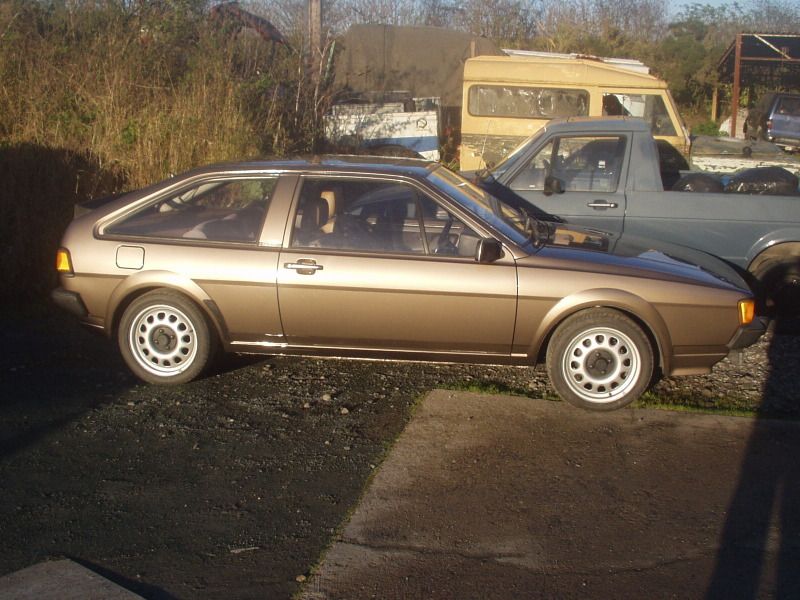

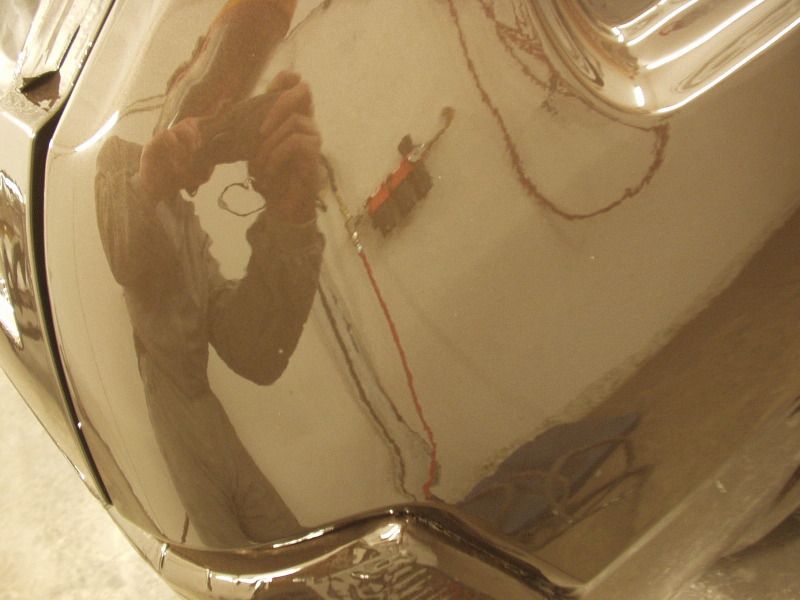

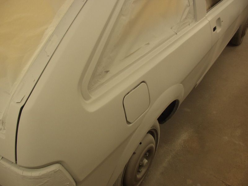

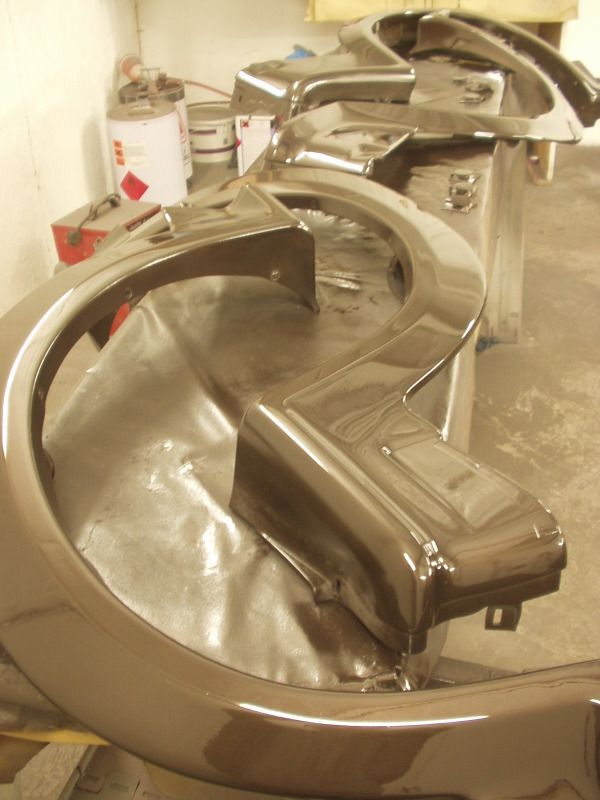

Onward with Dave's Storm.
The usual A1 platfrom cars grot spot got degrotted.
Just about ready for some paint.
Those new arches had a light skim of plod to even out any distortion.

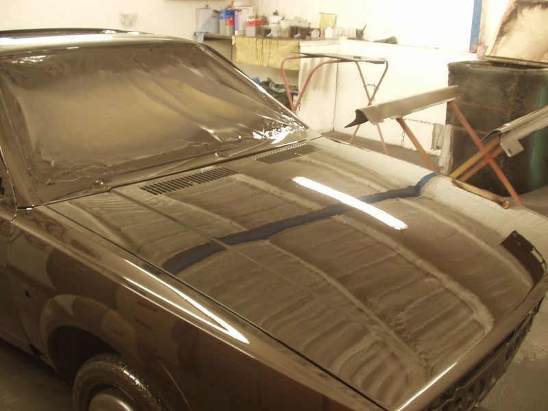

Applied a coat of etch to the repairs/bare metal then onto Primer.
Colour. LK8Y Havanna Brown. Yummy.

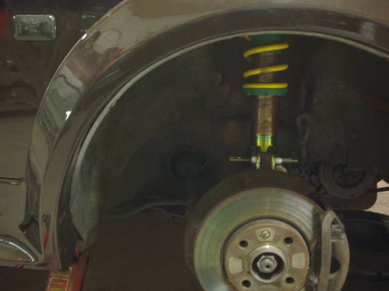

Then Dave told me hit it with the lowering stick.
Fitted up. The bumpers were revived using a heatgun followed by some bumper snot.
LOVE the choice of wheels and the subtle colour chosen to match the car, very tasty.
