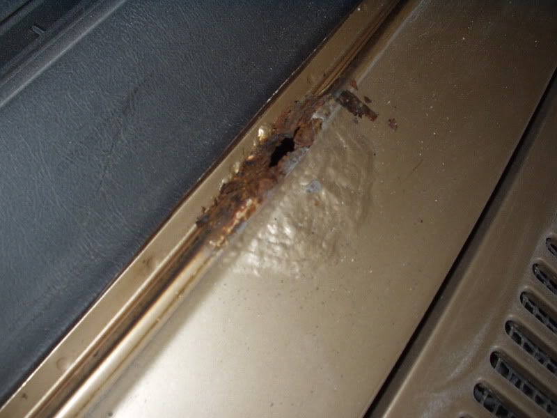

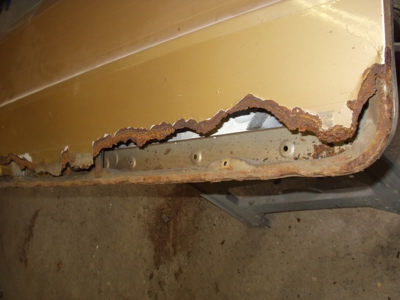

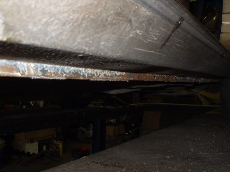

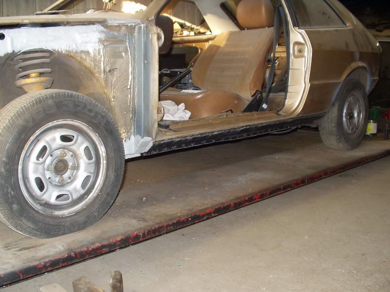

Bloody rust.
Bloody gone.

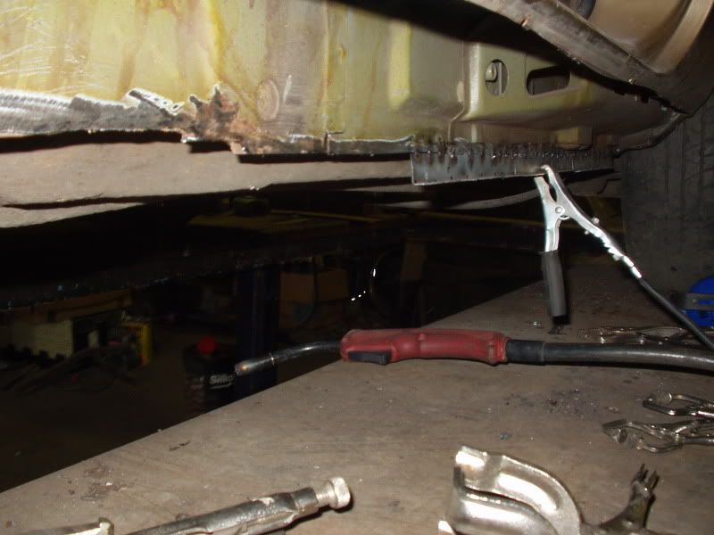

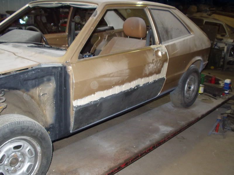

Also dressed back the welds on the drivers door and started to smooth with a bit of plod.

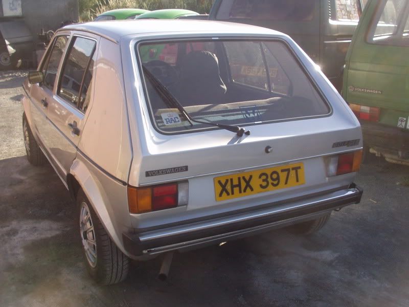

And I've had a change of daily driver, panels are easy to get hold of for this, as such I have no qualms about using it in the Winter (unlike a Mk1 Scirocco!)
A 1500cc 1978 series 1 Golf GLS, one owner from new and genuine mileage.
Its just about run in, interior is like new.
Bit of bodywork to do on the rear arches at some point, but its just flown through the MOT with no advisories.

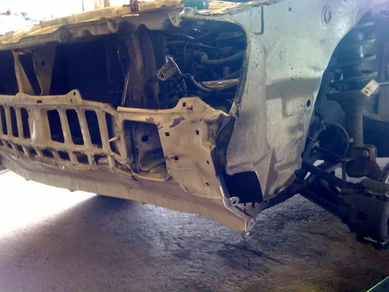

Her indoors ran over a large hound. Him in the workshop prefers cats.
Canine carnage.
Time to fix the damage caused by too much Winalot Chum (other doggie foods are available).

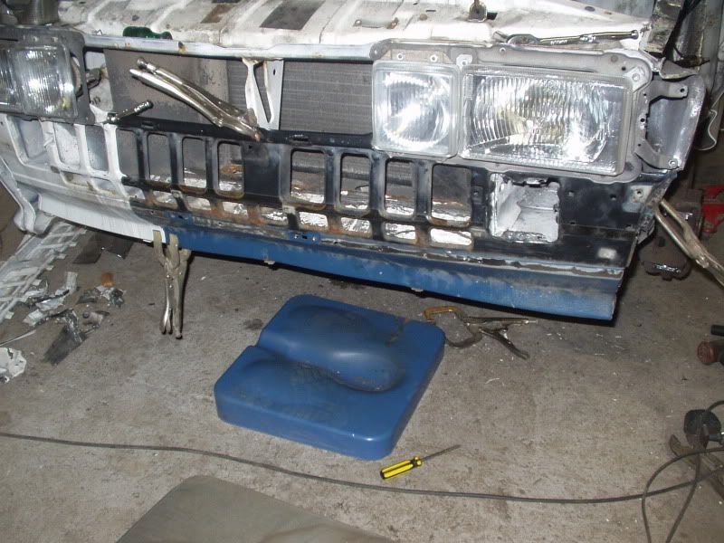

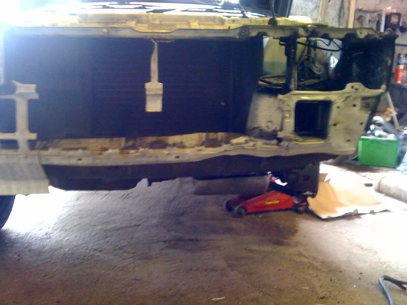

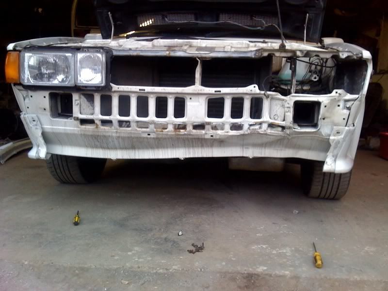

Bent wing off. Woof.

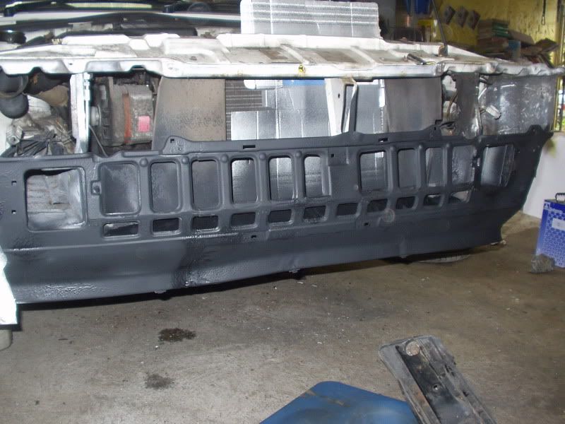

Started to chop away the mangled front valence.
Straightened the flat panel behind the valance and offered up a new front valence from stock (phew!)
I have no idea what that blue thing is, truth is I don't want to know as i know where it came from. Saves my knees though.
Once happy with fit the panel was welded then stone chipped and painted matt black.
Replacement wing and bumper painted.
And Piglet is back on the road

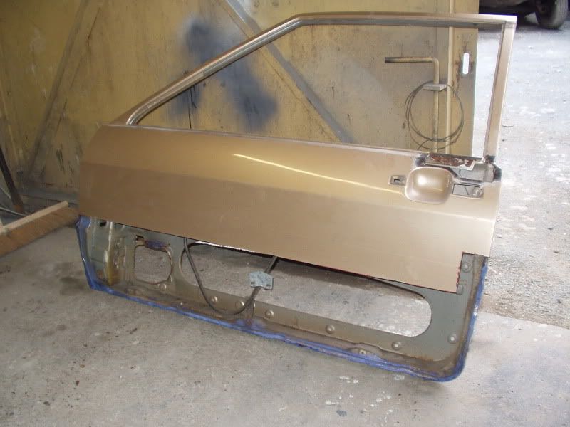

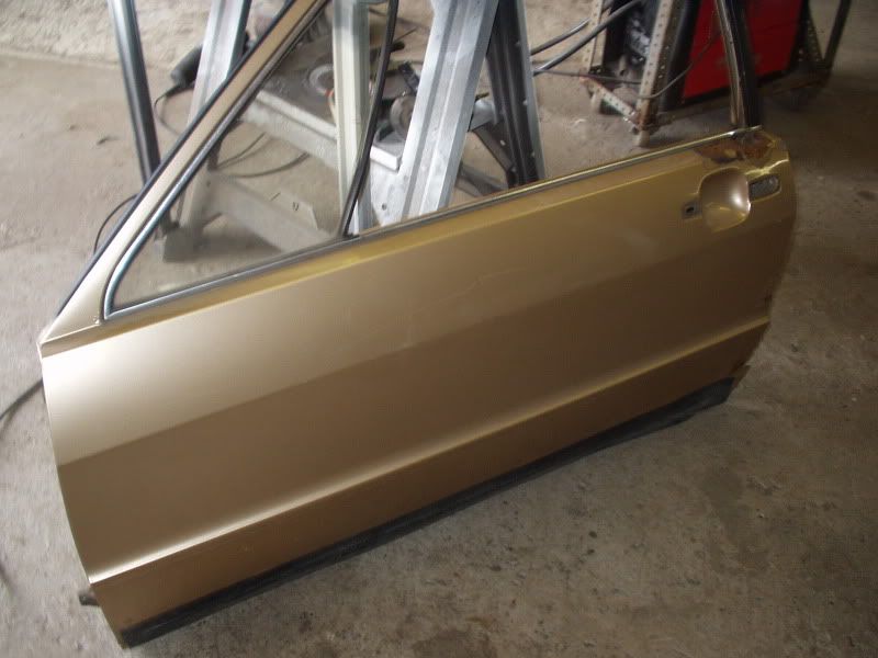

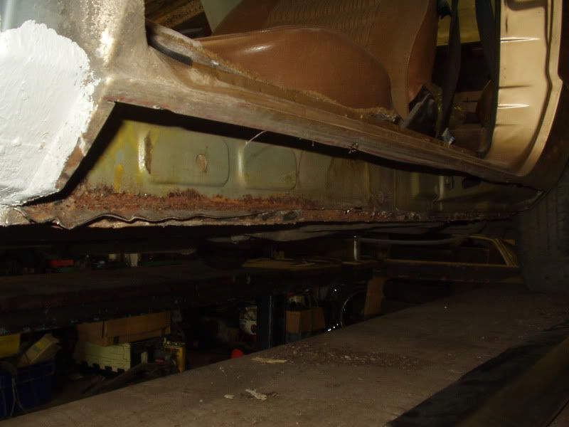

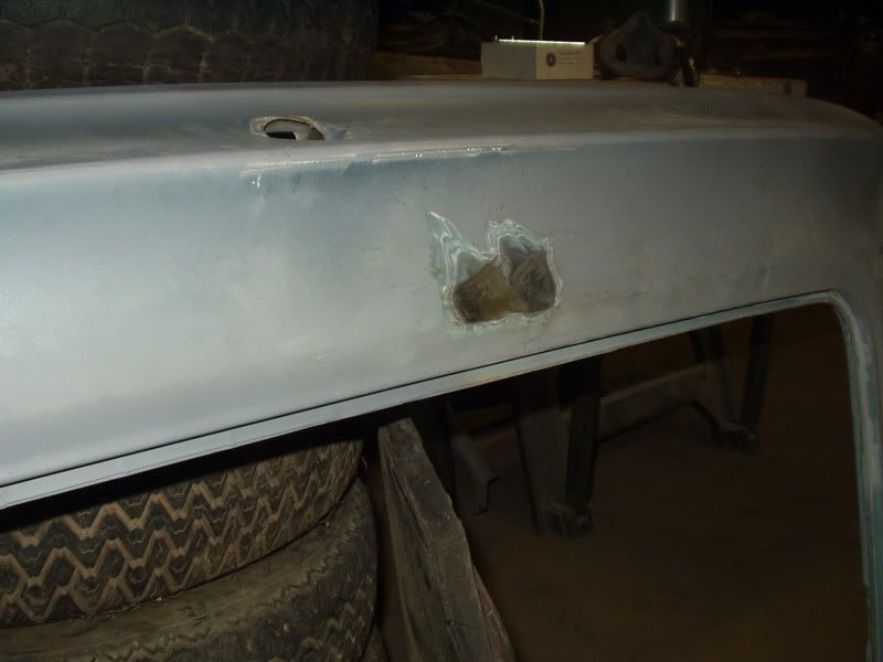

Was really surprised with this one. The bottom of the door skin was non-existent yet the frame was in really good condition, just a bit of surface rust!
Sit you aside and let the anti-rust agent dry.
Meanwhile, collect a car that I have always wanted and begin to plan project....

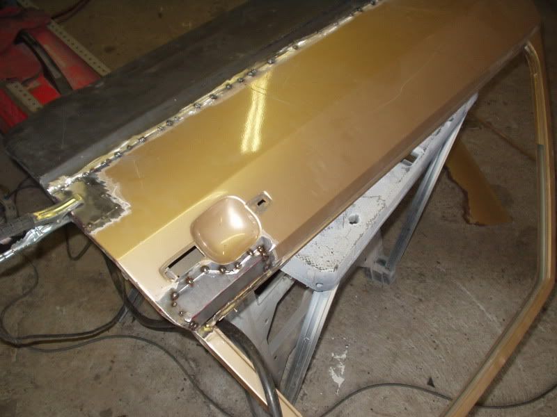

Lets get back to that door and get some fresh steel in there. Spotted in here, then completely welded.
Fits really well
Fits really well

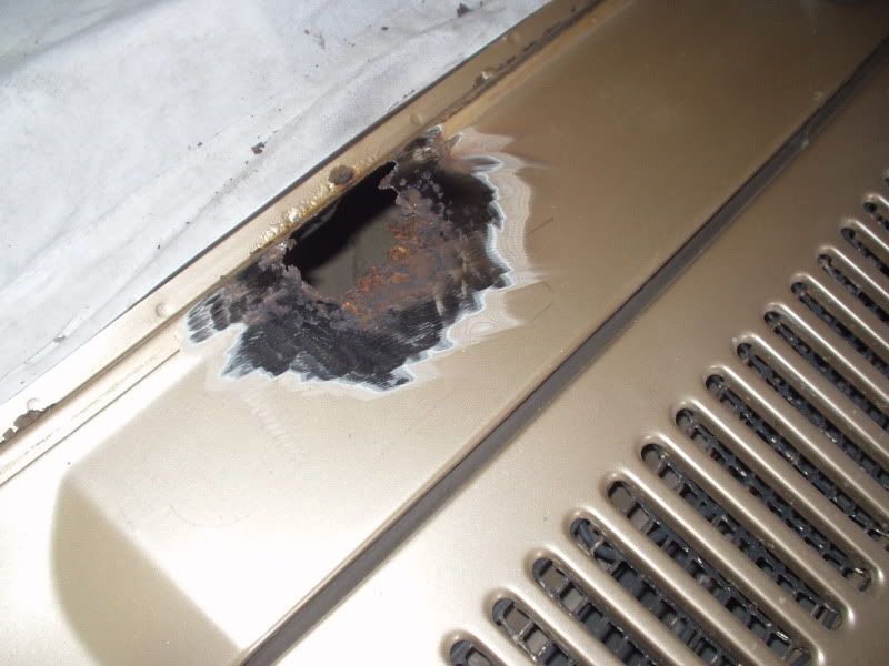

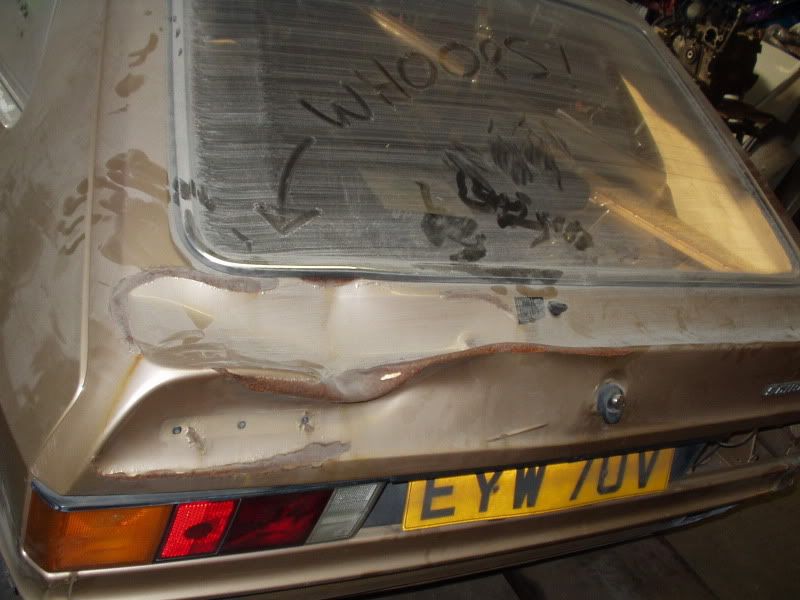

Comedy hatch.
A lightning strike caused a tree to fall on the hatch. Rest of the car is fine and the glass was saved by the smallest margin!
Luckily, another hatch is here to save the day. With a cheeky twist.
Keep finding more stuff to do...

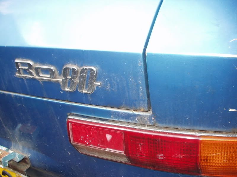

I hope this still has the Wankel in-situ!The Autoad wrote: Meanwhile, collect a car that I have always wanted and begin to plan project....![]()

The Wankel was supplied with the car but wasn't in situ. Now on a bench in the workshop for study. It may need a complete rebuild or an exchange engine. I have a lot of learning to do.
- Posts: 2928
- Location: BEDFORD
Re: 1980 GLS
Good to hear! I'm not sure I see the point of a Ro-80 without the rotary engine.

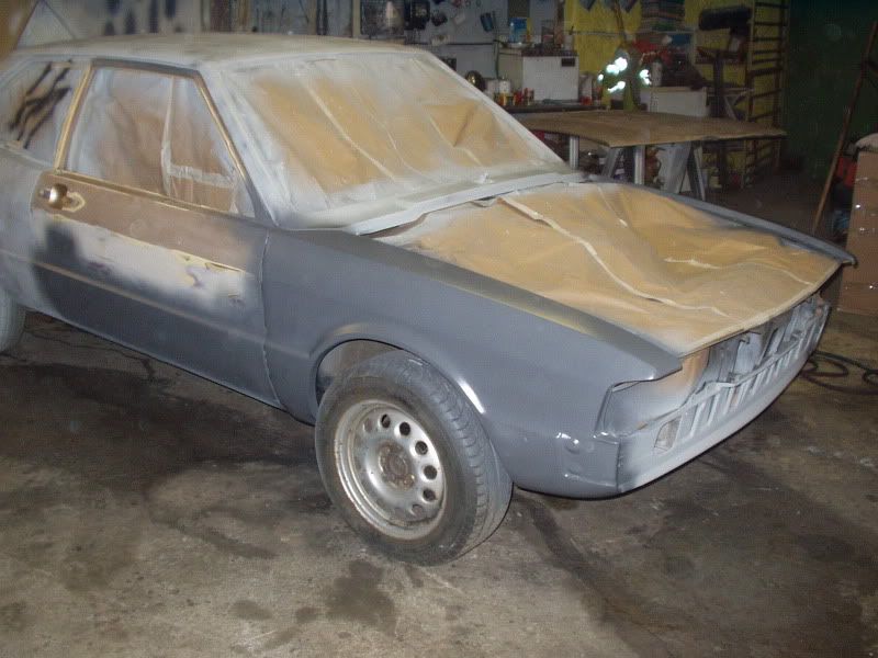

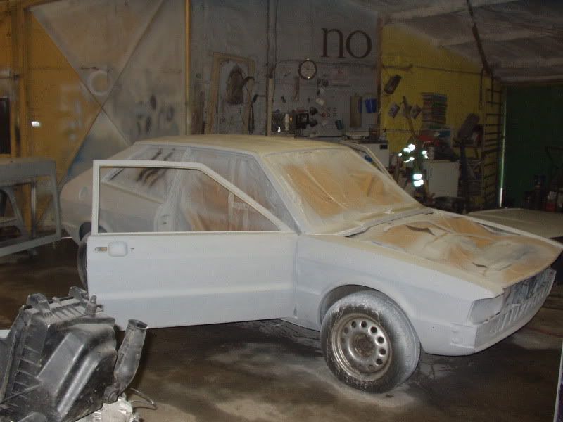

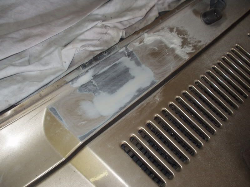

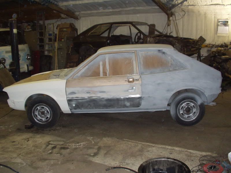

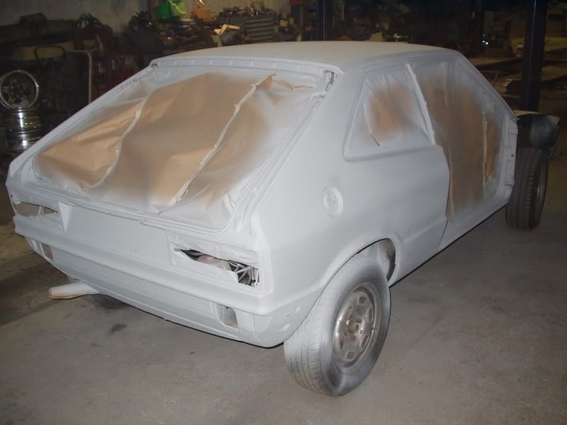

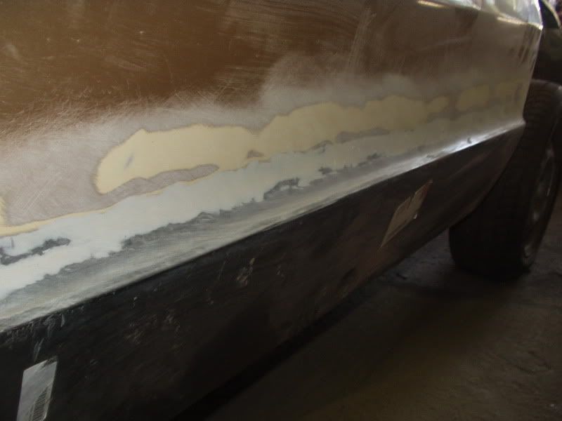

Lots of boring sanding. Then some action, some primer. And some more sanding to check panel straigtness.

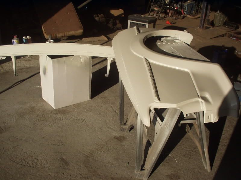

Get the doors and wings on. Fibreglass wings, a nice fit.
Etch primer on the wings and the bare metal on the doors.
Get the thing uniform and happy with a wet sand.
