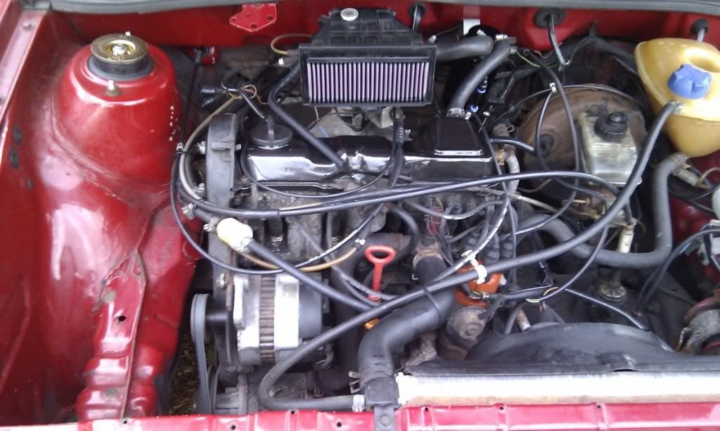

Thanks, yes carb freezing can be a real issue without decent hot air coming back off the manifold. I've also got a heater to fit to my Weber which I think helps quite a bit. I'll get pics up when the carb goes on.

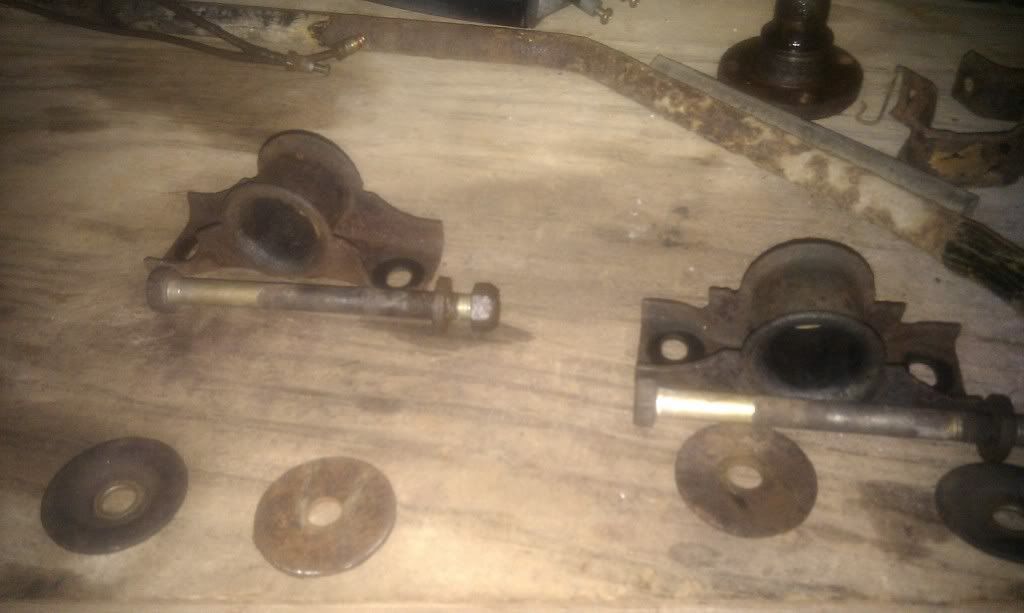

Car now has full new suspension/wishbones/ mainly Febi Bilstien bushes at the front struts all de rusted/Rustoleum paint for boge inserts and GSF 40mm lowering springs see this thread..
http://sciroccoregisterforum.co.uk/carf ... 10&t=10097

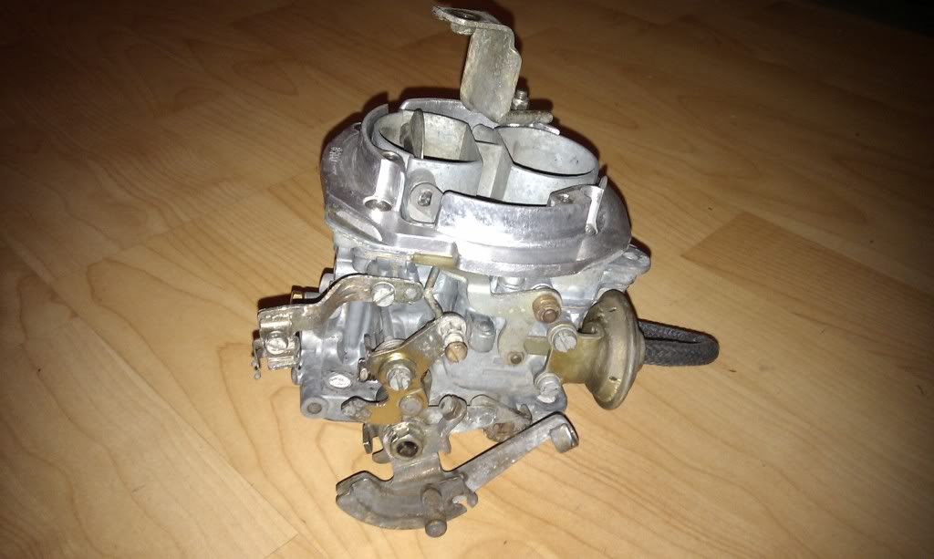

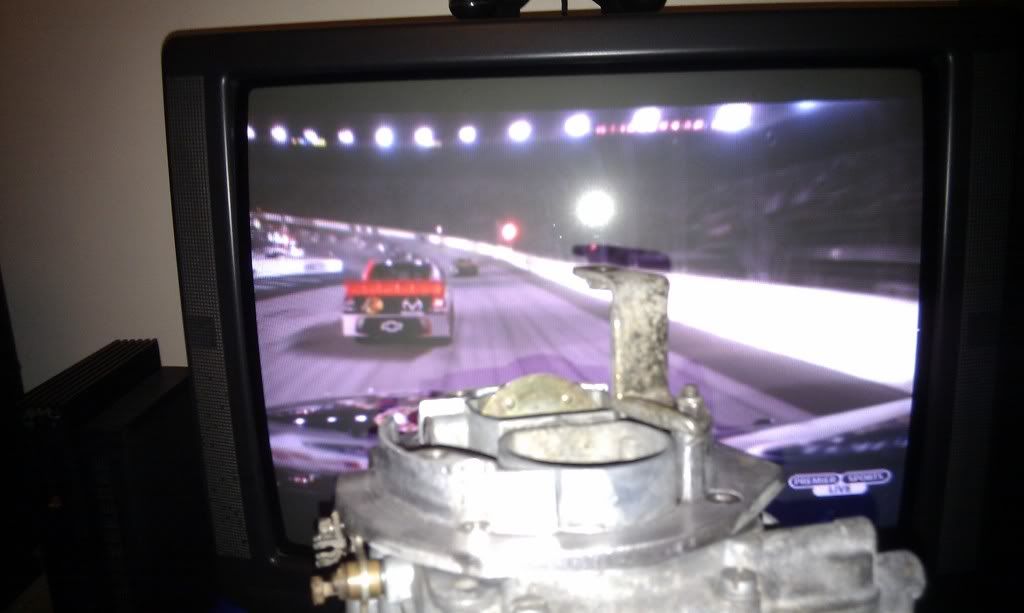

Carb was rebuilt during a late night Nascar race..

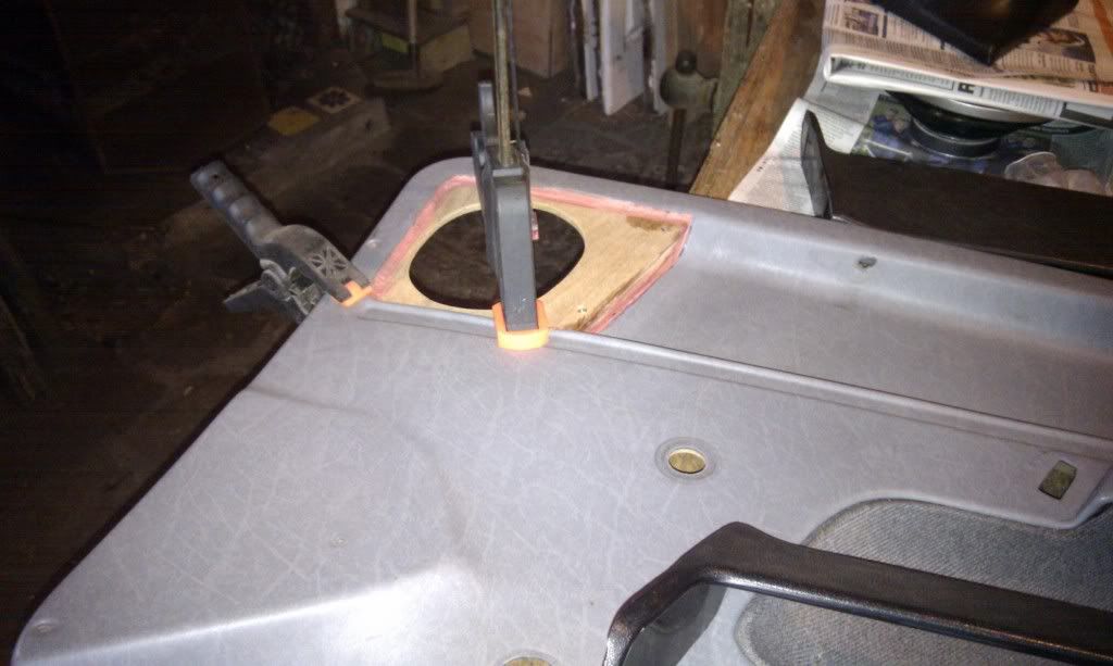

The door pod builds have been a real challenge, resorted to more woodwork and Pink Grip adhesive which is commonly used by your average tradesman.. :bye:
Screwed and bonded on without speaker grills quite pleased but they touch the lower shelf on the passenger side and a bit close on the other :dash:

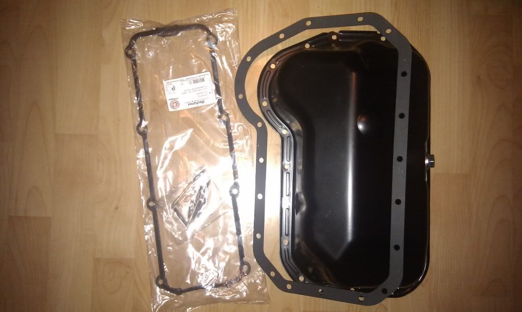

Next on the agenda oil pickup cleaning and new sump fitting, rocker cover cleaning and painting with rubber gasket and hopefully Weber carb.
Got this stuff just over £30 from Veedubmachine.. rocker gasket has correct studs in the bag..

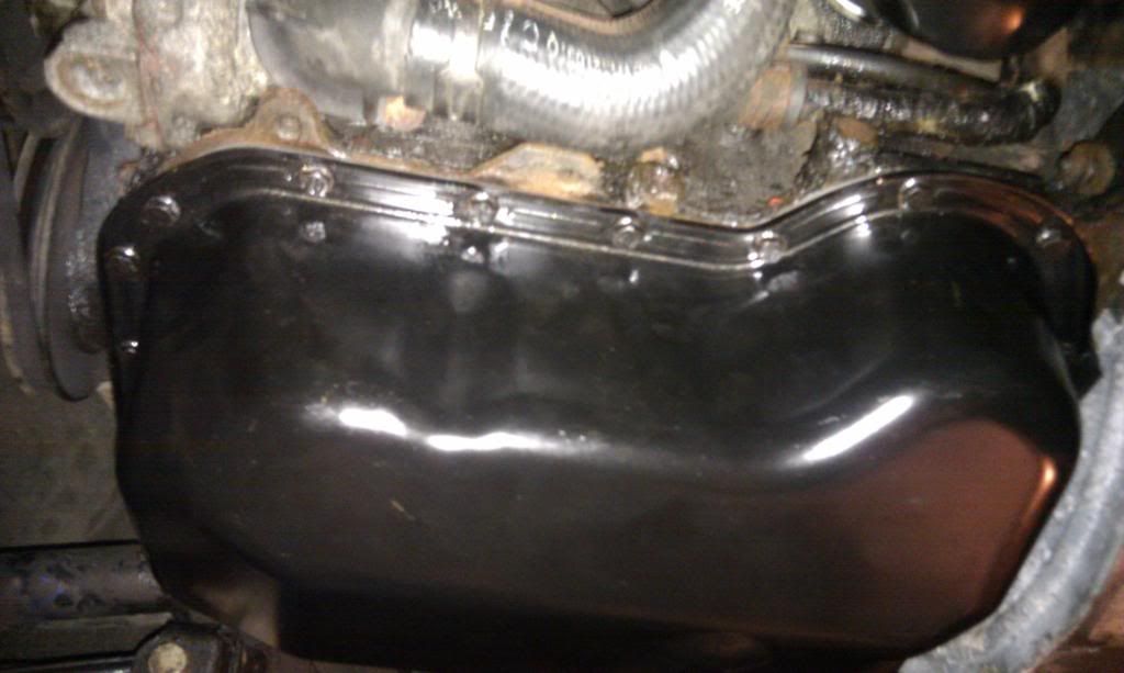

The Sump was dropped to check the oil pick-up. There were just a few specs of dirt in the gauze so was cleaned up with white spirit (no pics covered on many other threads) and new sump from Veedubmachine was fitted really just the ease of being able to fit a nice clean part. By no means as good a fit as OEM but seems fine..

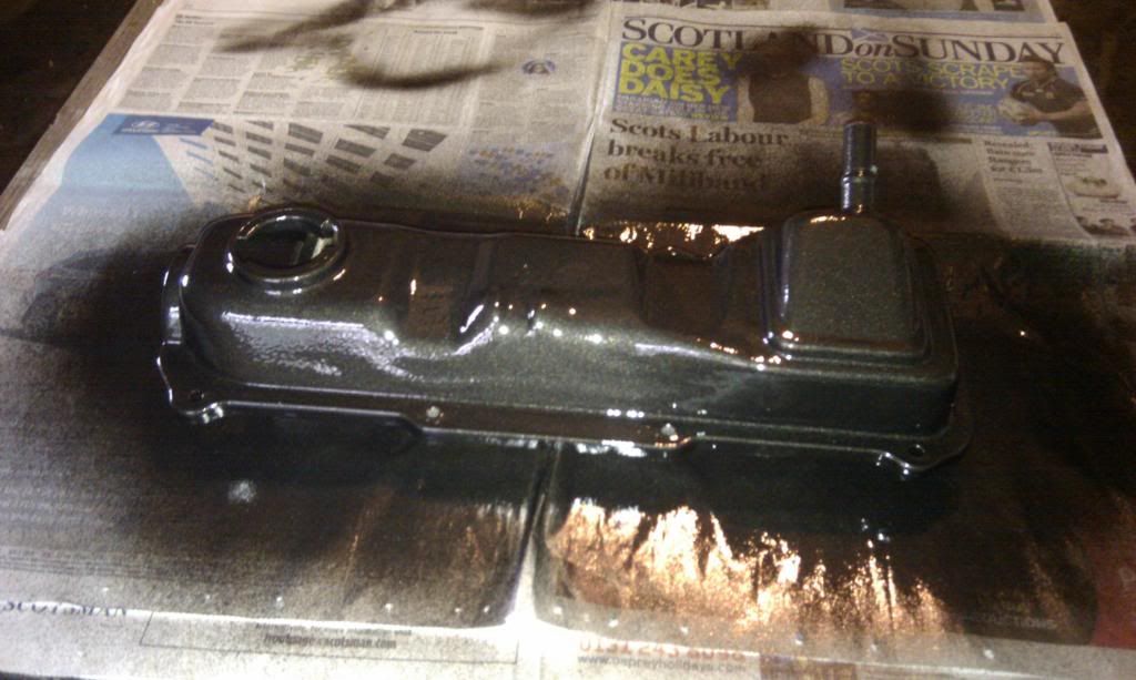

Cam cover was painted again after a previous petrol leak stripping the last paint :dash: rubber gasket and shoulder-less studs fitted..

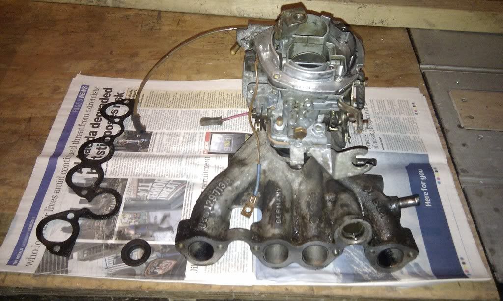

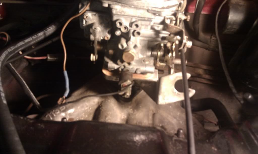

Weber Carb was fitted which as ever had a few teething problems (still don't know if it was dirt in the carb, air leak or something like HT leads which were replaced)

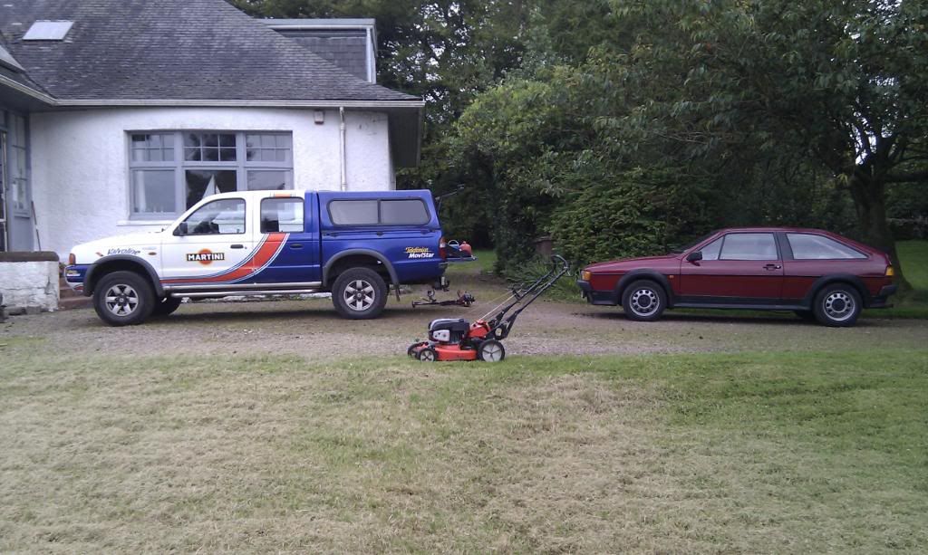

Borrowed the use of a friends Rolls Royce of Mowers and felt suitably lower than his vehicle..

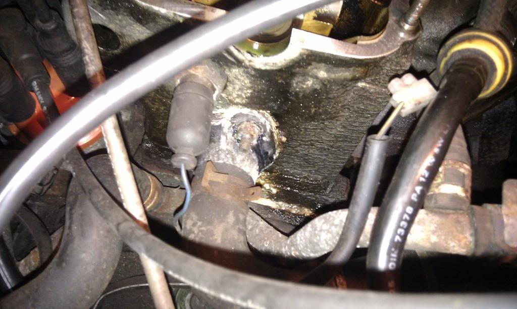

Coolant leak from underside of inlet manifold where I believe there is probably a perished O-ring and water flange has been leaking..

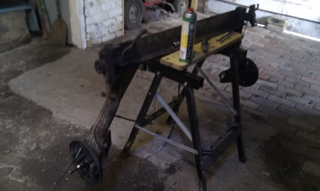

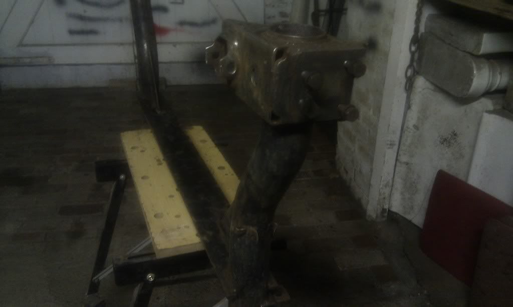

Anyway when I'm off Uni for Christmas I'll be fitting a reburbished rear beam which will involve tank and filler neck removal and general overhauling to prevent further rust.
Spare rear beam
Almost ready for a few coats of black Rustoleum..

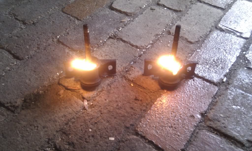

Poly sport rear beam bushes from Rally Design.. more bushes to come from VW heritage for ARB.

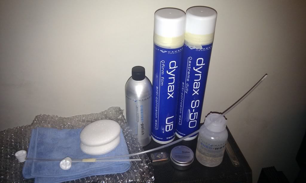

Whilst off the road will deal with rust and preventing rust with these products..
UB is a high quality underseal with waxoil type protection
S-50 is like waxoil but again meant to be way better.
Also shampoo with no waxes, Polish and Auto balm which again has rust preventing qualities, gets into the pores of chips/scratches etc :good:

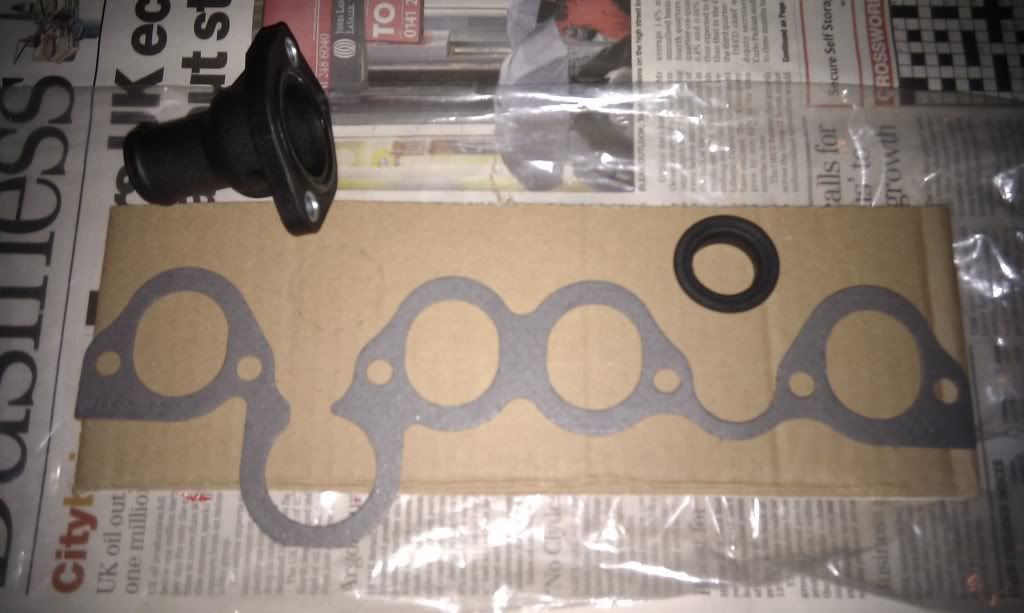

Fit new inlet manifold gasket and O ring
Fit new water flange and O ring
Possibly check and replace thermostat and housing whilst I'm at it

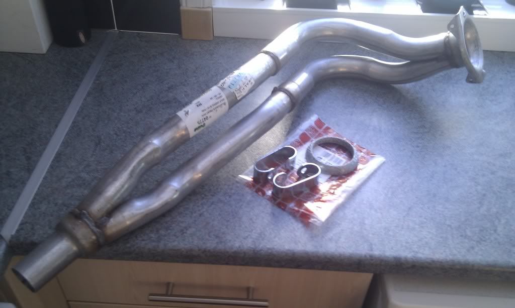

Fit new downpipe with new C-clips and gasket ring

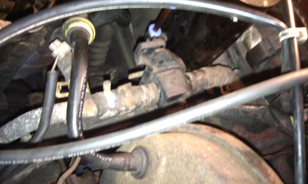

Examine possible bad brake pipes and replace if needs be.
Sort a fuel line that has possibly damaged the steering gaiter.

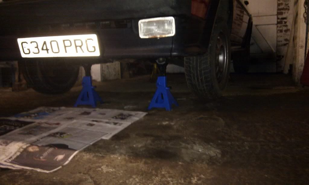

So after a tiring week of Uni last week all I have managed to do is power wash the underside of the car the best I can and get it up to a reasonable height to work on..

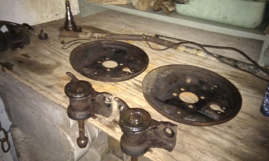

Some parts..

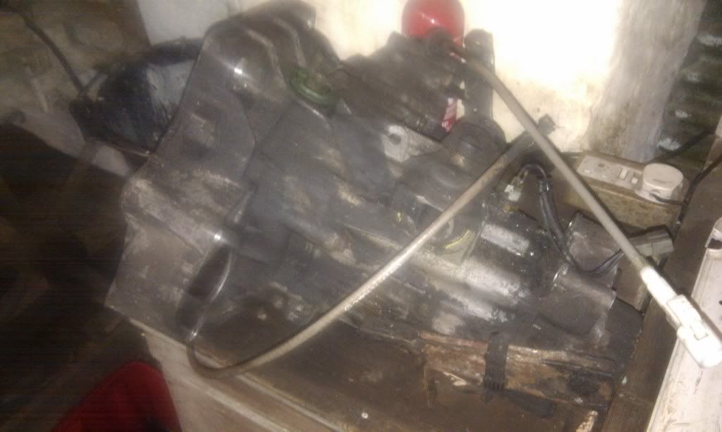

Spare box that has different reverse light connector and possible different driveshaft size (I do have other driveshafts)

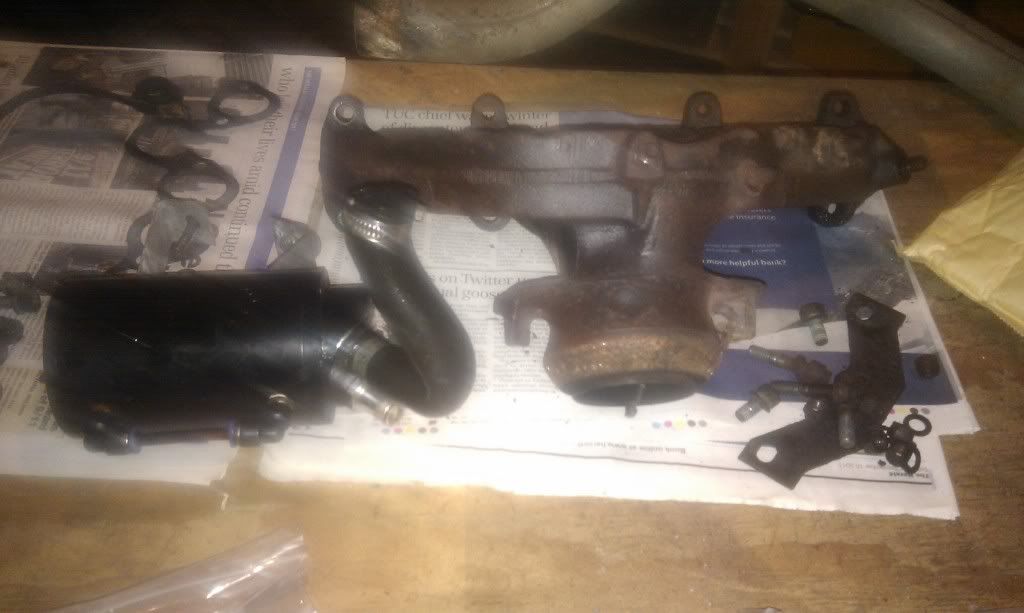

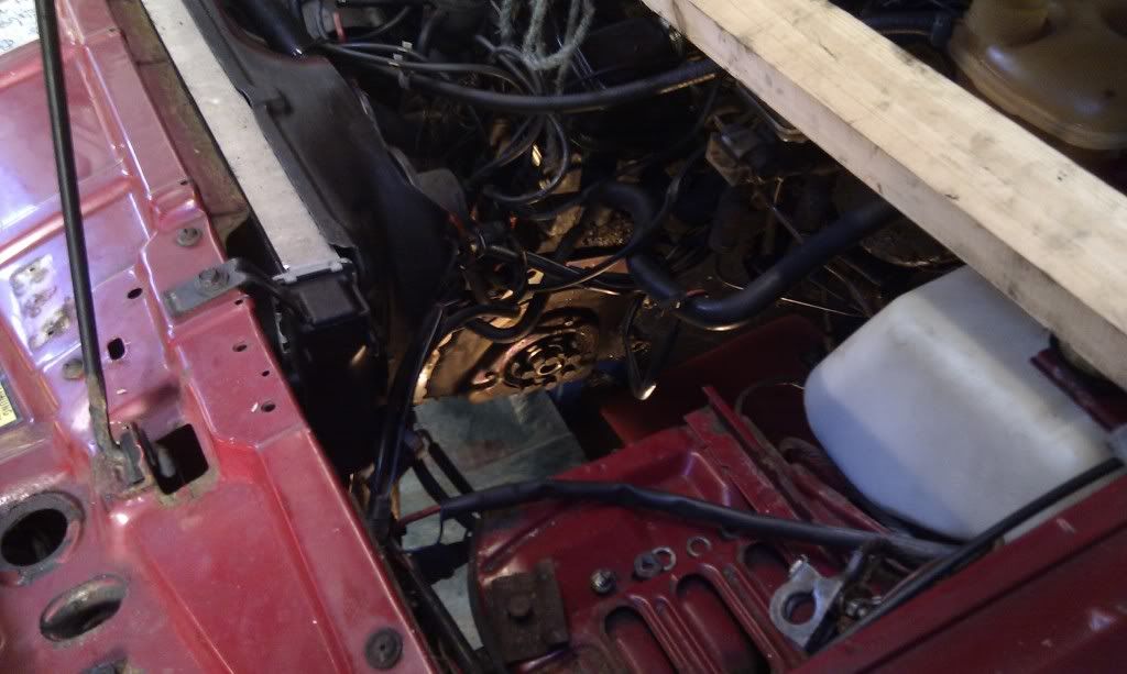

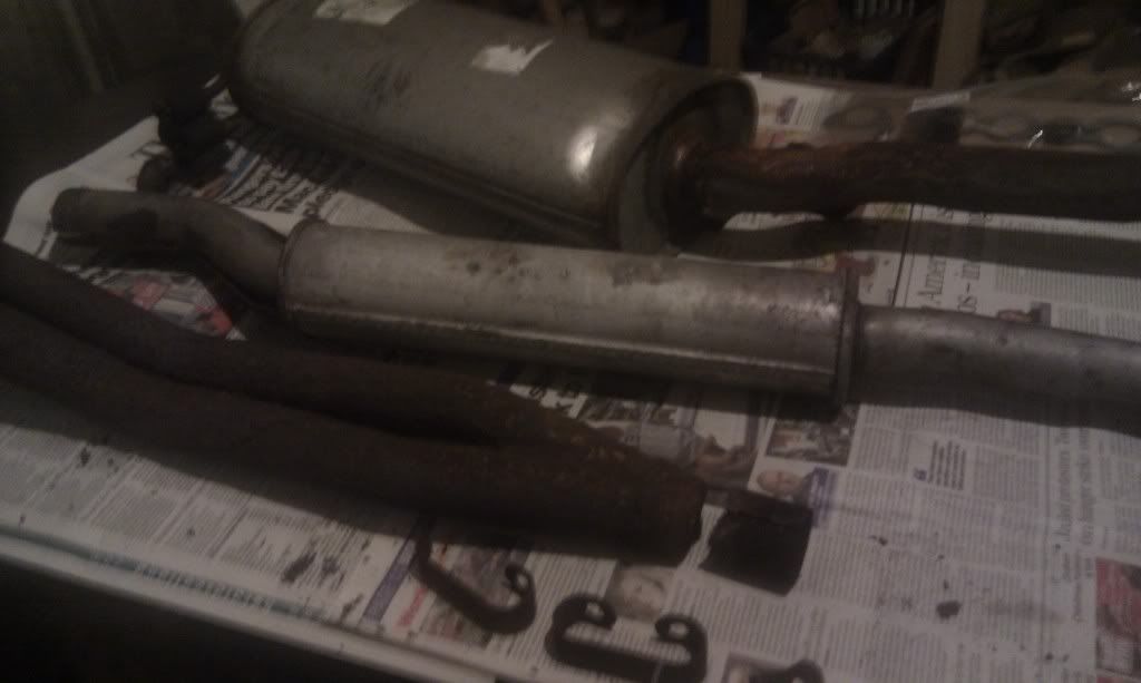

I got the whole exhaust off..
With the new down pipe I'll be good to go with the rest of the system..

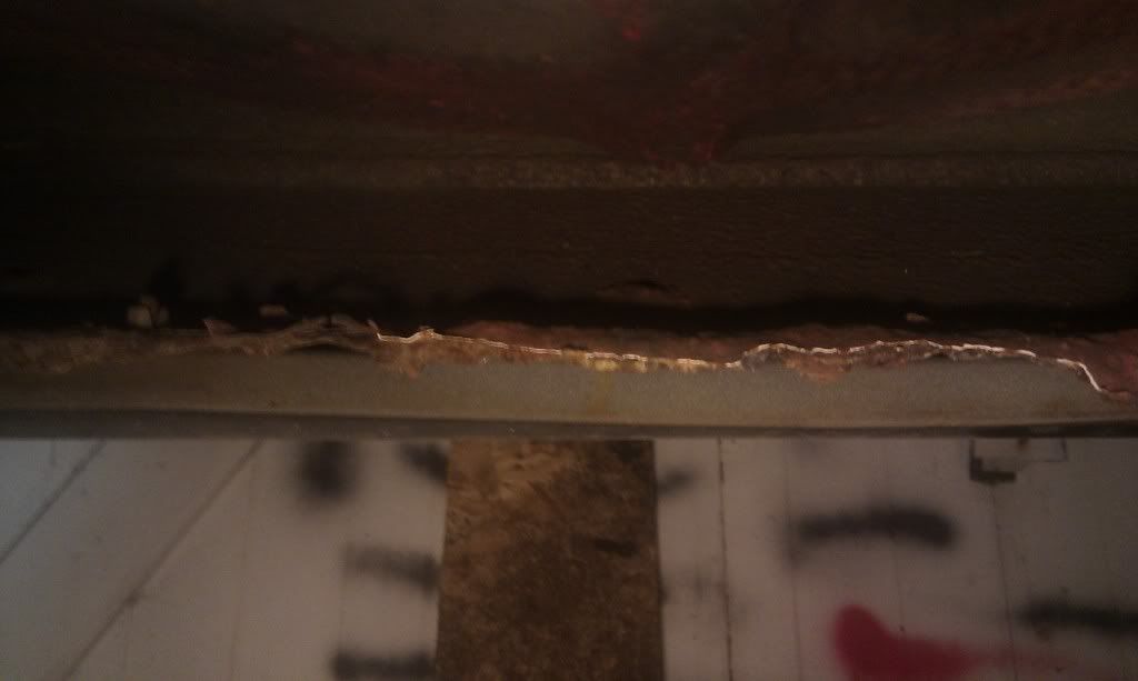

I knew the rear valance under the kit was like this..
but didn't realise how bad under the exhaust :crying: It's the heat from the exhaust with all the rain and salt causing this..
I actually think in the short term I can take the rear plastic valance off and make a neat cut and protect it until I can make a better repair later in the year unless it's really bad :scratch:

Thanks for the advice :good: I know I can buy the seals, they are 90mm shafts. The box is off the car and is so dirty it's hard to tell if I need to replace them.

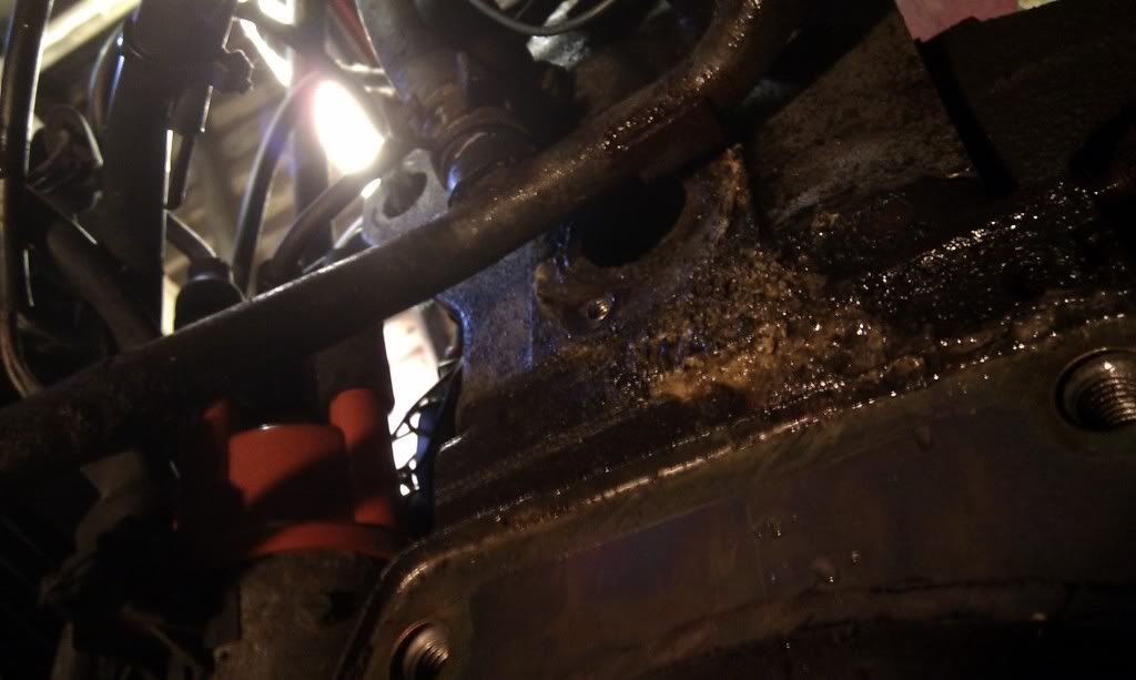

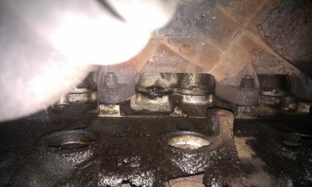

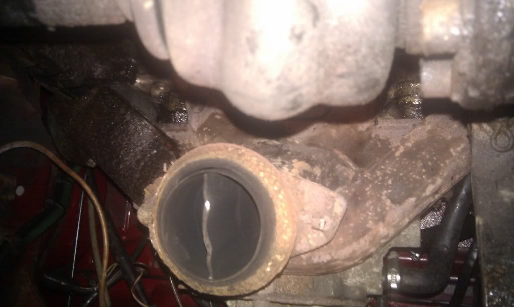

What I have established is that the coolant flange leak has clearly been going on forever and pretty sure it's been contaminating the clutch. There has also been what looks like an eternal cam cover leak going by the amount of oil everywhere. I have tried changing to rubber gasket maybe just needs torquing or uneven cam cover :dunno:

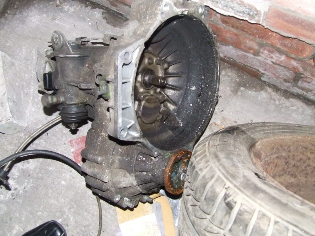

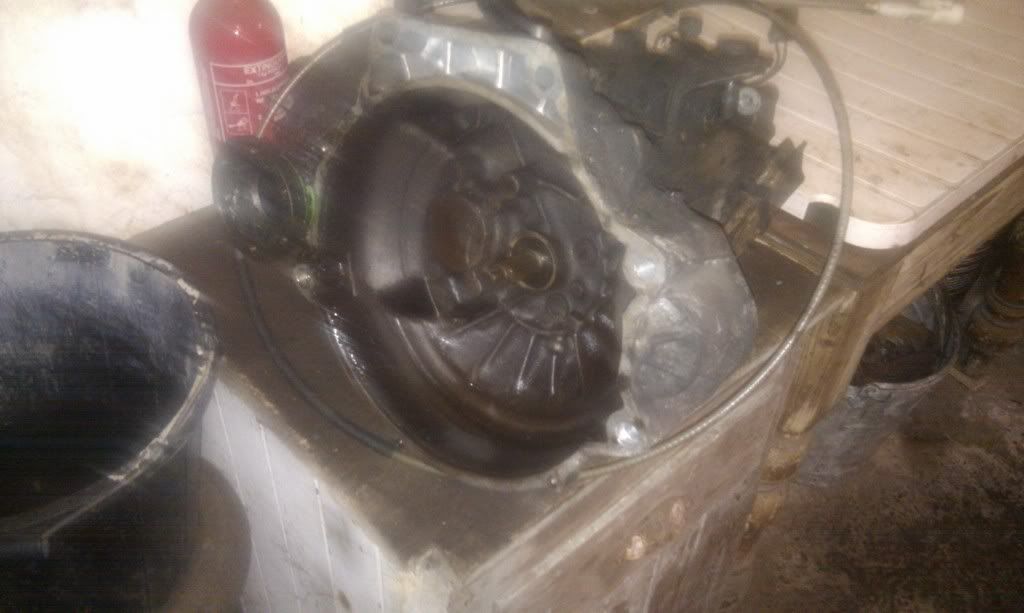

So far box is out (pictures of box will follow phone camera ran out of batteries)..

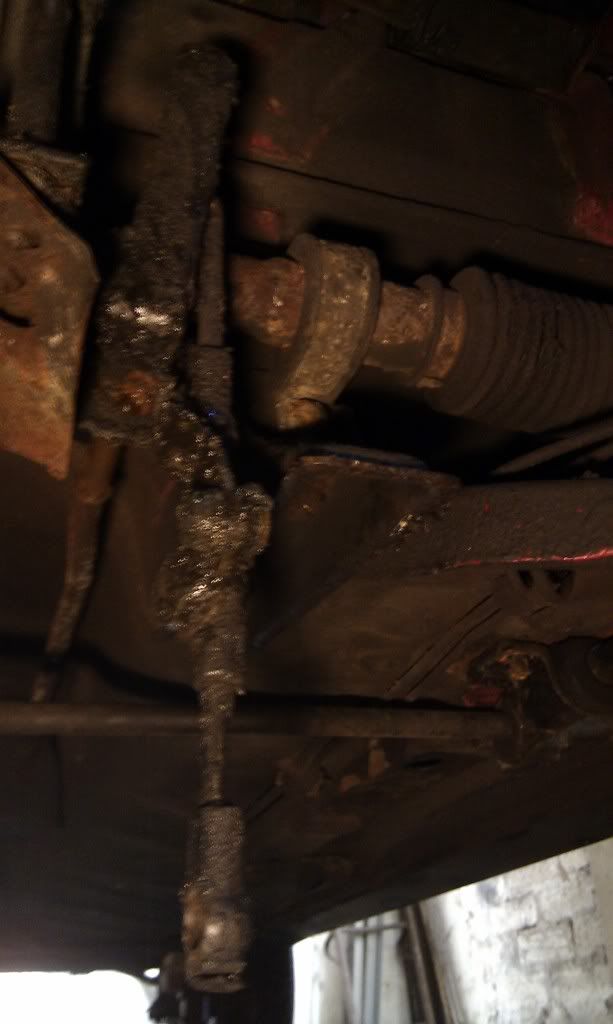

Linkage absolutely filthy will be removed and home-brewed short/weighted shift..

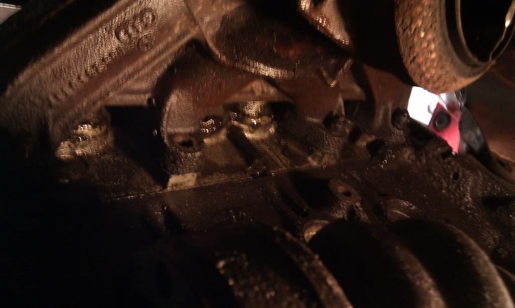

I feel embarrassed about this, been leaking for a long time..

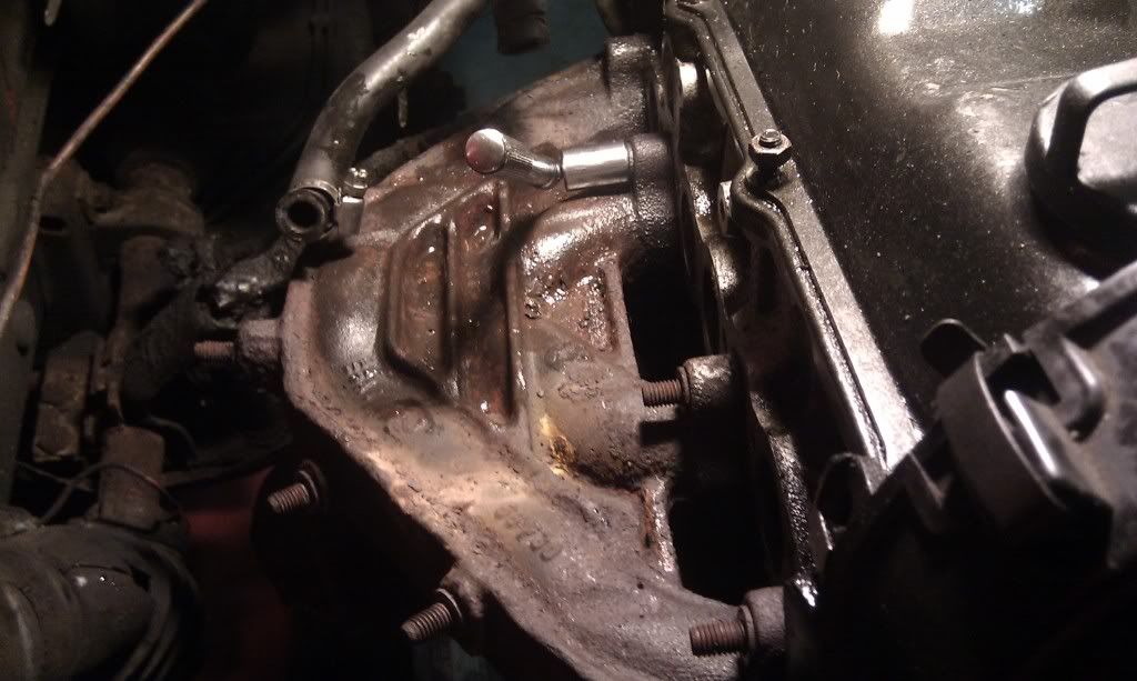

Was fighting with manifolds for quite a while trying to figure out their removal..
There are a couple of inlet studs that are really hard to get to but with the use of a dentists mirror I got it removed so I can change the gasket/O ring..
Then the final stud of the exhaust manifold was easy, all the bolts/studs came out easy if not a pain to access..

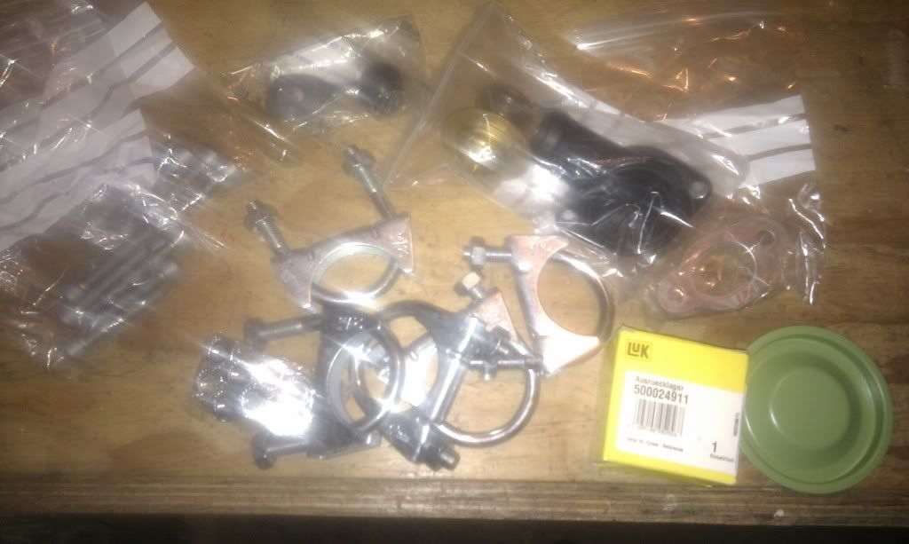

Bought LUK clutch kit (only £50), release bearing +cap, exhaust gasket, thermostat +housing, linkage ball thing, exhaust clamps, inner cv bolts etc..

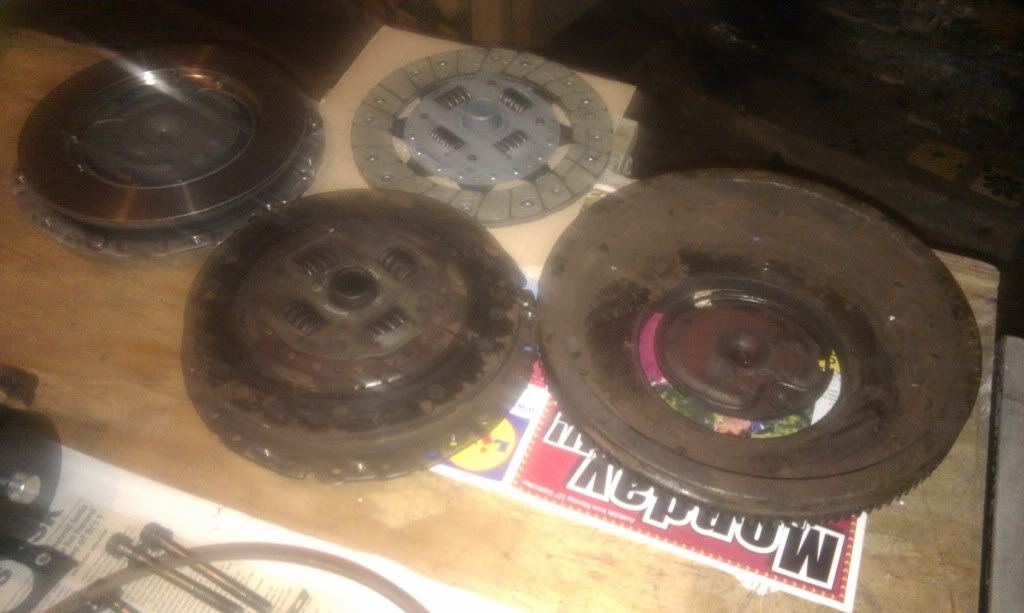

Old clutch comparsion, contamination! /fly wheel will need a clean..
Gearbox well dirty!

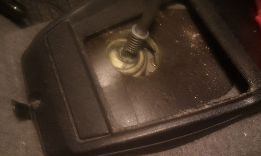

Frustrating trying to access the two bolts of the gear stick, console had to be loosened..

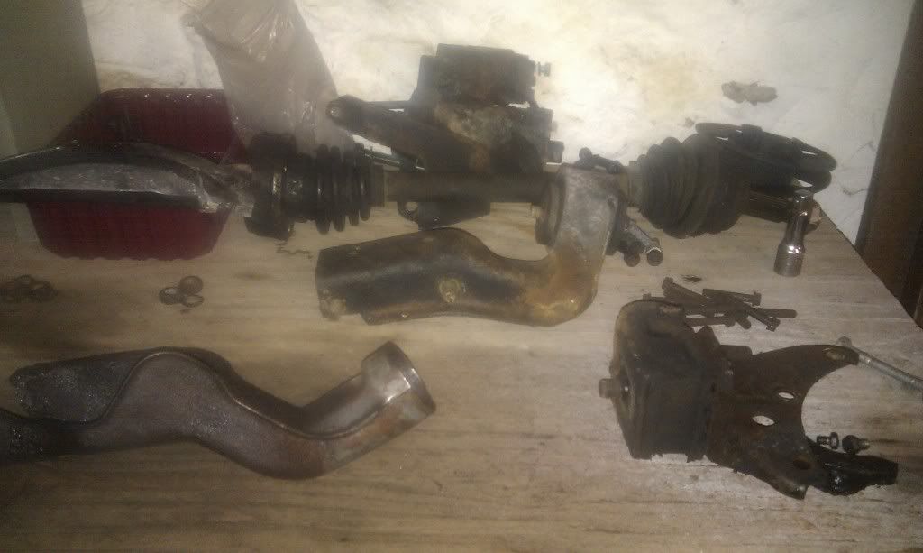

Parts for some refurbing..
