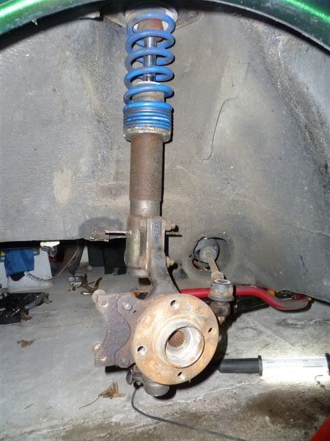

Front end completely stripped, removed the wishbones, brakes and lines, ARB and associated bracketry.
All brackets have been cleaned up and hammerited.. New Wishbones, ball joints and poly bushes fitted ready for the install.
Brake Calipers and Carriers have been wire brushed ready for a nice lick of red paint. The yellow paint that was on them was flaking and looked a right mess. The G60 Disks are alright bar a bit of surface rust so will be re-used after a spot of wirebrushing. Going to get some new pads though.The track rod ends seem to be in good condition so I’m going to leave them for now, plus it saves realigning all the steering.

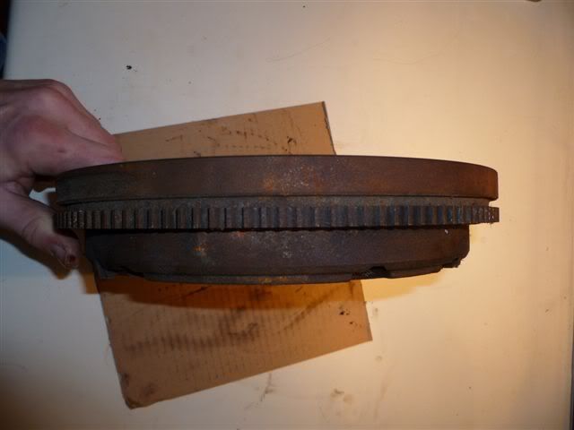

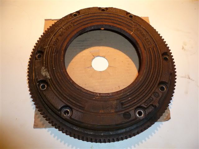

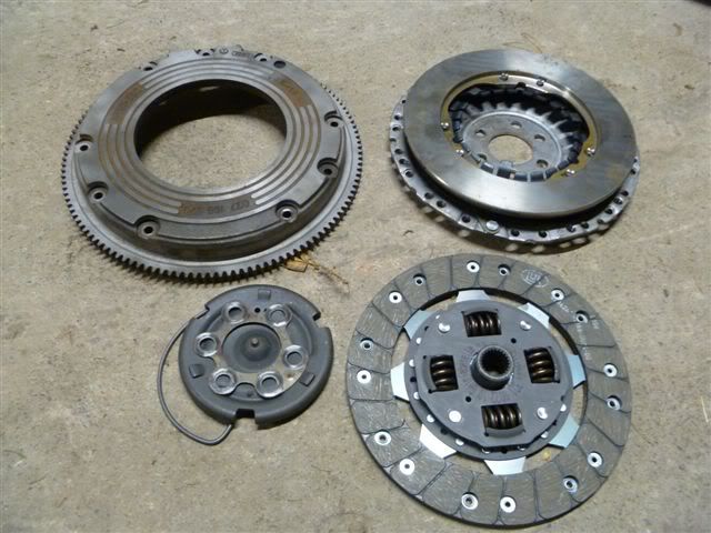

Flywheel off (yes it was a 9mm) and taken to the man who is a machining guru. hopefully i'll get it back some point towards the end of the week. i took my new clutch up with it so he could balance it all as one unit. Pics will be posted upon return, but after a short chat i think its going to come back alot smaller. which is superb!!
I need to get new flywheel bolts tho, on removal one snapped and the others didnt look too nice, i might have to take a trip to VW as GSF didnt appear to list them?

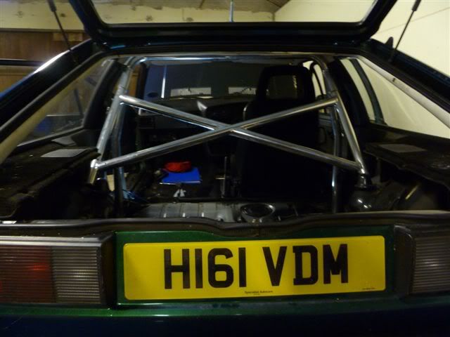

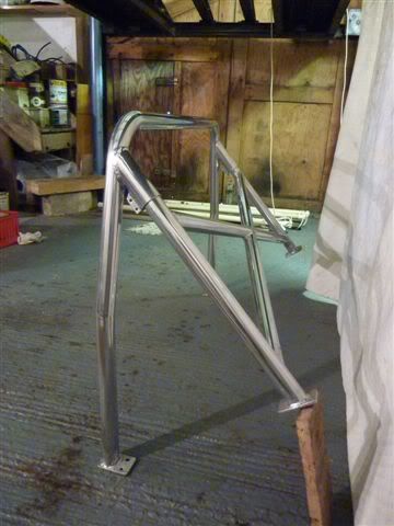

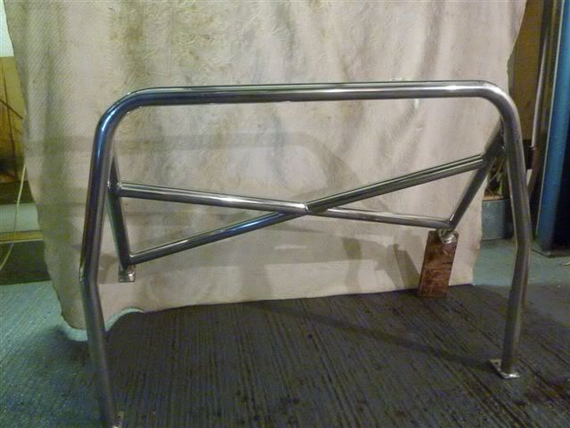

I've also been bad - and bought a roll cage...
I love christmas money!!! and christmas money loves my scirocco... :ebay: its a custom alloy cage made by Lloyd Allard Motorsport. I was first abit apprehensive about alloy cages thinking they were just for show use etc, but they do work... infact I think they alloy cage I had in my Mk2 Golf saved my life..

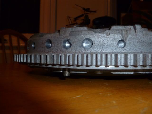

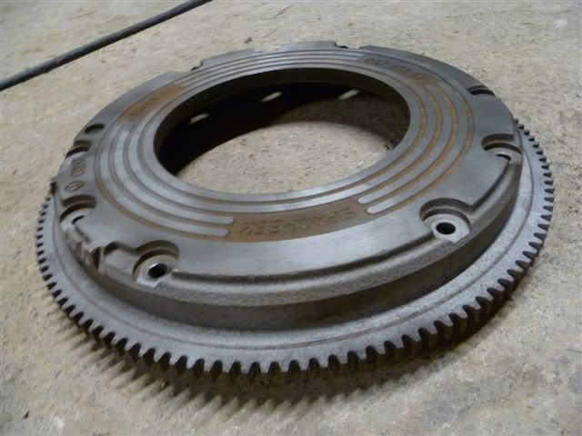

Been quite busy with the car and its moving on nicely now.

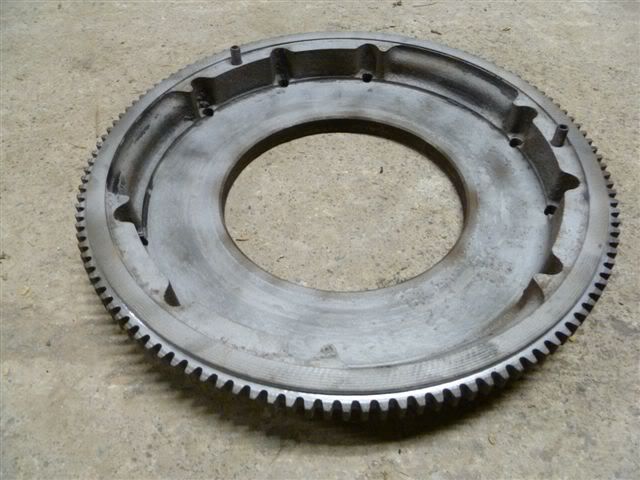

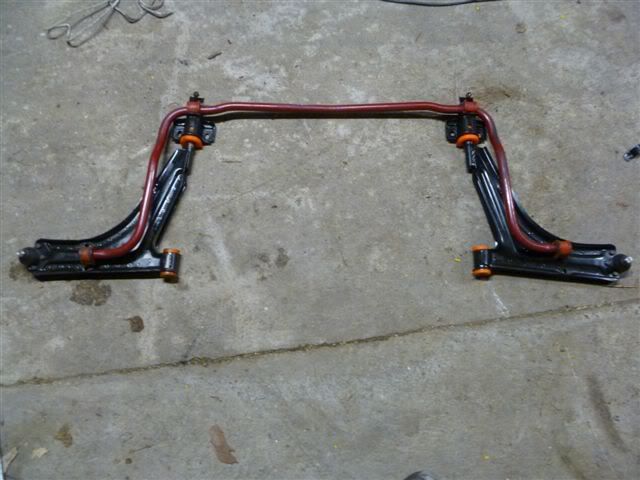

Got the Flywheel back, i’m really happy with it. Quite a conciderable chunk has been taken out off the back of it, as you can see the outer ring has been taken off up to where the starter motor teeth are, which exactly what I wanted as its where it makes the most difference. And then its been balanced again. I havent weighed yet so cant say exactly how much has been taken off but I will do before its fitted.

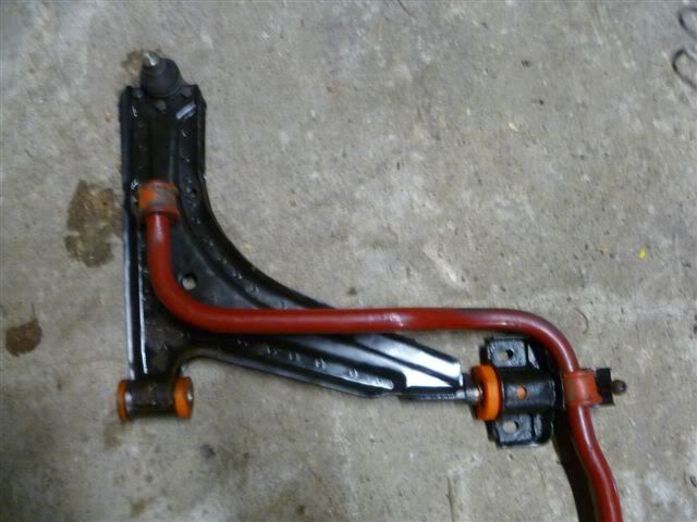

The newly poly bushed wishbones and Eibach ARB.

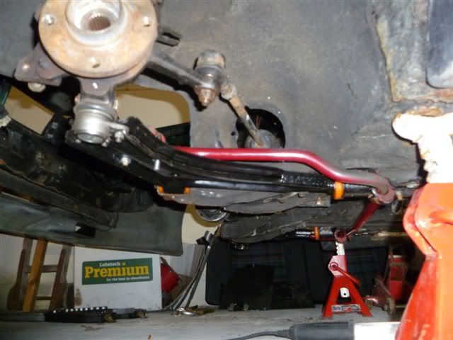

And Fitted
I’ve not fitted the cage yet, as I am going to be making some adaptor plates that I can weld into the car, but I trial fitted it and it looks really good too..

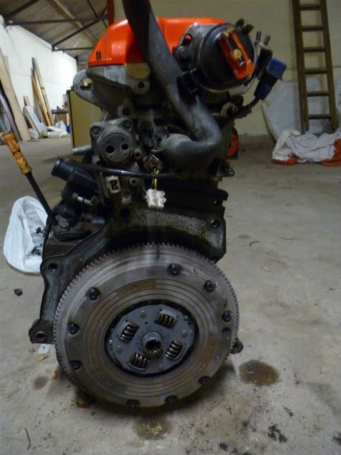

Put the new clutch and flywheel on (all new bolts) and also changed the cambelt while the engine was out.

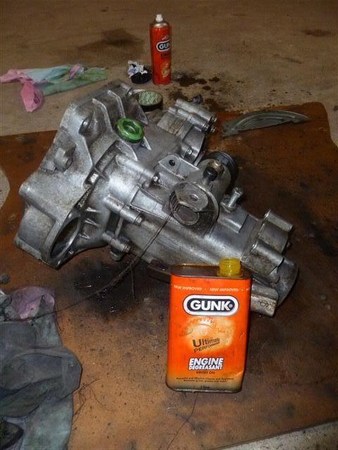

The gearbox was filthy so gave that a good clean up which took ages and then bolted it to the engine. Its not immaculate by any means, but is 10times better than when I started.

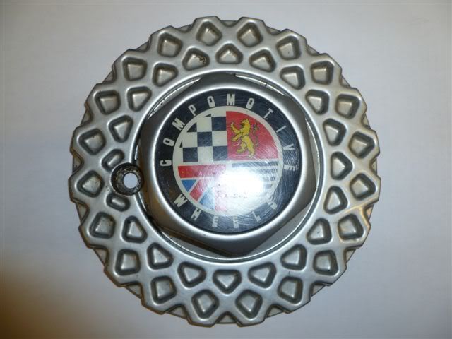

Oh, and I rang Compomotive Alloys today because I needed another center cap for the 5th wheel to use as a spare…. They thankfully had a couple in stock (6 to be exact) so I bought 2 of them, one for the spare, and 1 for a spare spare just incase I ever loose one on my travels. The man at compomotive said they stopped making the centres years ago and prob will never make them again... Finding pictures of these wheels if hard enough, let alone buying spare parts for them.
I asked about replacement centre logo’s too but they changed them to the new Compomotive logo back in 1995, fingers crossed he be able to locate some deep in some store room?!

Compomotive rang back, they actually only had 1 centre cap not the 6 they originally thought. The others were for later versions which are slightly different and dont fit properly. So thats in the post now. They also found some centre logo/decal things which is great. Good job I rang up and asked for some otherwise i would have never found one!!

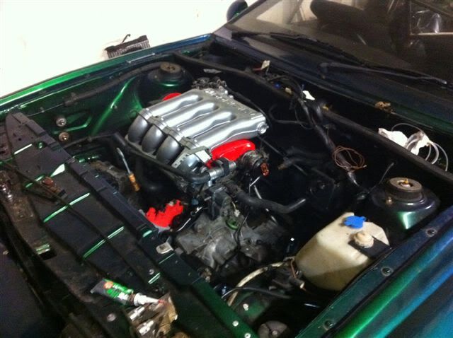

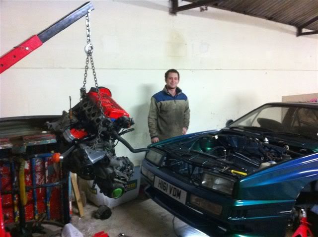

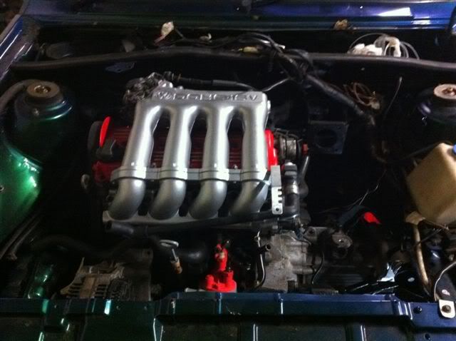

Been pretty busy so only had a few evenings to work on the car over the last few weeks. Good progress though, the engine was put back in last night!! Here's me holding my breath everything goes smoothly! :hehe:
Fairly straightforward but the drivers side mount is abit of a pig to do isnt it!? once that was located everything else went in without any problems really. All new mounts were used, the front one and drivers side are polyurathane ones. The others are new standard ones. Refitted all the brake linkage and greased that lot up, i just need a couple of those fabric washers now then the servo can go back on and I can make up some new brake lines.
