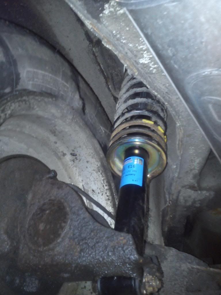

Off to the Phirm today after a three week soujourn to pick the car up. I must say it does drive, sound, and stop much better. But they're not the cheapest! Glad I got it all checked out properly though, and all the worst bits are done. Anything else I think I will attempt myself, apart from bodywork.
I sourced some parts myself to keep costs down, and hopefully this will be enough to get the car up to Liverpool next weekend and on the boat home.

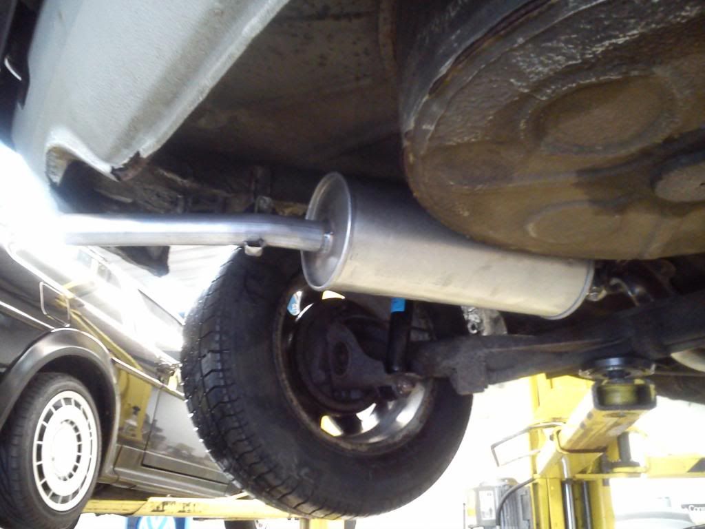

Among many things done were:
new shocks
new exhaust – which did fit, actually. Not as long as what came off it, but looks a bit neater at the back, I think.

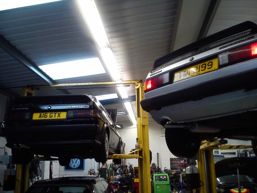

Also spotted this familiar looking beastie up on the ramps.

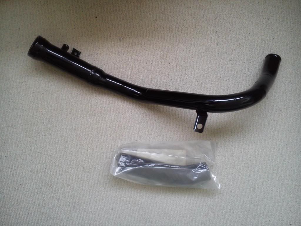

So, next steps... well, I have this original 40L filler neck to be fitted - thanks to Joost (Blueshark).

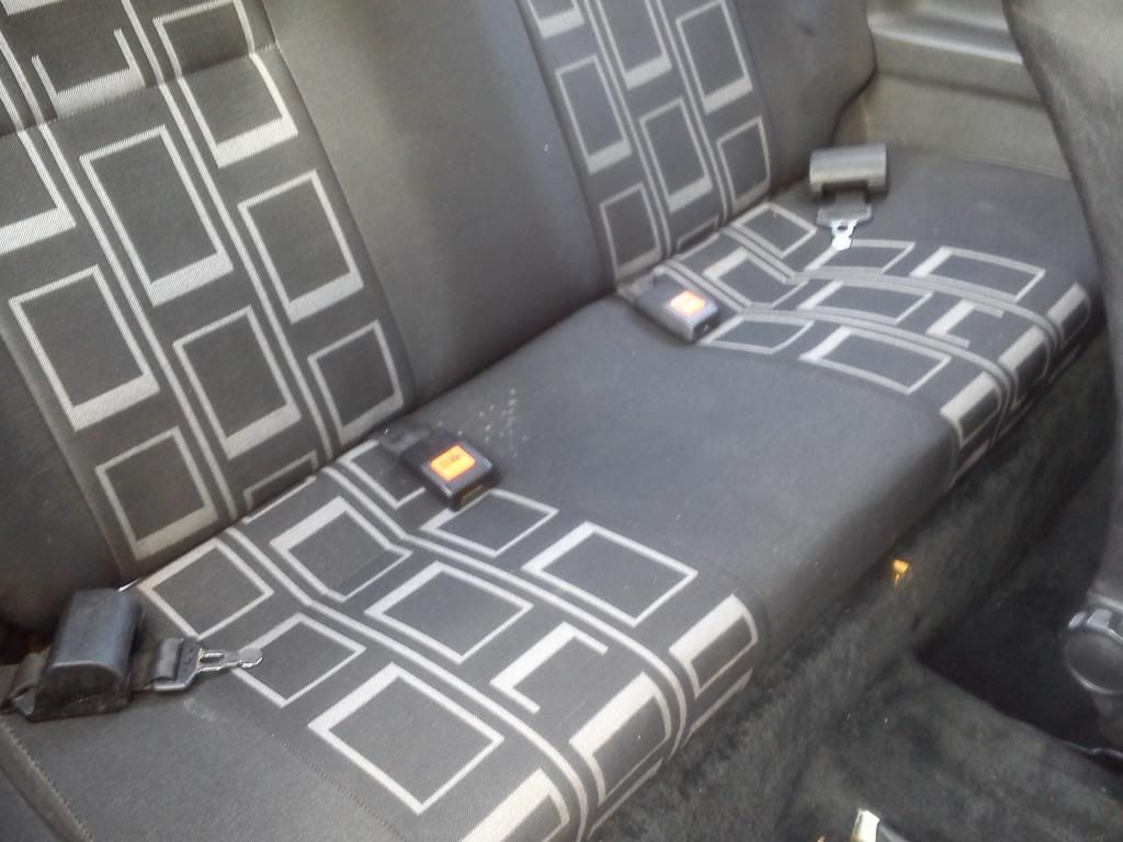

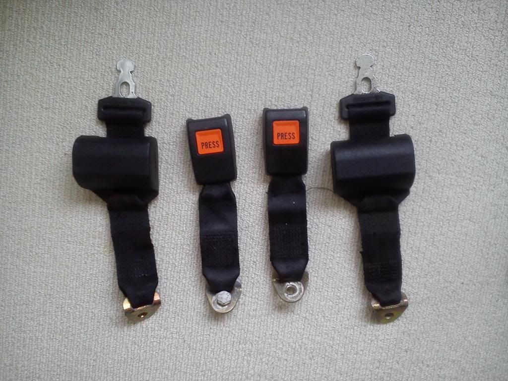

I also got myself some proper rear lap belts, courtesy of Marshall (shavhead)
new shocks

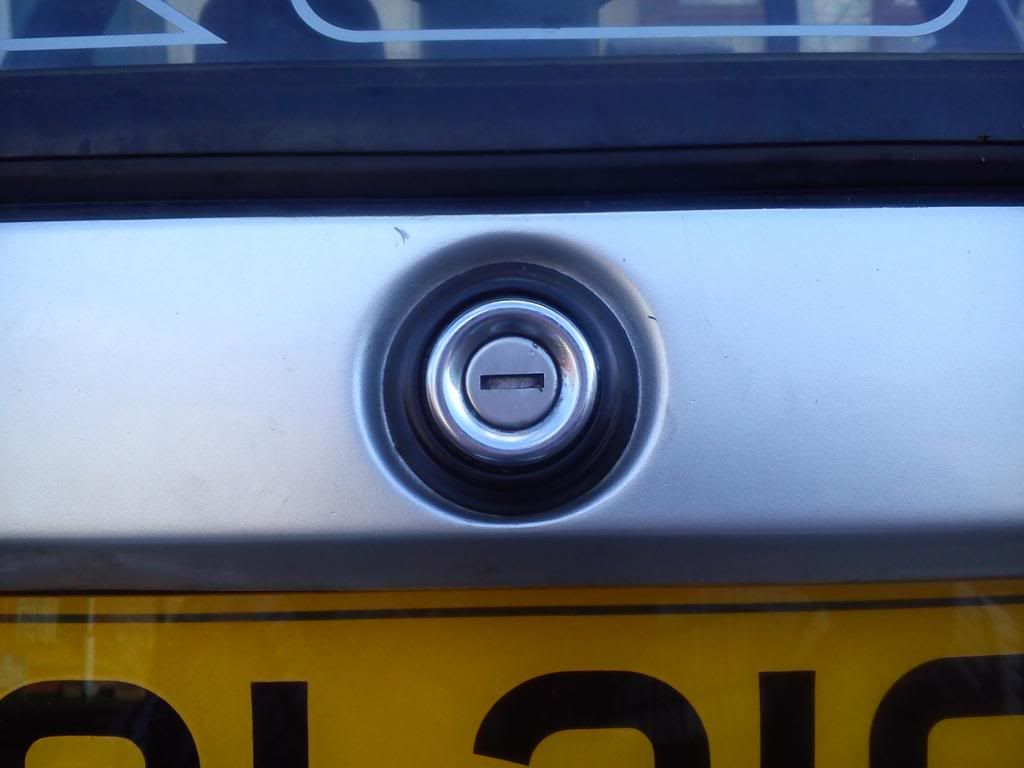

Fitted a new boot lock seal. the old one was like a piece of 30 year-old- licorice - or what remained of it anyway. have taken the carpet out to dry, mopped the floorpan and ordered a dehumidifer bag thingy

Fitted my seatbelts
