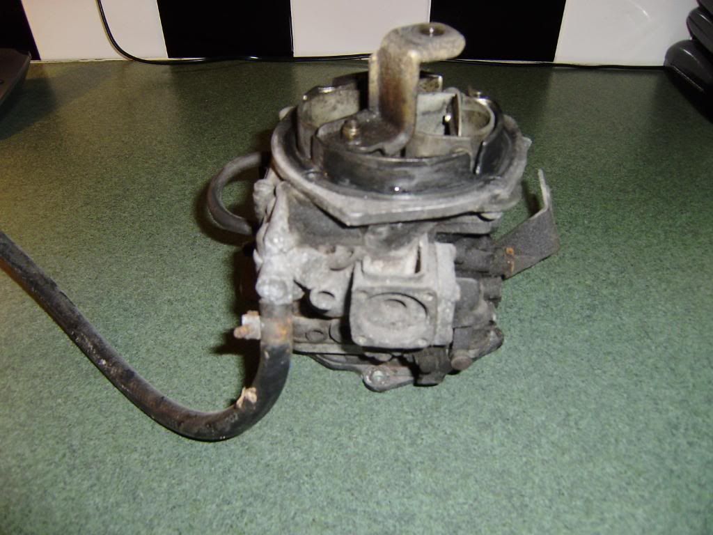

I think everything is there? anyone confirm? I do have another DTMR twin choke which will potentially have some donor parts like that choke clamp screw.
He reckons it's jetted for a 1.8. It was even attached to the same GT type airbox
So I'll get a DMTL service kit and choke cable ordered from Fast road and plan to either just go for a straight fit or even do the head gasket first as I have had suspicious coolant loss. Might look at new down pipe while I'm at it,be good to have removed both manifolds although not much fun with the C-clips potential seized nuts. There are other concerns however with potential diff bearings grumbling along with some unknown squeak at low speed. Then on to new suspension and bushes oh the joys off old car ownership

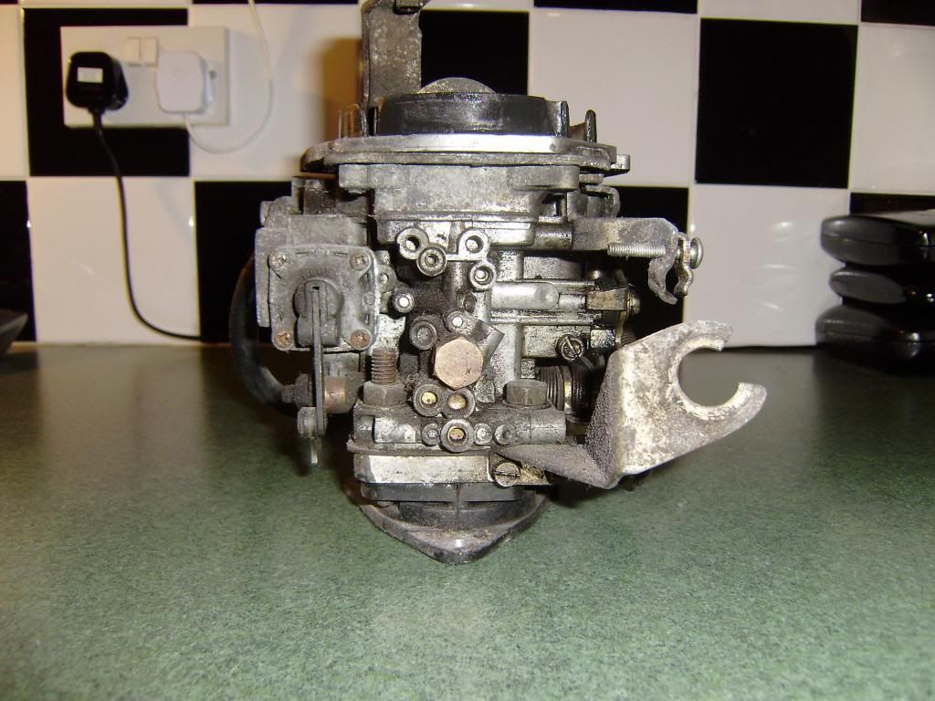

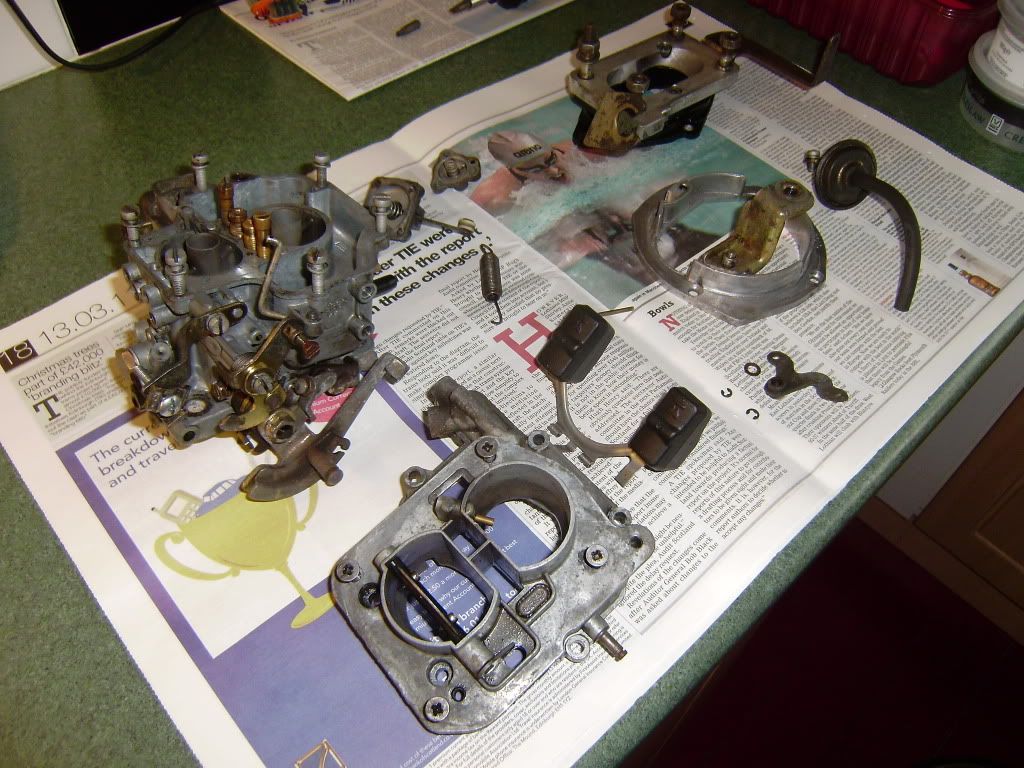

Was hoping to get the Weber fitted but ended up taking far longer to clean it and I'm still waiting for the the service kit,choke cable and a standard shaped K+N to arrive .
These crank case breathers don't half make a mess of these carbs
but now stripped and cleaned ready for the kit seems in very good condition..

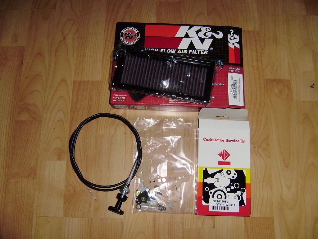

Fast Road came up with the goods so a service and the next few days off this will be fitted
although I just emptied another half cup of oily water from my catch tank so the Weber fitting might well be a full headgasket and timing belt etc. etc.

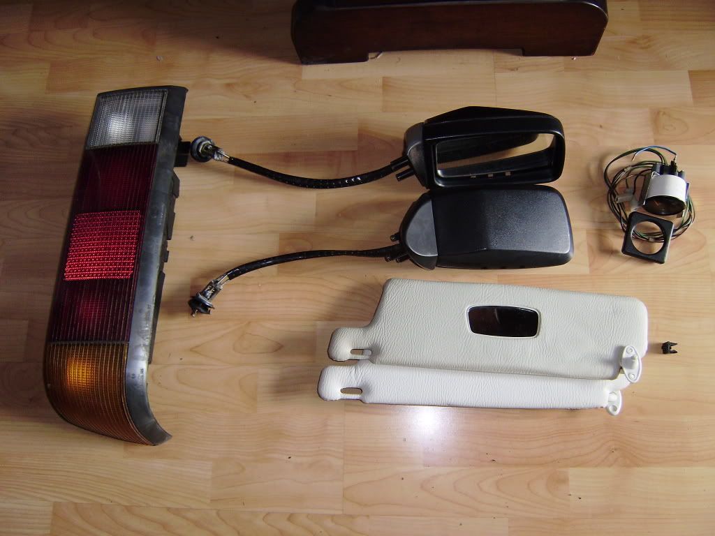

Some replacement bits..Can I take off the glass from these mirrors? I see CPT custom did it in an undesirable way
(feel your pain mate) but can they be popped off so I can treat the rust inside? Why does this forum cut my pictures on the right hand side?? theres a vdo oil temp dial there.

Assuming it's not been glued in the past(!) you should be able to pop the mirror glass out with a screwdriver in one of those holes in the bottom of the casing. Pointing a light through another may help you see what you're doing through the 3rd! Bear in mind there's a white bit stuck to the glass, and it's that which clips to the off-white plate. Seperating those 2 is what you're after.
What I do:

MacColl wrote:Can I take off the glass from these mirrors? I see CPT custom did it in an undesirable way(feel your pain mate) ...
Have a look at this and see if it helps?MacColl wrote:Why does this forum cut my pictures on the right hand side?

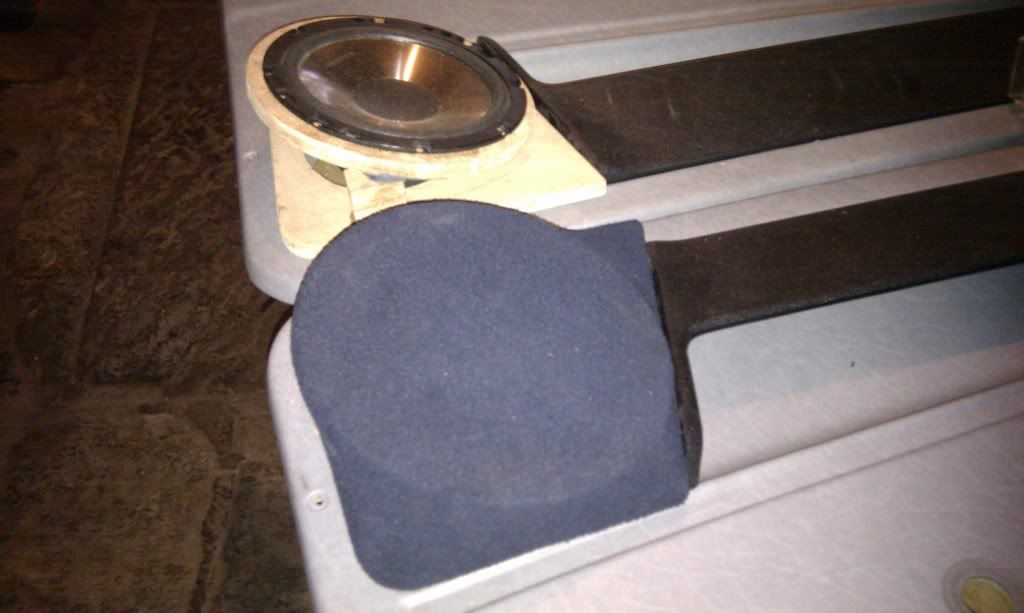

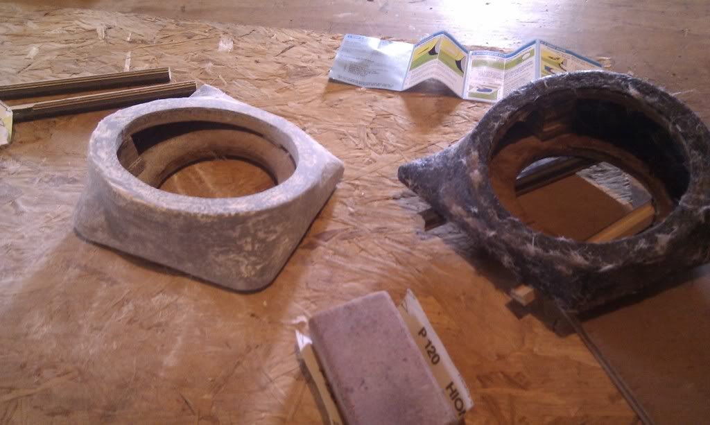

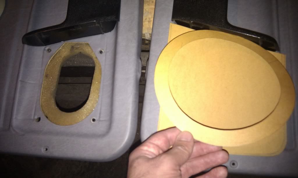

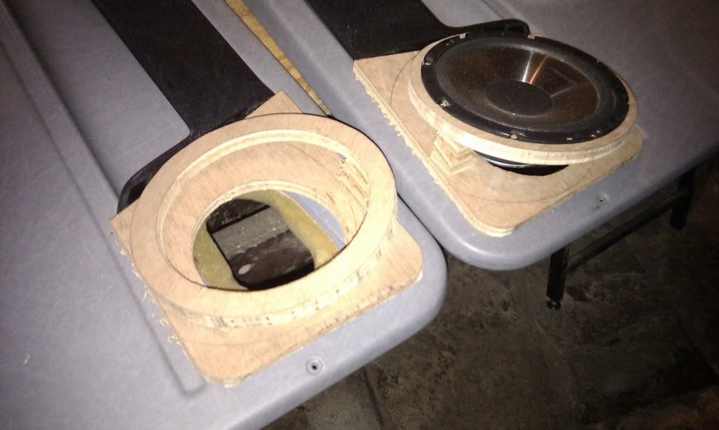

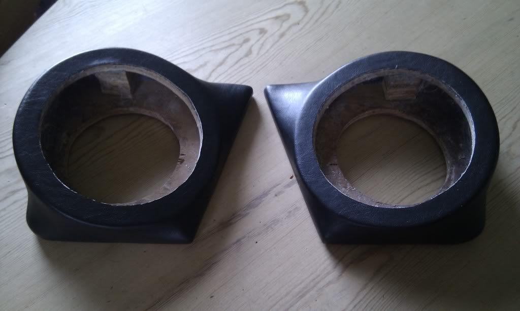

Very frustrating last few months, so much I wanted to get done to this car but just haven't had the time or energy
So what do you do when there are so many whines and clatters coming from your car that you fear every journey?
Sort out the ICE of course..

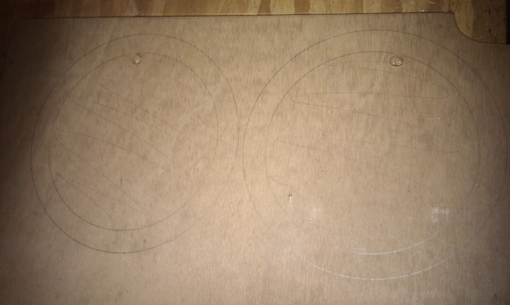

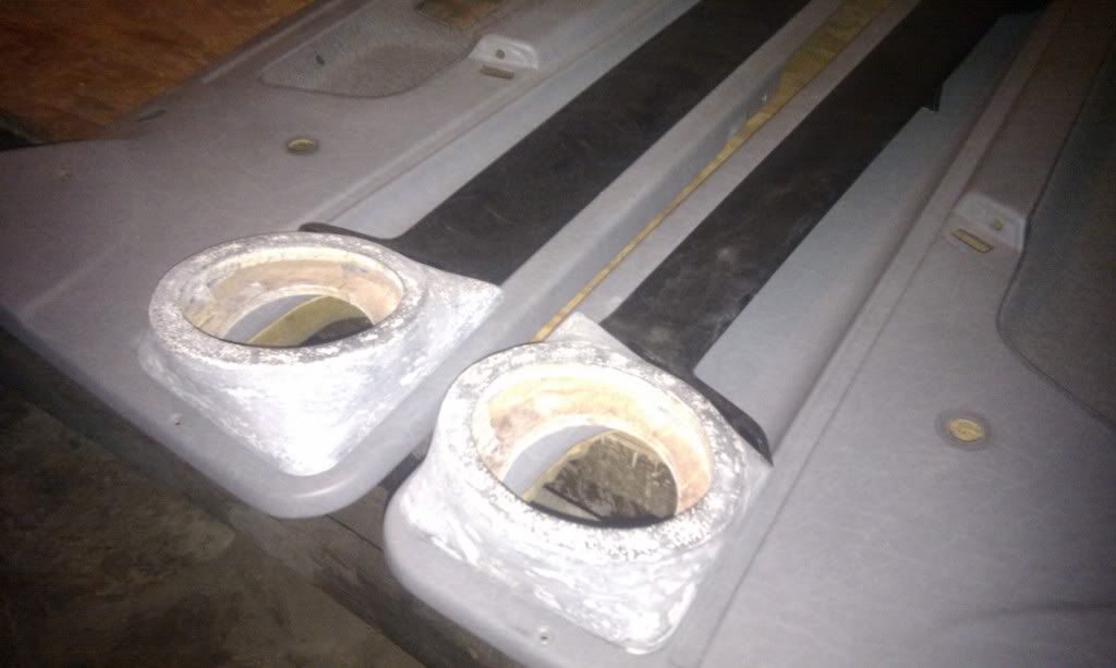

Bought a Kenwood head that will take a jack from my Android phone and fitted Alpine 6x4's in the rear then started this on the door cards..
A risky cut of the plastic on the band saw..
Card templates..
Ply was marked out..
Rings cut with Jigsaw and band saw then mocked up..
Then might try some fleece material and resin. What would I use? the stuff you get with fibre glass kits? Might just shape wood and use filler. It will work either way in the end.
