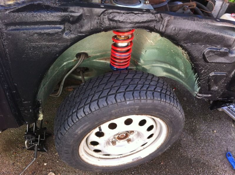

took a few snaps of todays progress

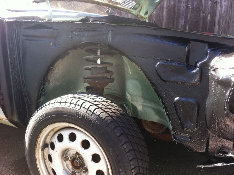

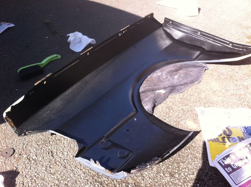

inside of wing cleaned, hammerited and waxoyled
same for inner wing
and inside the strut turret

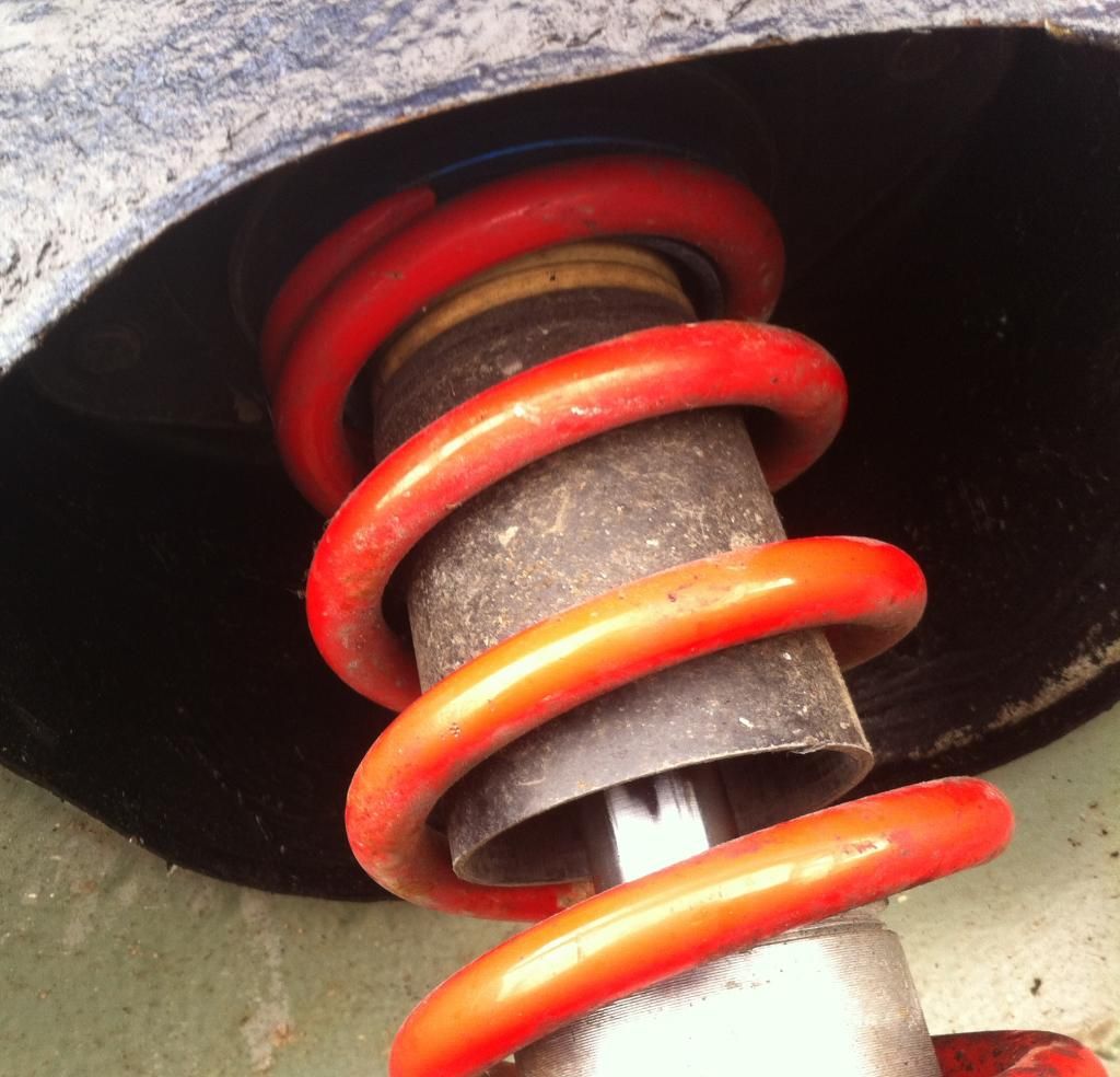

also fitted the front and rear coilovers while I was there.

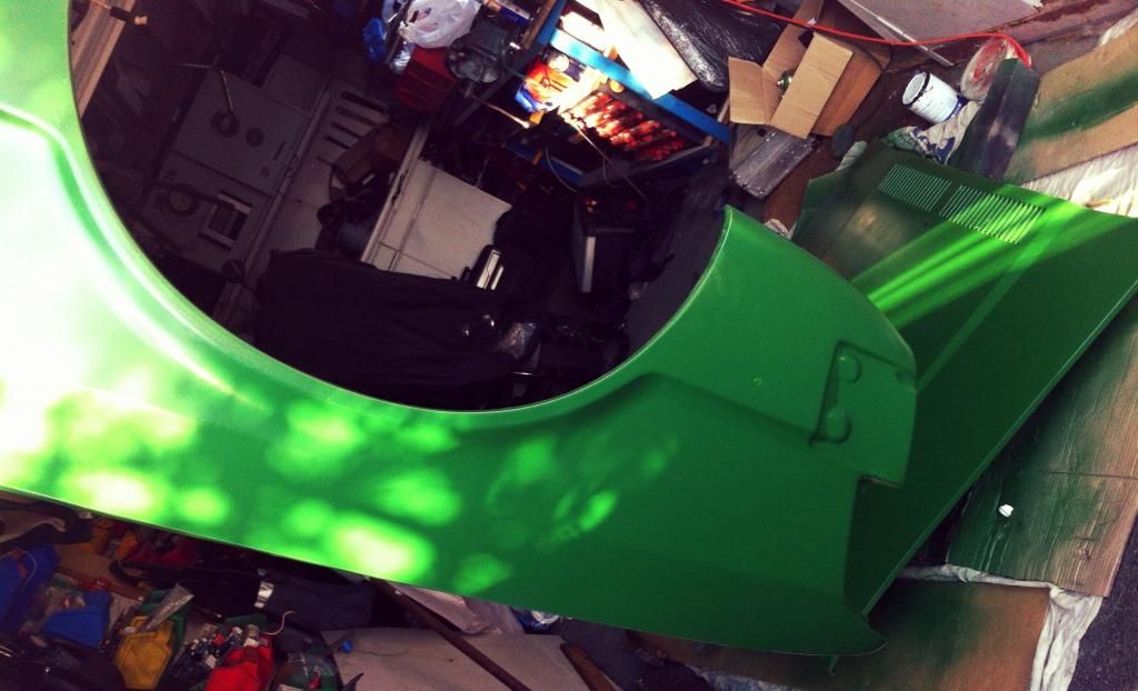

passenger side inner wing has been repaired, derusted and protected
and....

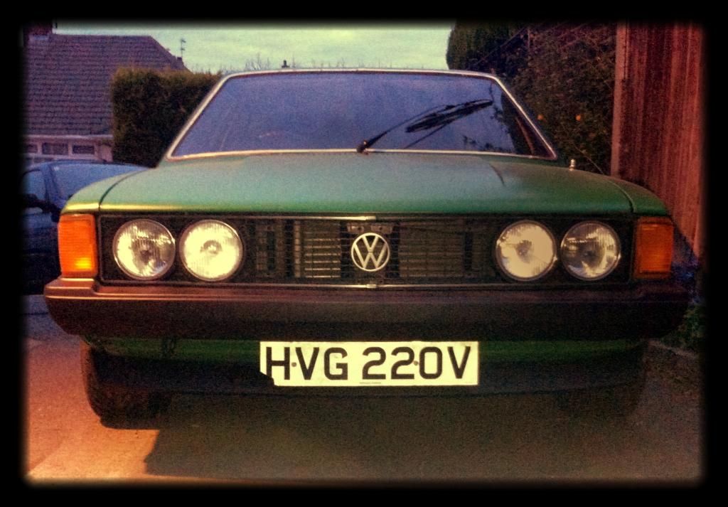

bonnet, both wings and the lower rear panel are done. its turned out way better than i thought. not perfect by any means but im happy. it seems the cheap rattle can gamble is paying off
hoping to finish the rest tomorrow. if not it will be finished on friday then its MOT time!

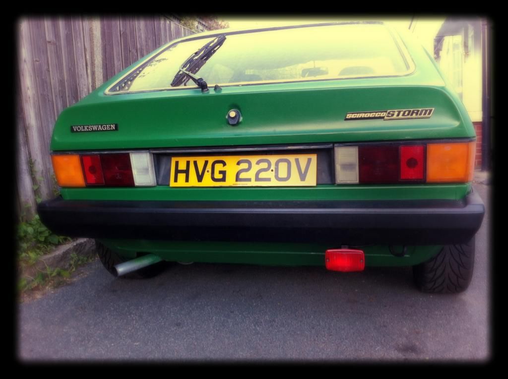

(before i'd rinsed all the dust/dusty rainwater marks off)

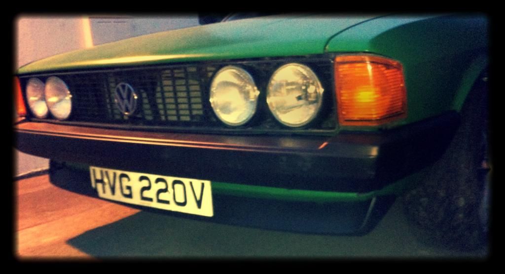

all thats left to do is paint the doors and shuts, attatch the splitter, apply the decals, give it a good clean then to the garage for downpipe replacement and hopefully straight in for MOT the same day.
if the weather is good tomorrow or tuesday the paint and decals will be done and i'll book it in to my mates garage :D
really excited now that im so close to finally driving it.
oh and just incase anyone was wondering
the tatty plastic numberplates are going the journey to be replaced with shiny new metal pressed ones which i'll be ordering once the car is on the road.

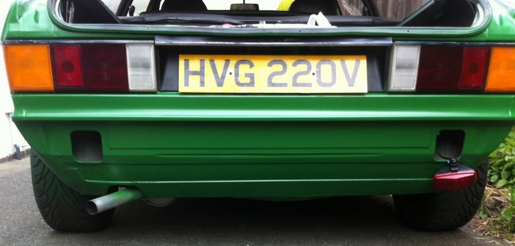

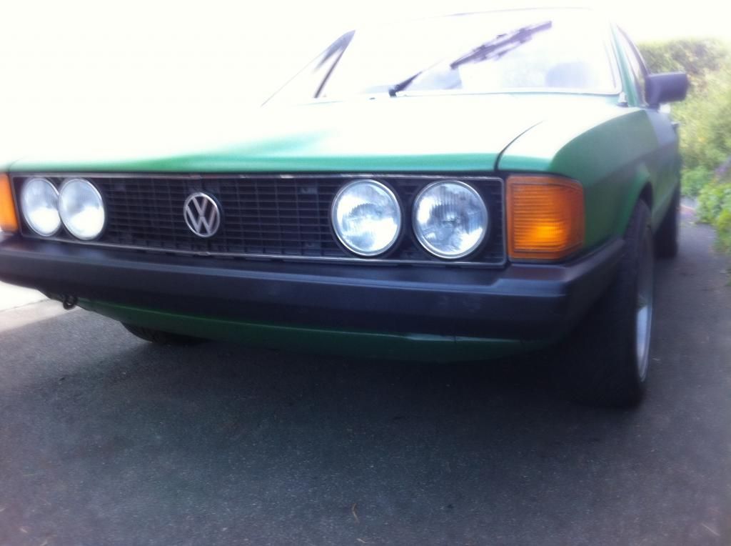

Drivers side door is done and the front splitter is attatched
that just leaves the passenger door and shes ready to go.

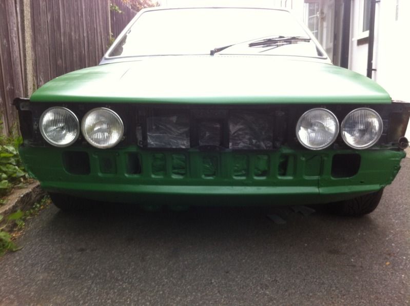

Re: A Storm is coming (1979 Mk1 Storm)
Looks really good on the pictures, one thing I did notice in the last set of pictures is your front wiper is parked in a strange place?
Rich_Rocco
Posts: 131
Joined: Thu Oct 06, 2011 5:31 pm
Location: Sunderland, UK
Post by Rich_Rocco »
Nate wrote:considering that's a rattle can job, you done good there mate :) out of noseyness, how many cans did it take?
I had 16 cans and have 2 and over half left but theres still the passenger door to paint so once thats had 2 decent coats i'll probably have enough of a can left that i can "touch up" any carpark scratches etc haha
mark1gls wrote:Looks really good on the pictures, one thing I did notice in the last set of pictures is your front wiper is parked in a strange place?
youre right
that was down to me turning the ignition off before they were finished their cycle then taking the battery off :p
its still like that actually but im replacing the blade tomorrow so i'll have to reconnect the battery to test
Edit: come to think of it i need to check if ive even tightened the wiper nut up properly because i cant remember doing it haha
