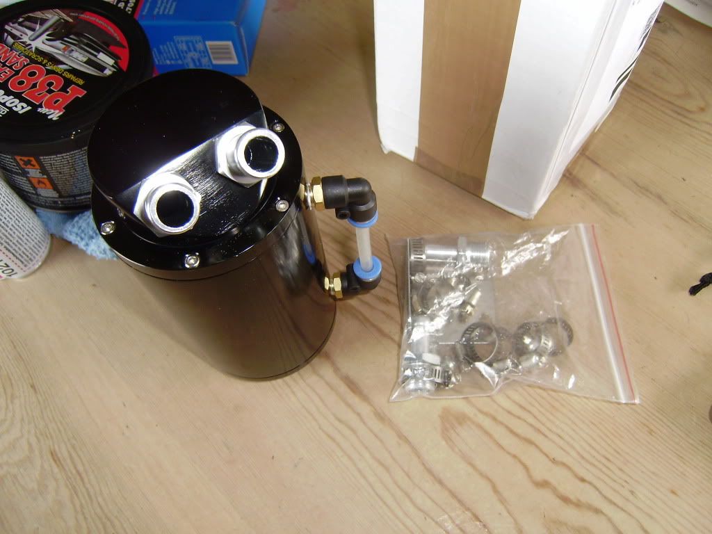

Re: RED DEAD Revolver-Hopefully daily 89 Mk2 GT
Regarding the oil in your carb:
Mine sucked oil in up the breather pipe - this would then run through the air box and leave the air filter looking like it had never been changed, (I changed mine after 6 months once!) and pulled the rest into the carb. Popping an oil catch tank in line on the breather hose solves it completely.I was amazed how little oil it actually catches (and how much mess it makes!) - mine had more condensation in than oil.

Yes it's the near mile walk in each village to get the train that is especially grim. I had the carb home on the train with me worried about the fumes but the fumes from the Old firm fans were stronger!
^Thanks
I'm set on getting a catch tank probably something like this..

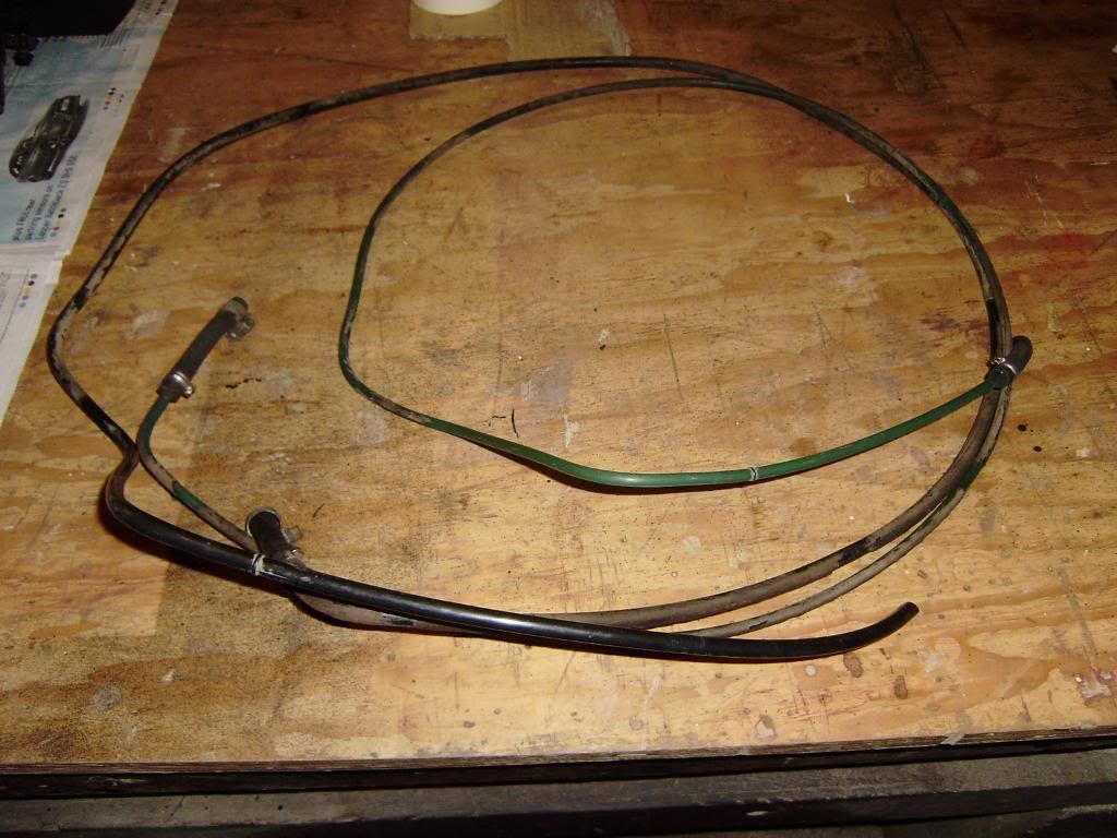

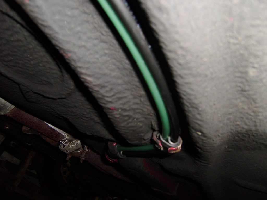

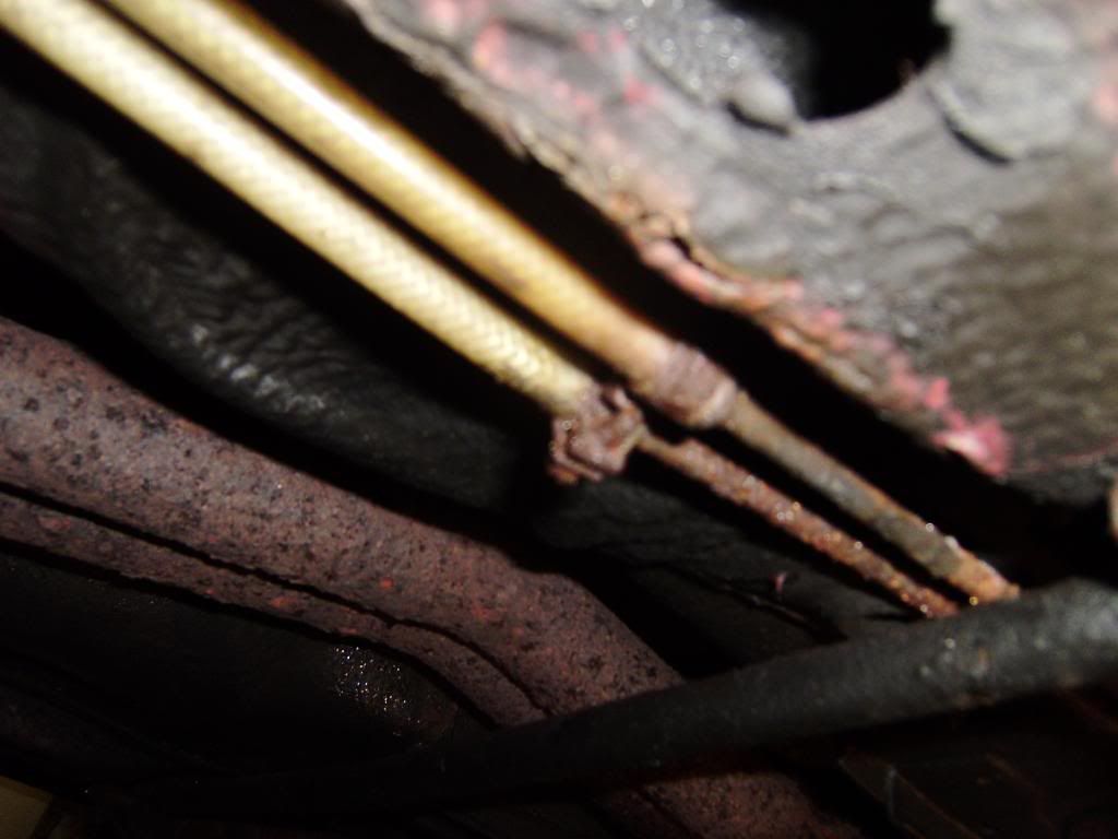

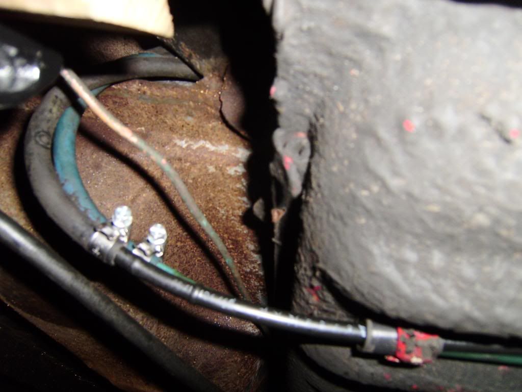

Discovered a poor fix with the rusty fuel lines which must be sorted, going to try and use Polo fuel lines I have (I know I see the exhaust rust too!)..

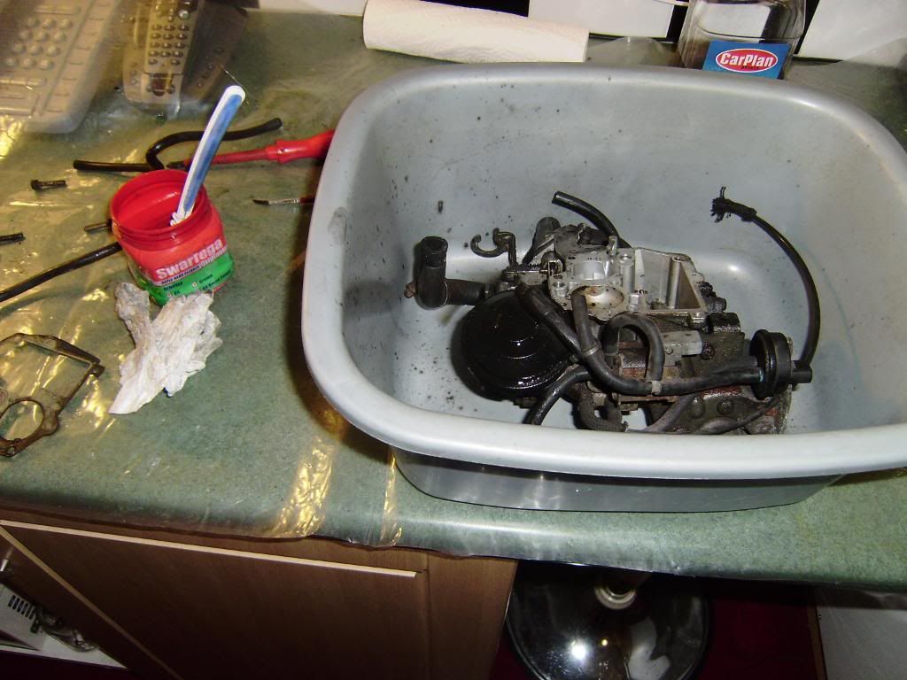

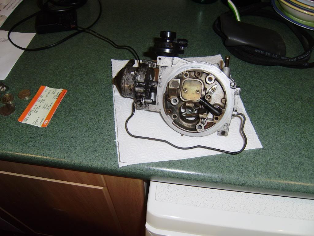

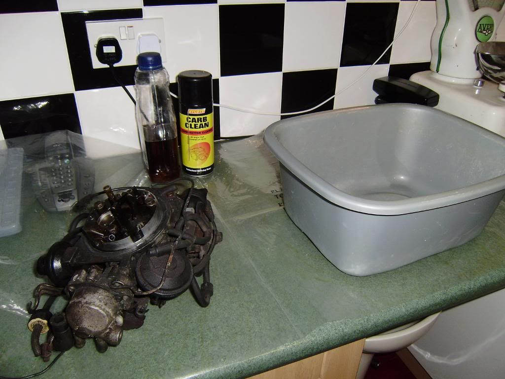

Finally right now with the Super bowl on I am cleaning the carb, nothing like using the kitchen for garage work..
Cleaner..
Just the lower half to do, run out of Carb cleaner but should manage with the paraffin stuff I have, the smell is almost as nauseating as the Black eyed peas were at half time..
Cleaner..

Catch tank was purchased after some good advice from Fonzooorooo..
Carb looking a lot healthier with perished vac hoses replaced where necessary..
Managed to make Mk2 GTI fuel pipes fit the car using some improvising with pieces of old rubber innertube, not ideal but no more dodgy corrosion..

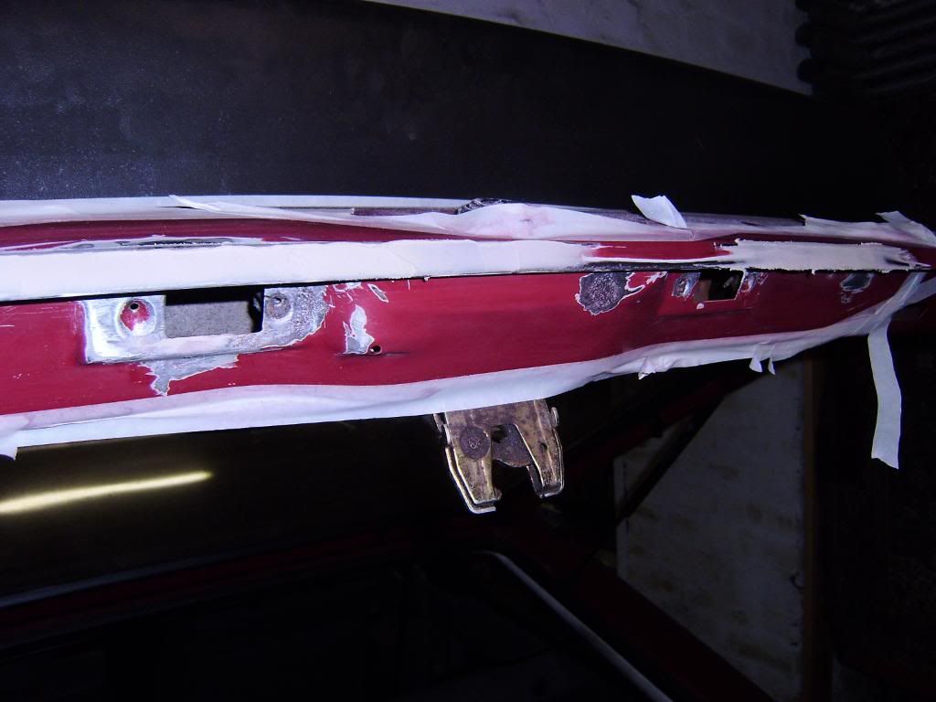

Bit of filler on tailgate that was welded then etch primed and the black stuff is seam sealer on the more pitted bits and on the seam where the metal flaps round. this inner bit will be painted satin black I figure the finish doesn't have to be perfect. I'll then paint the outer in colour match and look at painting the whole tail section when the weather gets warmer..

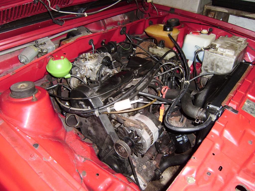

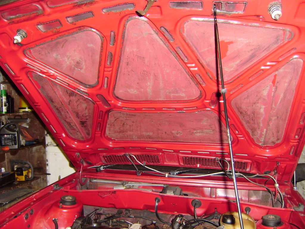

Engine bay starting to look a lot better (excusing the ridiculously large battery which will be replaced)..

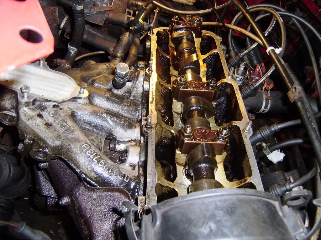

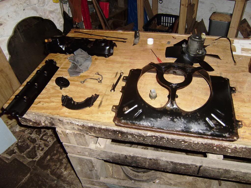

Cam cover/rocker gasket was fitted, dam fuel leak hit the cover and the rad cowl stripping a bit of the paint, this will be sorted later..

Don't know if you know but there is a tiny petrol filter in the brass tube you connect the fuel hose to on the front of the carb. Just pulls out with a small BA screw twisted in a couple of threads. Clean it out to save you chasing a fuel starvation issue later.

^Thanks for that, not checked that filter on the carb inlet yet. I take it it's just like the mesh ones you get on Webers. Not got round to it yet.

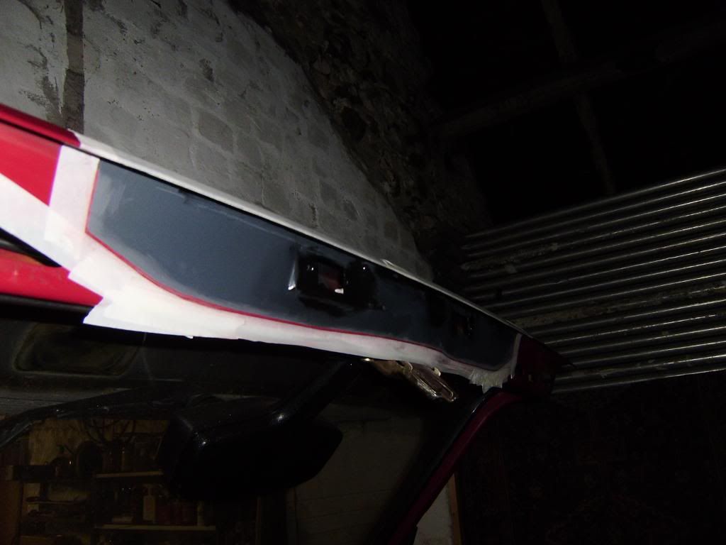

Today was a good day
got through an MOT with just one advisory on worn brake pad (this was always going to be addressed anyway)

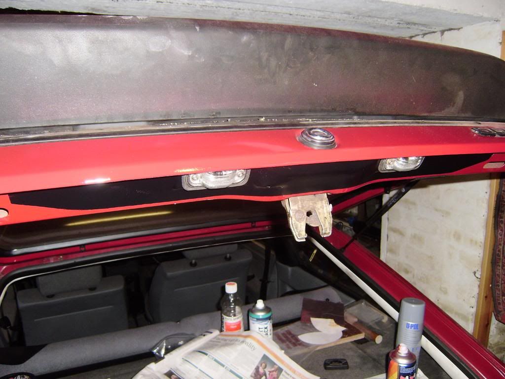

Managed to get the tailgate done, not happy with the satin black paint and the red was just applied really until the weather is more appropriate when I'll be looking at a spraying the whole lower section. I'm happy with the general profile of the welding and filer though..

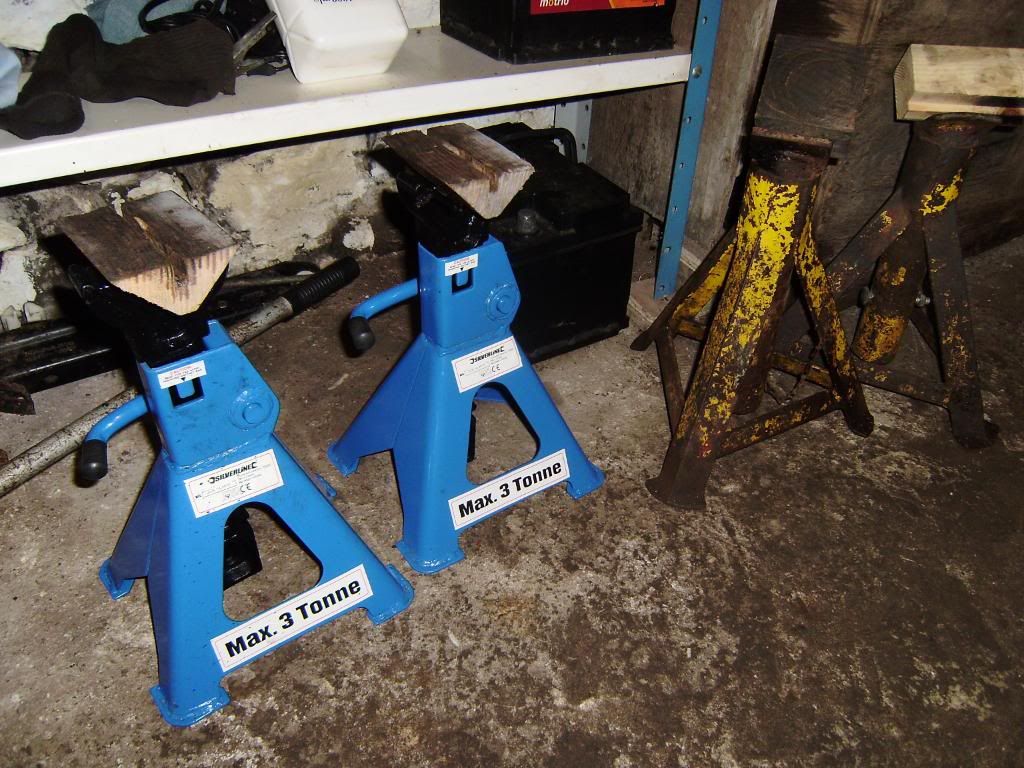

Total bargain £14.92 axle stands from Toolstation..

Bargain ineed, thanks for flagging them up ...MacColl wrote:Total bargain £14.92 axle stands from Toolstation ...

^Yes they seem real solid, I'm always looking for bargains on equipment and it's good to share

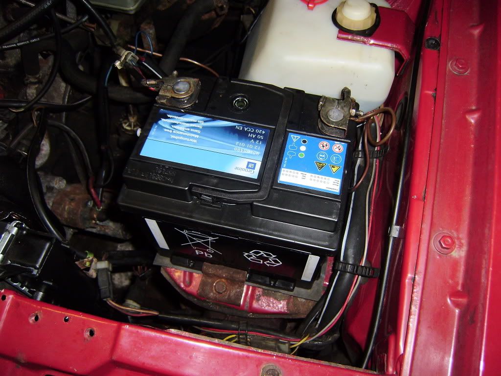

Another pretty good price from a wee independent motor factors is a GM battery for £30..
ianaudia4 mentioned Volksfling earlier, I'm hoping once I get my membership sorted to attend. Want to keep going with improving the car and it's nice to have a target date to get it to a more presentable state. Cold start is an issue, just won't idle for a minute or two so that is the next job to figure out.
Re: RED DEAD Revolver-On going daily 89 Mk2 GT
No membership is required for Volksfling mate, turn up and go on the show and shine, we won't win but it is the best parking at the show!
I hope you have a bigger than 45 amp alternatorfor that battery bud!

I'm not buying Crazy Quiffs arb clamps to win a concours event lol. Yes I'll see what plans you folks have in the events forum and maybe camp one night.
You have me worried about the battery, once again totally ignorant
Thought any 063 would do? The alternator is a reconditioned one and doesn't look stock. Can't tell what amp it is till I probably remove it. It is pictured in thread if anyone knows?
