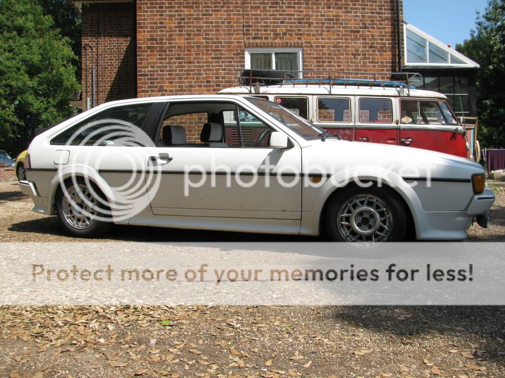

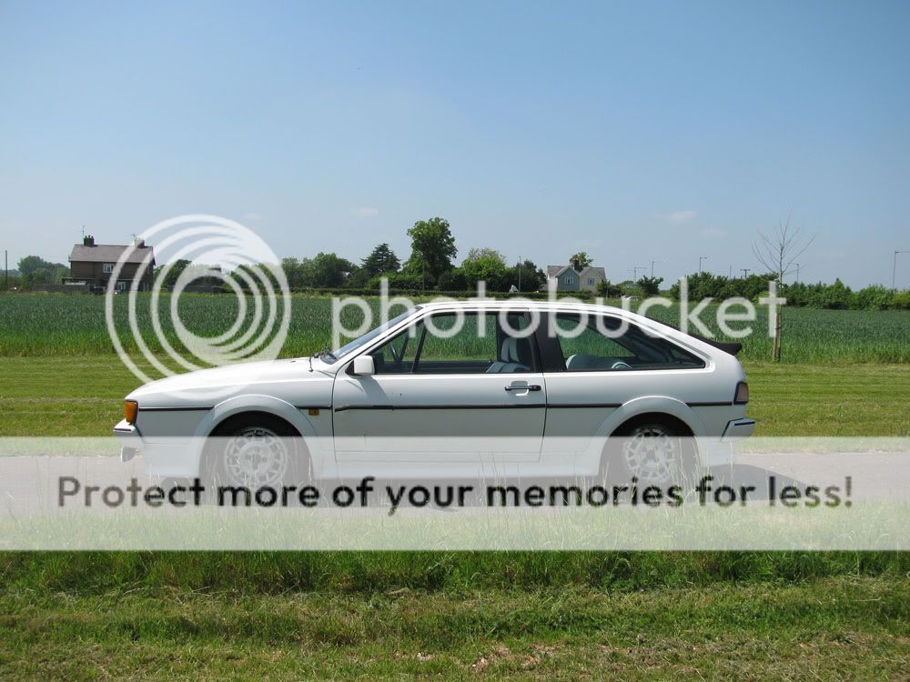

Couple of images, showing both sides. Standard 14" wheels, although the front tyres have now been replaced with slightly smaller 185/55/14s as the 60s used to scrub alot. I've also raised it probably 5mm since then.

Beddo88 wrote:Couple of images, showing both sides. Standard 14" wheels ...
Thanks for not only posting the advice, but for going to the trouble of posting the photos - just what I was after.
If I've done my calculations right I reckon your car is now about 55-60mm lower than standard. I think it looks great, but as I don't want to fill the arches too much and will be running 15" rims initially, maybe even 16" in time, I'm now thinking I want to go 30-40mm max.
Thanks again mate ... you've helped me a lot.
