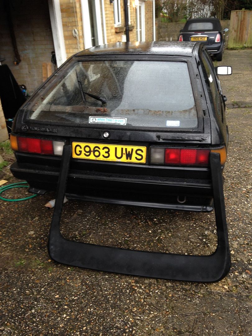

I spent a little time trying to find that pesky leak, it's pooling inside the tailgate and I have eliminated the lock seal and the badges as a source of the leak, it's weirdly only on the drivers side...
Anyway took the spoiler off
The spoiler looks like it has a few foam pads sealing it but also a lot of silicone sealant, so I guess this could be either a legacy leak that is leaking again because the sealant has just lived out its life or this isn't actually leaking...
I taped over the holes with my trusty duct tape, just to see if by covering these holes the leak goes, I can't say for sure as I only left it in light rain for a few hours but I don't think this was the leak, I will leave it overnight/the weekend and see if it puddles in the boot again :(
On another note, the spoiler off is good, but I think I need the smaller spoiler sooner rather than later! Although at this rate I may aswell just buy a new bootlid with a small spoiler on it that doesn't leak!!!
If this isn't the source of the leak I can only think it's water making its way in around the window seal...
