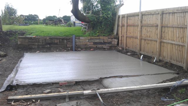

Whoo hooo... concrete has been poured!

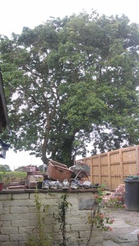

Had a few issues hence the delay in getting this done... there was a MAAASSSIVE tree at the bottom of the garden, which looked rather precarious, so i took no chance, and had the rascal chopped down. I was all set for concrete a couple of weeks back, but the tree man said if i put it down then dropped the tree it would ruin the concrete. The technique he used is called "Pollarding". its like extreme pruning. basically you just chop the tree back so its a big stump, and it starts growing new shoots again. its given us enough wood to last about 4years and lets tonnes more light into the garden and back room. This is the tree before...
Concrete poured and leveled

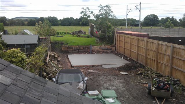

You can see how much tree we have left... looks proper drastic but in a couple of years it should look alot better

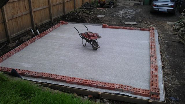

Dried and ready for bricks.
Nice weather today up in the NW, so think a couple of beers and spot of bricklaying is in order this evening.

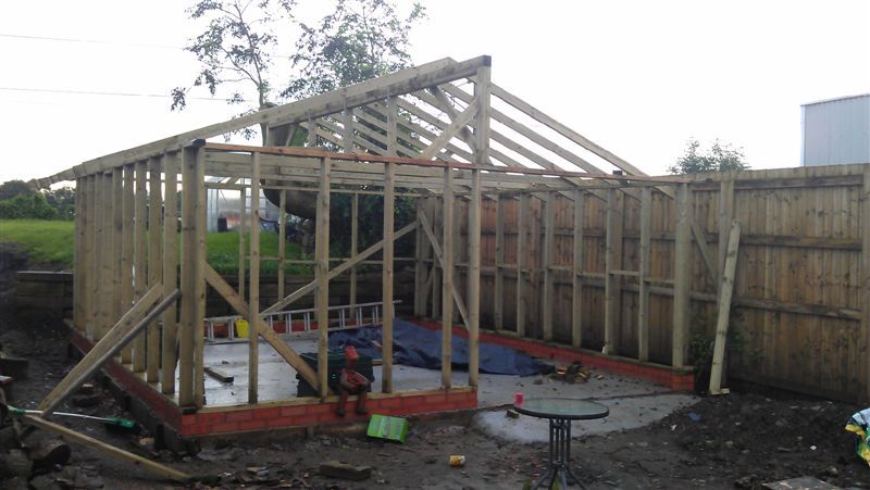

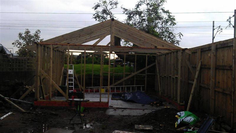

It's mid way.. framing is nearly done, just this god awful weather is seriously hindering process!!
Took a few days to get the brickwork done then let it set hard, but to get the frame done its taken about 3 full days. Waiting on the new delivery of wood so I can clad it.
It's gonna be a good size tho, its like another house at the bottom of the garden!!!

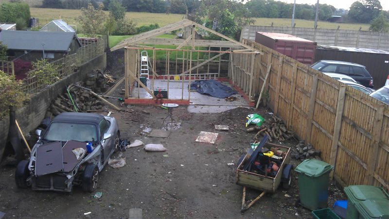

one day it will be dry yes, then it will be bloody marvelous!! few pics i took this morning.
the walls are 7.5ft to the eves, and then its another 4ft to the ridge. all together its cost £475 for the wood for the framing, and I will have plenty left with to make a solid work bench, wood store outside and make some doors for the garage. I think that I will ply line the inside of the garage, it will make it stonger and warmer, also its neater for shelves and the likes. for the extra £200 its prob worth it in the long run
The roof is going to be covered in Onduline Bitumen Sheets. They are a corrugated sheet and I think i am going to go for the Green colour. This is the stuff.
http://www.eroofs.co.uk/shop/product.as ... 68&dept=74
Hoping to have the garage completed for £2500 or there abouts, which i dont think is too bad.
