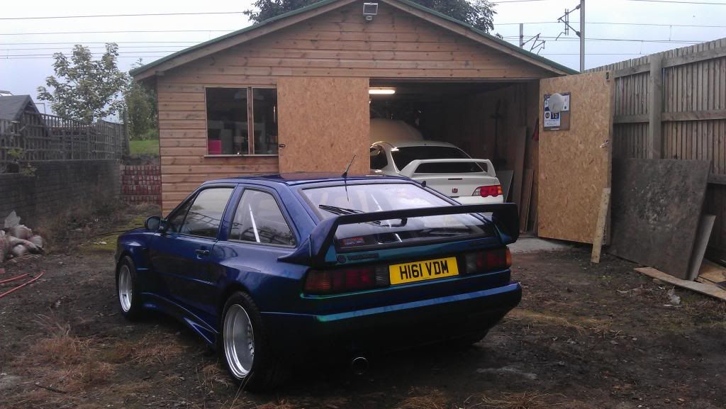

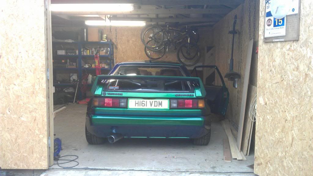

She is home!!
Nearly ripped the front bumper off again, getting it on and off the trailor and then into the garage. forgot how low the front end is, i had to make special ramps to get it in there!!
There is plenty of space to work on the car in there, although i need to get rid of 2 sofas that are taking up valuable space!!

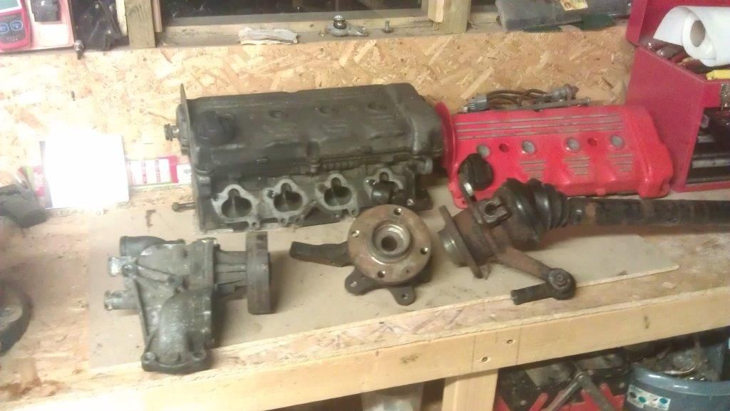

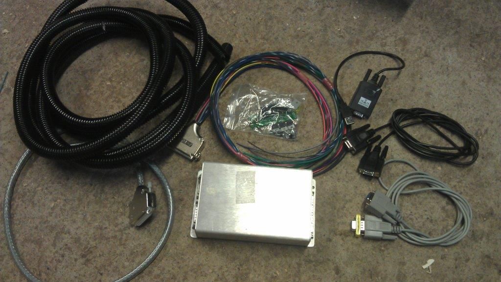

I've been in the garage this evening. had to sort out loads of stuff that i brought back from the big building! There was loads of stuff including my megasquirt, some fireblade throttle bodies, 2 cylinder heads, my inlet manifolds, metering head etc. I've got a couple of heads and some parts for sale because i just don't have room for it. Check out the for sale section. I'm still planning on running the throttle bodies with the megasquirt.

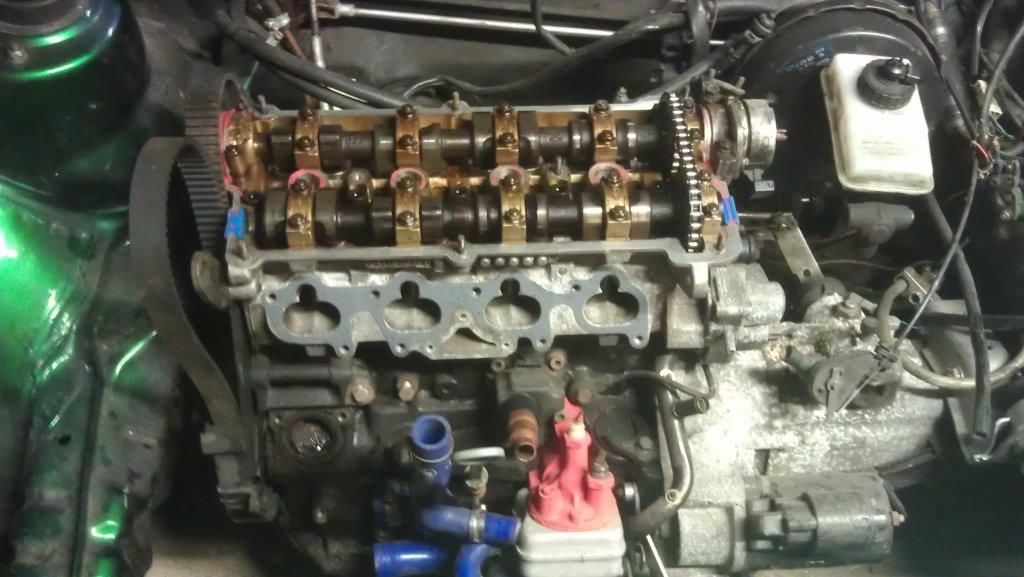

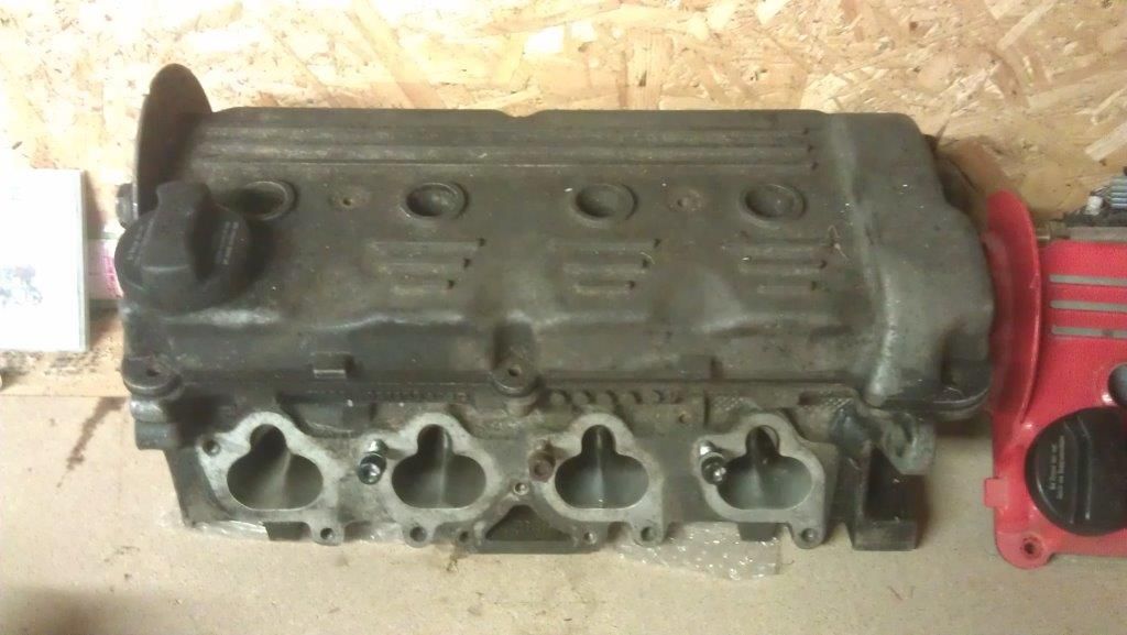

Took the alternator and water pump off, going to get a new pump, its probably been on for 6 or 7 years but still spins ok. Going to change he head on the engine too, since i last updated this post, i've bought a bydenstein ported head, with schrick cams. should give it a little more poke, Wondering about changing the bearings and rings, but i dont know what size to get, is there any way to tell what size you need? I also need to buy a socket to undo the head bolts. do you know what socket i need?
I then took the hubs off so that I can change the wheel bearings, I couldn't get the track rod ends off the hubs so just undid them from the steering arms, the ends seem ok so will leave them for the time being.. One of the boots is ripped so i will change that too. I will also get some new brake pads - think some fast road ones with the 280mm discs are in order.

of and the rocco looks happy in its new home :)
