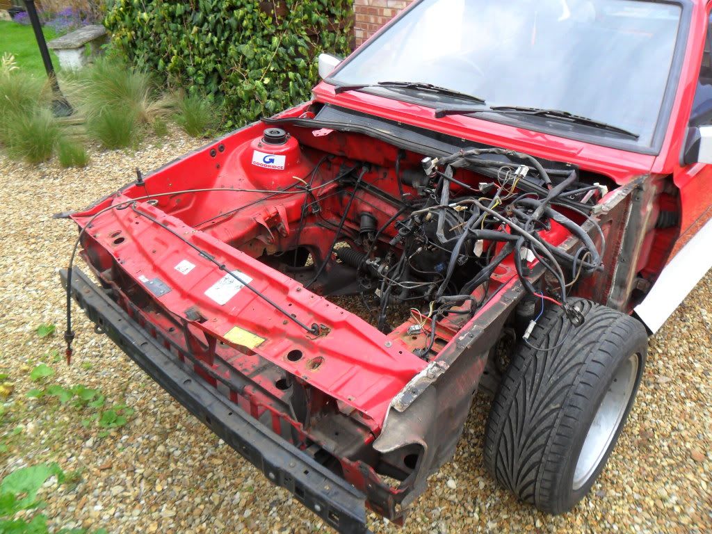

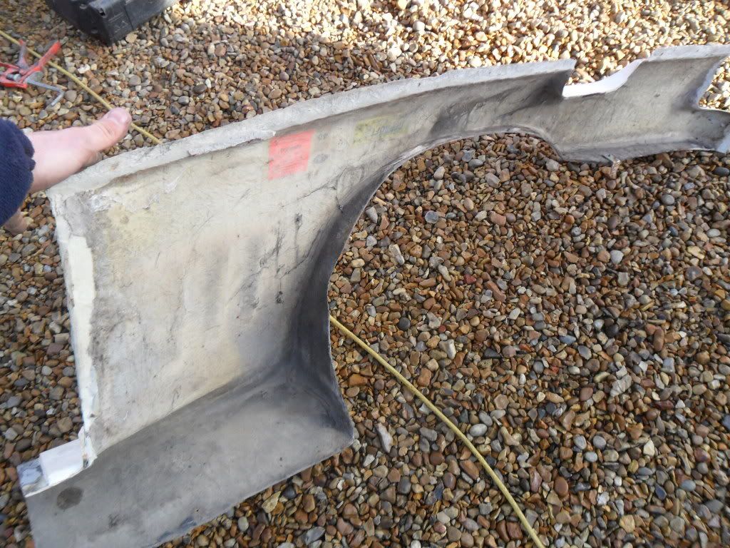

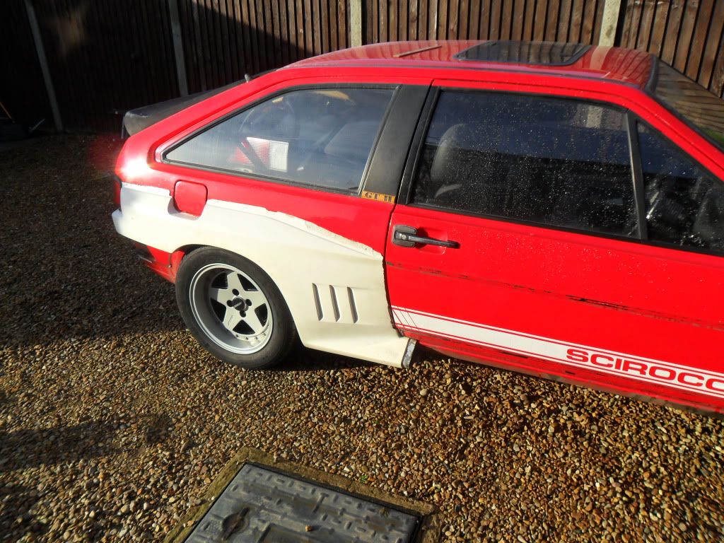

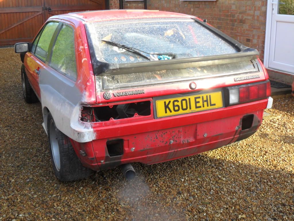

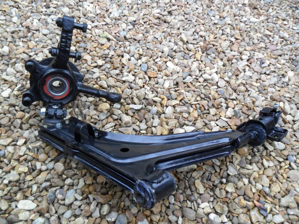

hello to everyone, i have been on here for a while and thought i would upload a few pictures of my progress with my mk2 scirocco gt2 that i have fitted a zender z400 body kit that i removed from a rotten scirocco (white one) that my brother bought and at the moment i am putting a AUM 20vt engine in. I have gone abit crazy with all the bits im buying for it, new bushes.. ball joints.. bearings .. brakes.. but it will all make for a nice ride when finished :)
Here are some photos before and during the conversion

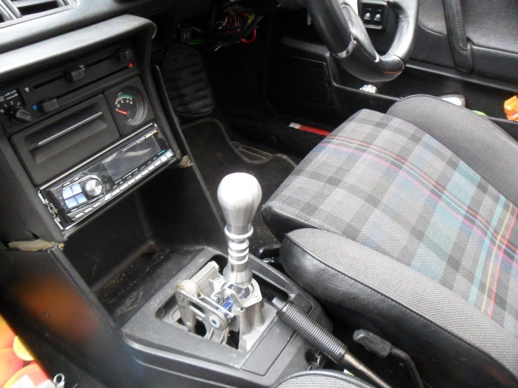

Very excited to see this develop. What gearbox/shifter are you using??

I think i can remember a tidy red mk2 at UD mate.. must have been you. And i am using a O2J gearbox with mk4 cable shifter and a B&M Short shifter. And as for the clutch set up i am using a lightened g60 flywheel with standard luk clutch kit and running the SEAT cable clutch system.

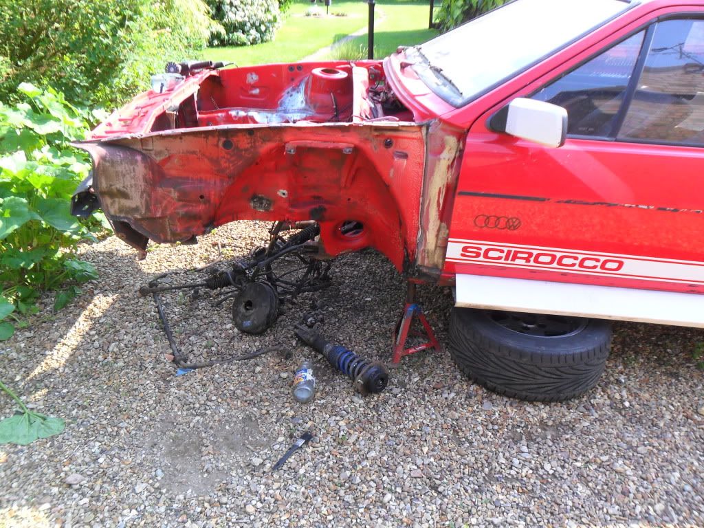

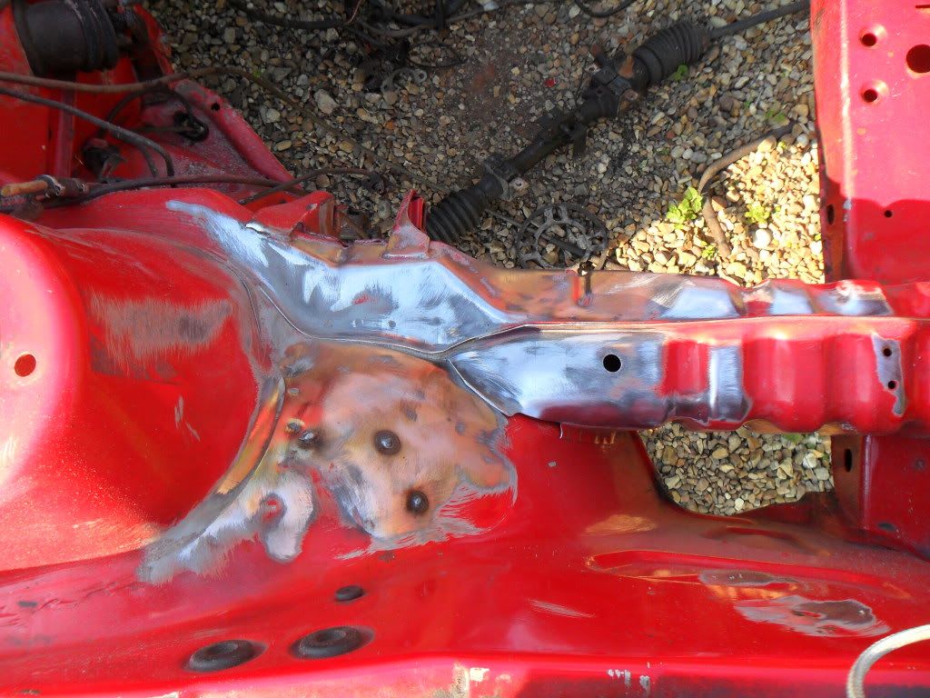

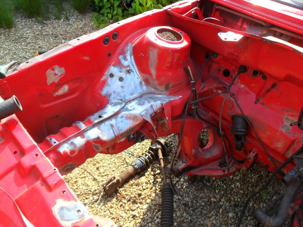

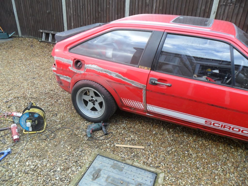

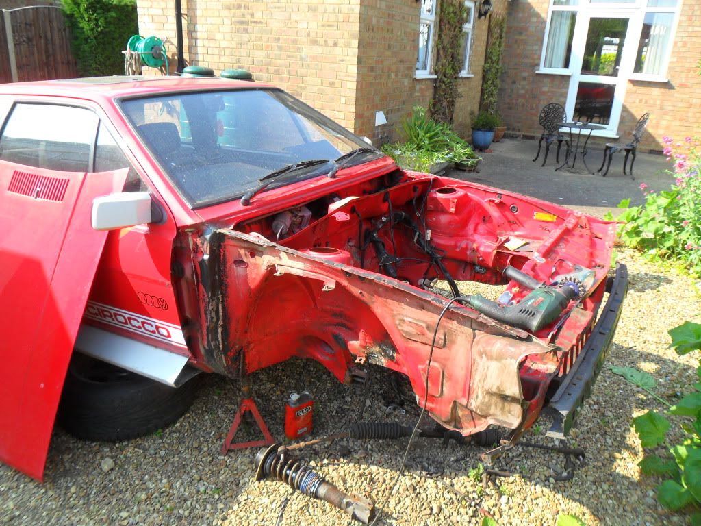

A little update of a few hours of removing battery tray, expansion tank bracket, washer bottle bracket, and vacuum tank bracket... Plug welded the holes, sealed and skimed. Rust removal to the slam panel.
