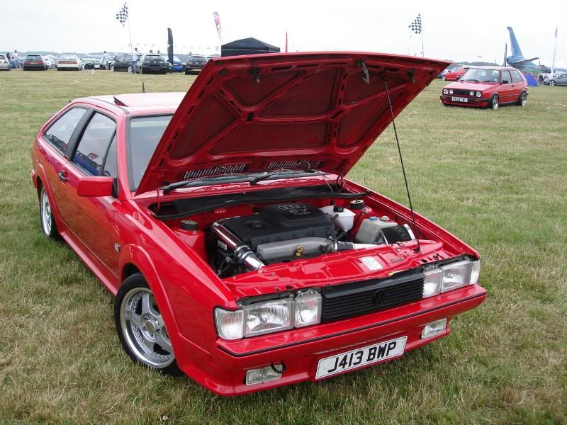

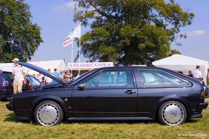

Chap called Simon has a mint 20v t red gt11 done by the Phirm a few years back.
here it plus the edition 38 car that is a reshell of another 20v t car from a bout 6 years ago -
here you are - the original car
