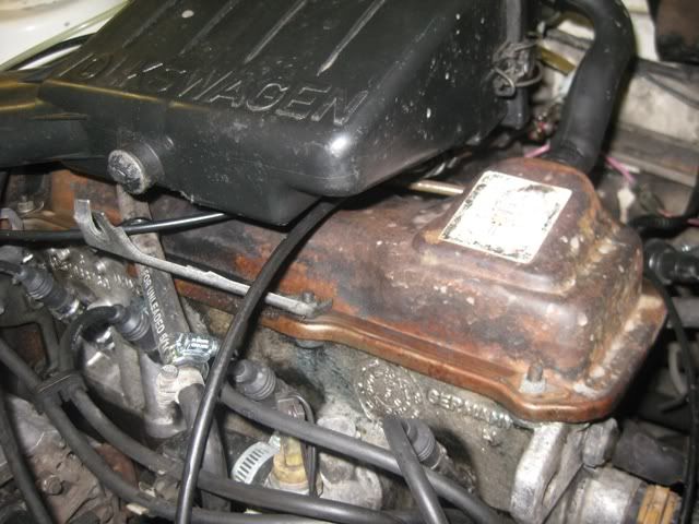

Its pretty simple to change, take the air filter housing off so get to the rocker cover, 8 or so nuts to remove then the cover will come off and you can swap the gasket out for a new one
Can also use a rubber gasket but i think that requires changing the studs for longer ones
