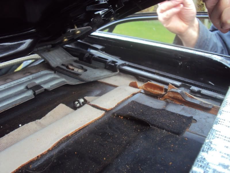

at last got around to having a look at the roof today, I seem to be missing a few bits!
From the looks of the Haynes, I'm missing a bar across the centre, a spring and 1 and a half side support things
also found a quality check note dated November 1987, so presume all the bits were there!
i took a few pics of the mess, have i not spotted anything else that's missing?

The bar / spring combo hold the fabric panel in place.
The "things" that are not allowing proper operation is those slider doofers.

If I'm looking at this right then, the sliders locate into the slots in the rail beneath, and the centre bar goes through them, and also through those 2 hooks on the smaller headlining panel, and it should be back to general working order when adjusted?
will also need a new seal, as this one looks past its prime to say the least!

That pretty much sums it up, so long as the guide wires are in fine fettle. I would advise regreasing them whilst you have everything in bits though.
