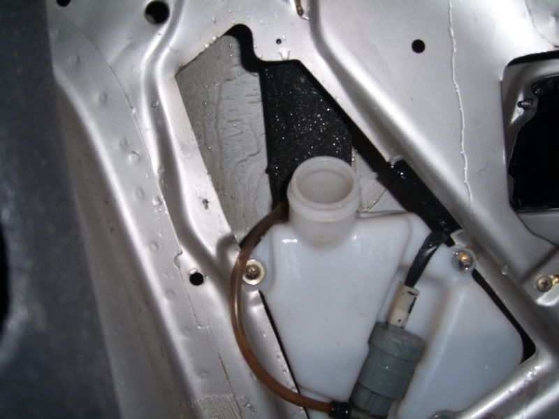

Re: Sunroof Rear Drain Pipes.....
Well we have eventually traced the cause of the mobile swimming pool I have in the boot of the mk2......With my mate in the boot and hosepipe full belt we discovered the water pissing in in two places. The main one seems to be where the speaker shelf meets the side body. Looks to me like a perished rear drain pipe that runs from back of sunroof down to the rear lights. The headlining is soaken and its finding the only way out, which is down past the rear washer bottle and into the boot. See pics....
Obviouslyt the headlining will have to be removed if I am going to loog at this but is it worth it?? Bearing in mind the car is garaged and is not my daily??
Any advise guys......

Thats a cracking option ian but we've sorted it. Curtain wire down the pipe from the top along with hot water and detergent and eventually unblocked it.....was full of red mud just like teh rest of the hidden parts of the car. BTW not had chance to call Tracey but will tomorrow.
