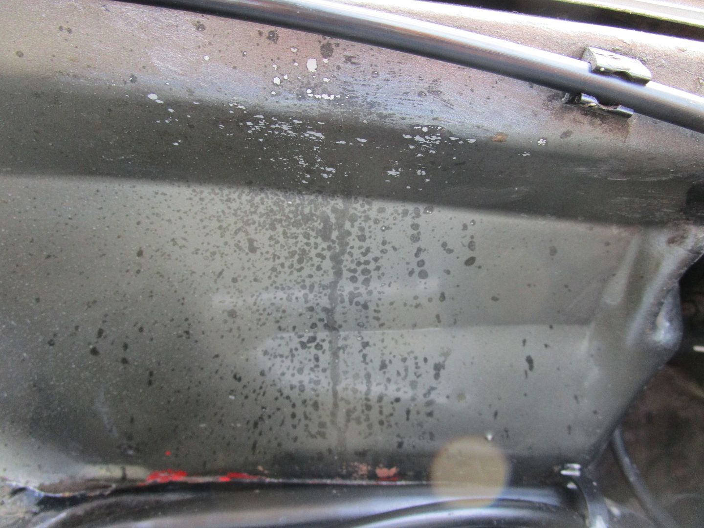

I used bicarbonate soda to clean what was left after several washes with water and soap the a good wash with a hose pipe the main loom near to the battery has not been covered in acid it seems most of came out the other side of the battery towards the engine a little towards the inner wing and main loom, this is what I'm left with, anyone know where I can get new plastic vac hoses as mine are looking terrible!
All the white looking dots are where the battery acid has been, it even hit the dissy cap, head and engine block!
White acid run marks all down the radiator
The inner wing.
