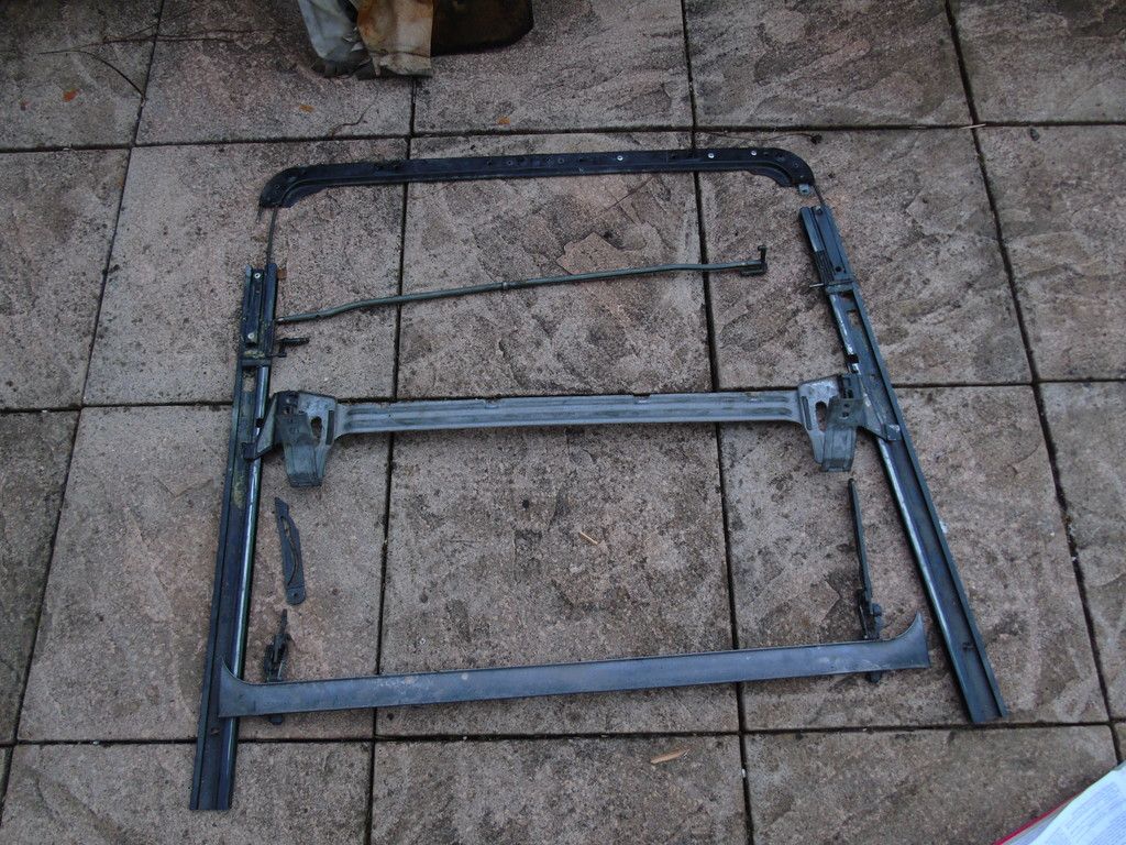

Hi Guys
Haven't been on here for a long time. Haven't been able to spend much time with my beloved GTX lately, however hoping to change this in the near future.
My first project has been to try and resurrect the slide & tilt sunroof.
To my horror the parts are definitely obsolete.
First problem over then...
So I cracked on and dismantled it. Que second problem the wind deflector had obviously been removed by some uncaring previous owner.....hate em!
Finally dismantled and out of the car. The cables seemed intact and not mangled.
The snag seems to lie in the water drain plate lever being broken along with the connecting rod spring.
My Question then?
Anyone got a clue on how I can deal with this?
I think the guide rail end sections are missing as well.
Regards Rob

Can you take a photo of the broken bits I have just rebuilt my roof most of the parts are available from Germany.
