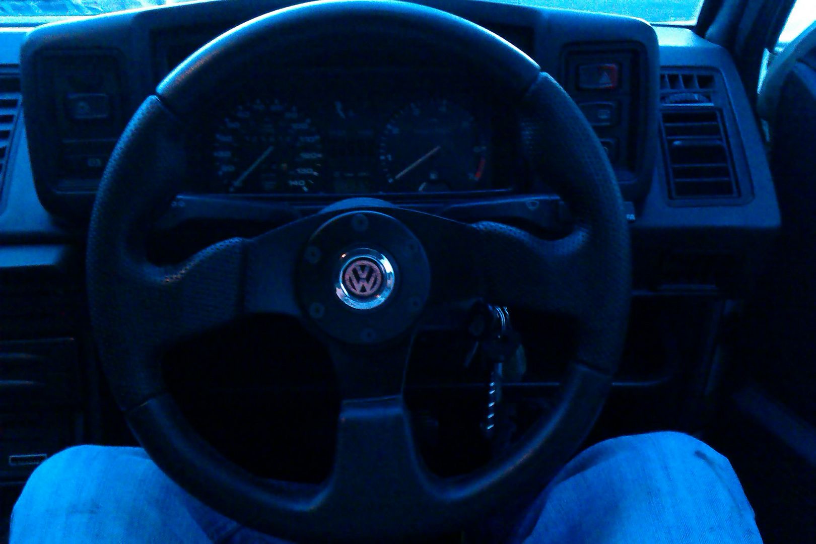

Fitted this lastnight but I cant get the horn working,
the boss only had a single assuming live wire in it, connected it up to the wire and nothing!!!! i'm assuming that it must have to be earthed, would this be onto the boss its self? or onto the steering column?
will be looking at it again at weekend so any hints or help would be great :)

A standard VW wheel has two wires a brown (earth) and a black one which is the one I assume you have connected to the horn push.

yeah i saw that on the one i removed, all i can think is it needs to earth, I'm going to see if i can add an additional wire to it!!!!
