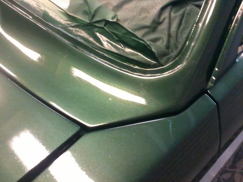

Its being a while, but I have being busy and had a few ups and downs painting the car. I will let the pictures do the talking.
In base coat.

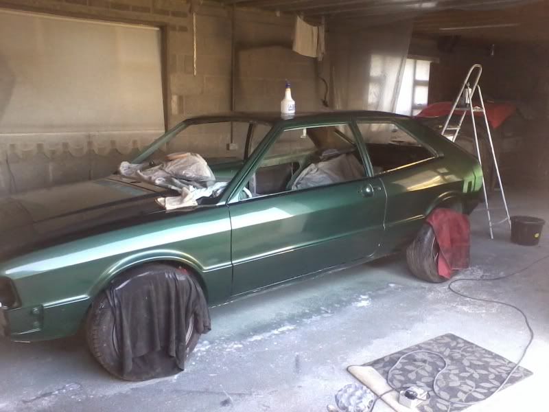

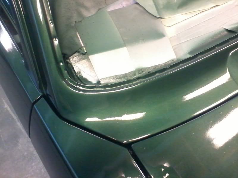

Lacquered up. I am happy with the wind screen corners, they came up perfect.

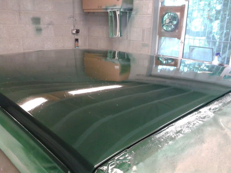

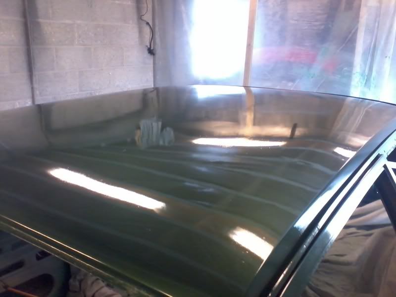

The roof, It looks good in the picture but I have some weird lacquer sinks, random but annoying seams the rest of the car is very good. I am going to re paint the roof.

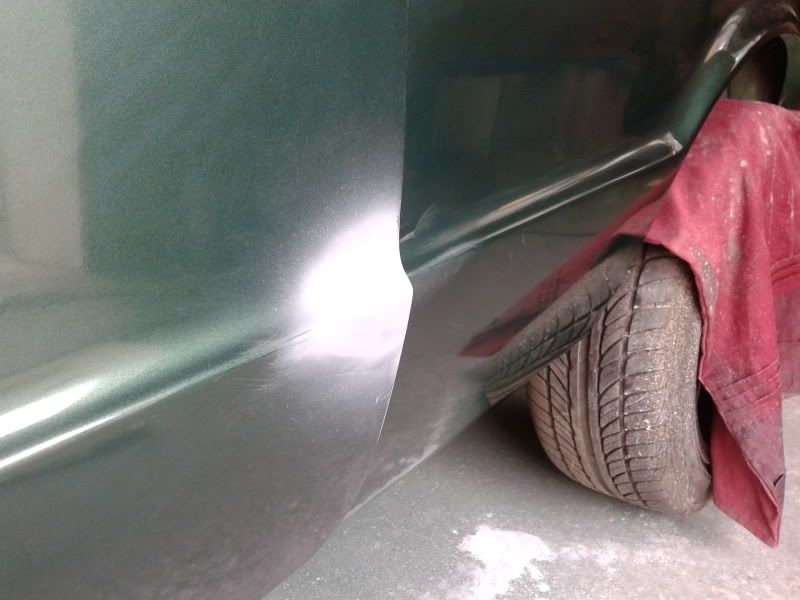

I also have some sort of reaction on the LHS door. I have tried aerosol primer to cover it but as soon as I put a shot of base coat on it wrinkles. :ire: I will probably have to re paint the door.

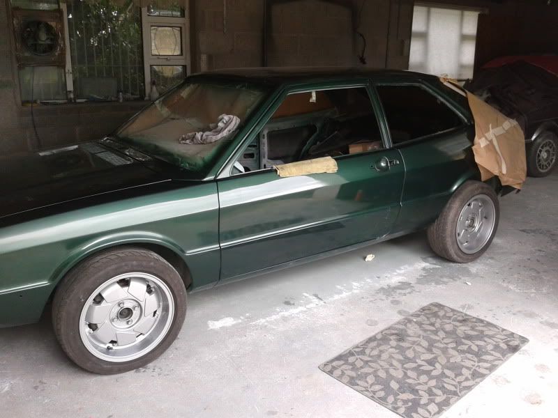

My ATS wheels.
love these. :nerner:
Car from the side.

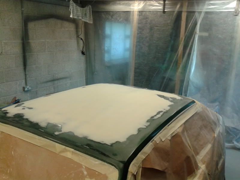

Roof back in putty. (spray filler) good stuff, sands well, A small bit of wet sanding and it comes up dead flat. I will coat it in primer and paint it up again. I want a really good finish. :beg:

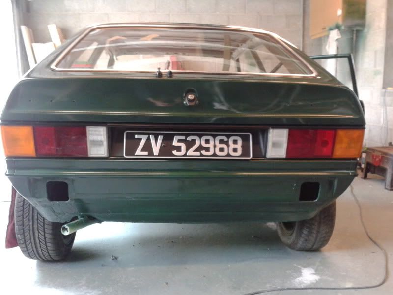

79 Scirocco wrote: Image
Love this shot, looks very mean. Just need a pair of exhaust tips coming out of the bumper mounting holes :hugegrin:

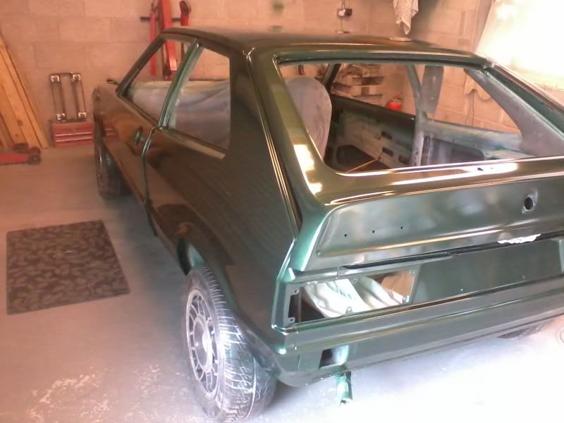

got my roof re painted. noot too bad but a few bits of crap to wet sand out. I guess as good as I will get seams I have a make shift spray area.

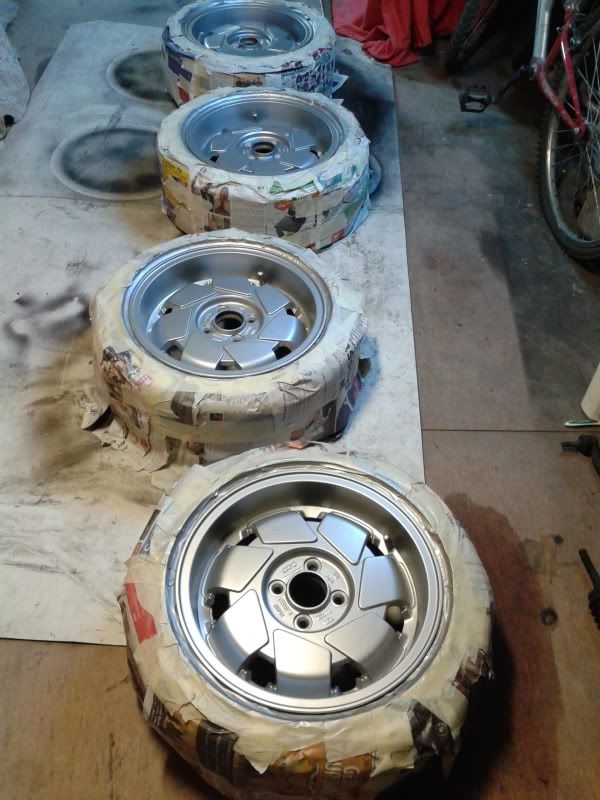

Wheels test.

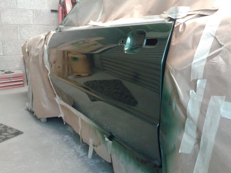

the door came up very good, I must be getting better. :chortle:

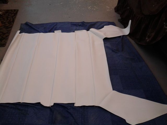

and I got my new headlining, should be fun fitting. :focus:

Headliner rolled out, I got it made locally. Looks the business.

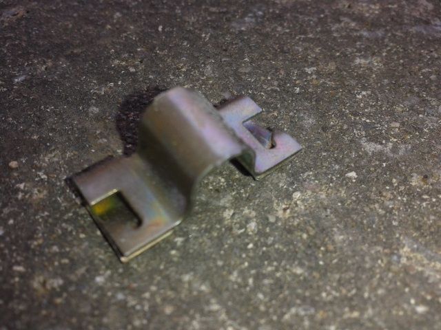

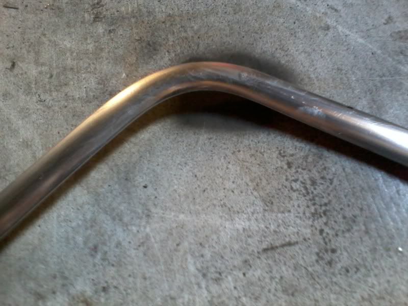

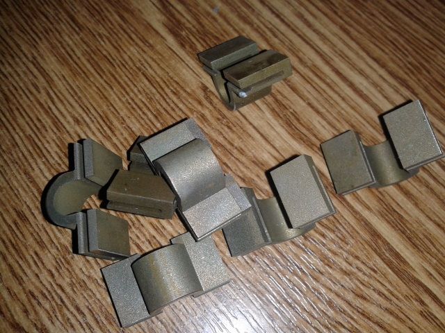

Next issue I got some roof rods from a mk2 (Well so I was told) they were too short by about 15 mm which doesn’t sound like a lot but they don’t touch the roof skin so they wont stay up the right way, add to my issues I only have 2 roof clips.
These lads.
I got some 4 mm stainless rod and cut them 1013 mm each and my local VW dealer says he could get the clips at 49 cent each nice and cheap but I would have to wait up to 6 weeks, so I made these, a bit stronger wire EDM’d them out in a few hrs. the fit a treat and I have the rods in with the head liner, just getting round to gluing the headlining in.
