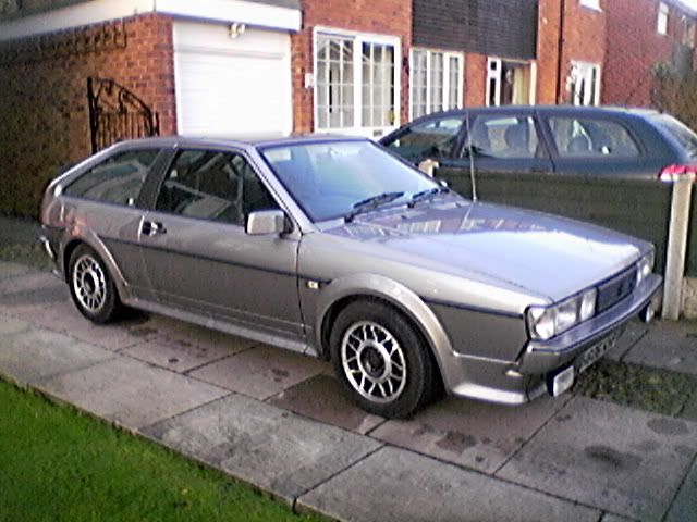

June 05- 57k 1 little old lady owner Scala - Bought as a potential donor shell for the then wrecked BRM car but on reflection too nice to mess with that much.
Early shot by which time I had already sorted the scabby Avus rims, a Weitec GT kit, Jetex exhaust, shortshift, c and r lower brace/neuspeed top brace, clear indies and NOS gtx rear lights. Removed a tow bar (owner had a dinghy) and swapped the always tacky Scala B pillar badges for Storm style Karmann ones that had survived from the wreck.
What you cant see in this crappy shot is the badly scraped bumpers/bodykit and matt finish near side panels/door courtesy of the previous owners parking (it would appear) by touch habits.
Feb 06 - Bumpers/bodykit and other partial paint work courtesy of Phirm fx plus grille/grille spoiler/16v aerial mods.
