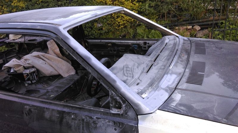

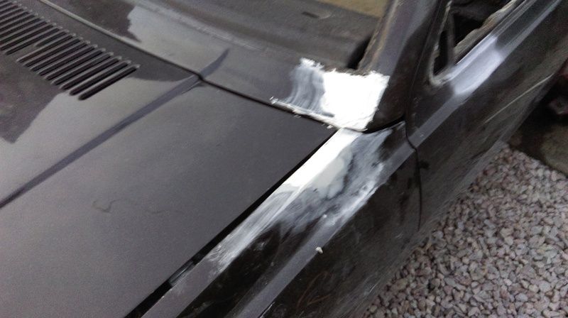

i paid a bodyshop years ago to cut out the rust, weld it up, fill and paint the bottom of the windscreen areas. it had started to crack so i investigated. seems like they hammered the metal (and rust) down and coated it in filler. great work! anyway cut it out, plated and filler both sides. come to think about it i have had to redo all of their 'repairs!'
i always had smoothed joins anyway so will still look the same. even removed the windows in one piece!
welded over the aerial hole too as i have always had problems with that area rusting. problem solved
now sanded

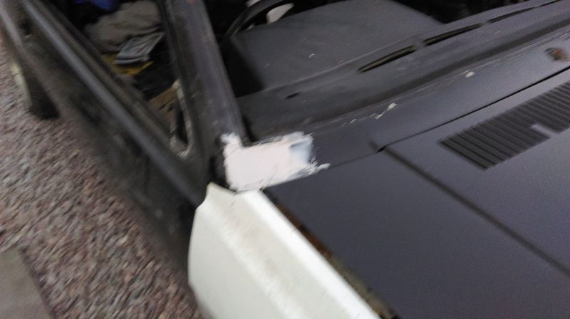

few patches on the door
and engine. just because
