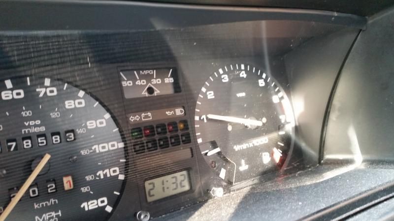

I'm after some advice please guys. My rocco seems to run hot, when you're driving the gauge creeps up but when you keep moving (and put the heater on) it settles back down again.
Started her today as she hasn't been run for a bit and within a couple of minutes (choke still on) the gauge crept right up
She was idling at about 1100 rpm for a couple of minutes.
Thought I'd put the heater on and see if the temp came down a bit but this time there was no heat out of the blower.
Also the fan hadn't kicked in by the time I turned it off, and the gauge was almost at the max.
Any ideas please? I'm used to air-cooleds, we don't have to fanny around with all this water malarky!!

Cheers Ian. I'll have a look at the fuse tomorrow, (but it was still getting hot before and the fan was working then). Er....where's the thermo switch? And what's the best way to check if the water pump is working? Looking in the top of the rad it looks like there's enough water in there.ianaudia4 wrote:Check your fan fuse first, if okay then the thermo switch. Water pump working? I know it is like sucking eggs but do you have enough coolant (and the right type G11)?
