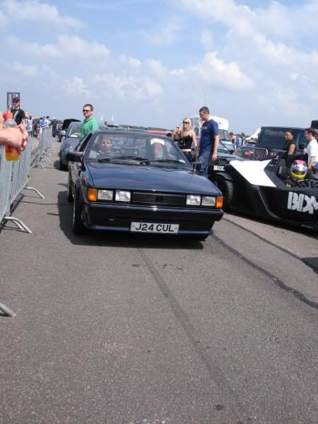

Got a shot of it in the 1/4 mile q at Inters 2009 too.

Wow. I’d forgotten about the beaulieu meet. Great pics. I did enjoy inters at bruntingthorpe. I think I ran a 17.1, hardly what you’d call rapid!
