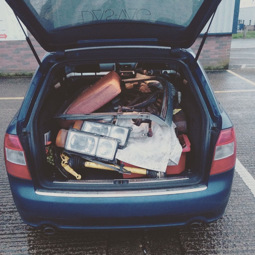

Post by T33stat » Sun Jan 10, 2016 3:03 pm
Took a trip up north to get a few parts, ended up loading the car up completely!
Also trying to find the source of the leak still, covered the seal with duct tape so it will either identify the fault or eliminate this as the fault!
Mk2 1.8 GT2 Project - Aubrey
viewtopic.php?f=19&t=19331
