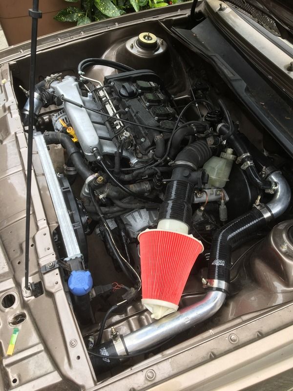

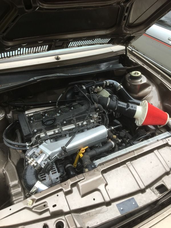

Quick update, engine bay is pretty much done now, just gotta finish the wiring. There are way too many jubilee clips and made up pipes everywhere which I will get replaced once the things on the road, but for now I just want it running so I can get it to the national meet. Things to do- fit the modified loom, get Ecu decoded, make a fuel pump loom, fit battery in boot and make new battery cables, finish clutch, fit brake callipers and bleed system, refit interior, wire lights etc back up.
So still a way to go but not too bad.
