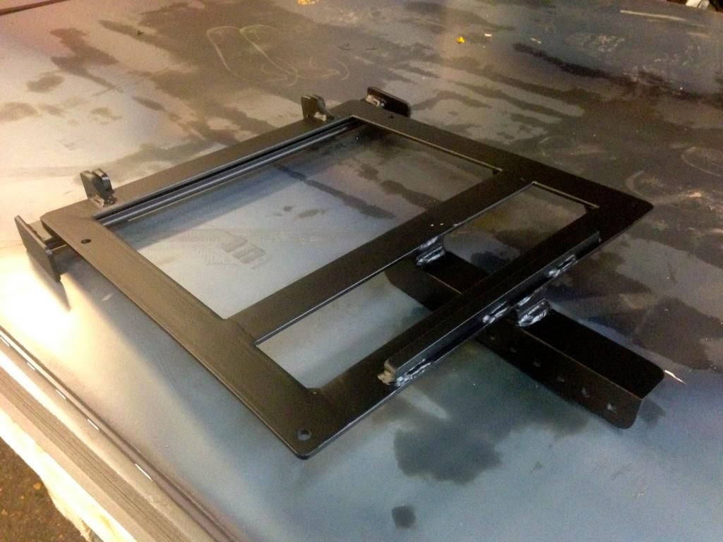

Oh I realised I never posted a photo of the subframes I made for the seats... They're sliding - with some effort! The pivot at the back is around a couple of M8 bolts and nylocs, with the bolts done up tight the seat is held in place pretty well. They're designed just for my driving position really but I can slide them out and move them forwards or backwards if I have to.

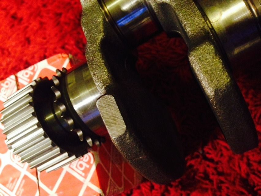

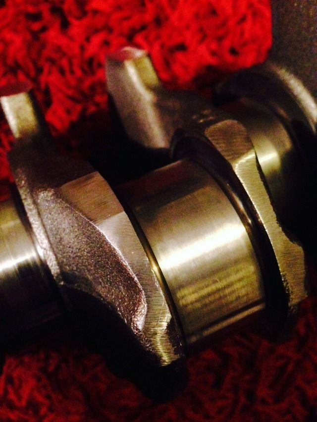

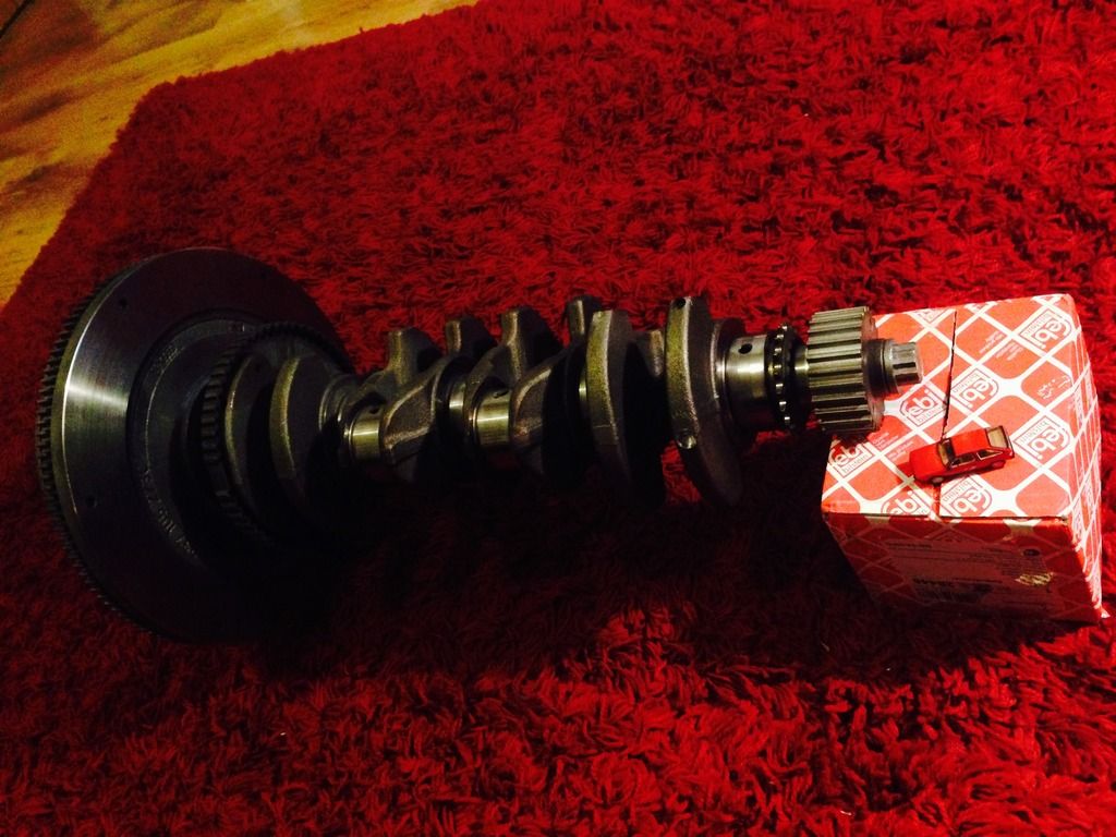

So this week I visited a local machine shop to pick up some of Herman's engine parts.. and he now has a part lightened and fully balanced rotating assembly.. result. This thing should be smooth as now.

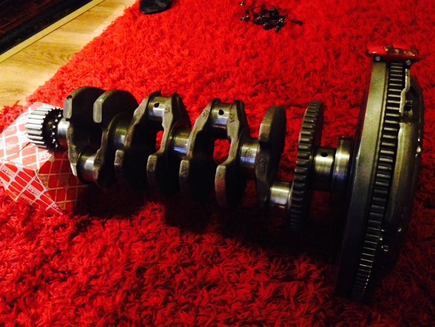

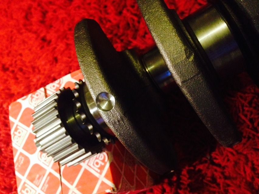

These crankshafts are supposedly balanced before VW install them but they're not all done to precision it would seem.. The crank and pulley were added together and spun up. Then material was removed from the number 1 piston counterweights:
Either side of number one piston big end journal:
And on one of piston 3's counter weights:

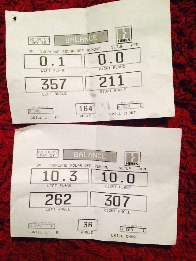

Here's the balancing report.. the bottom sheet is for the crankshaft and the top sheet for the flywheel and pressure plate. No material was removed from the flywheel which is pretty cool, it means our lightening job must have been a pretty good one! Pleased with that for a first effort.

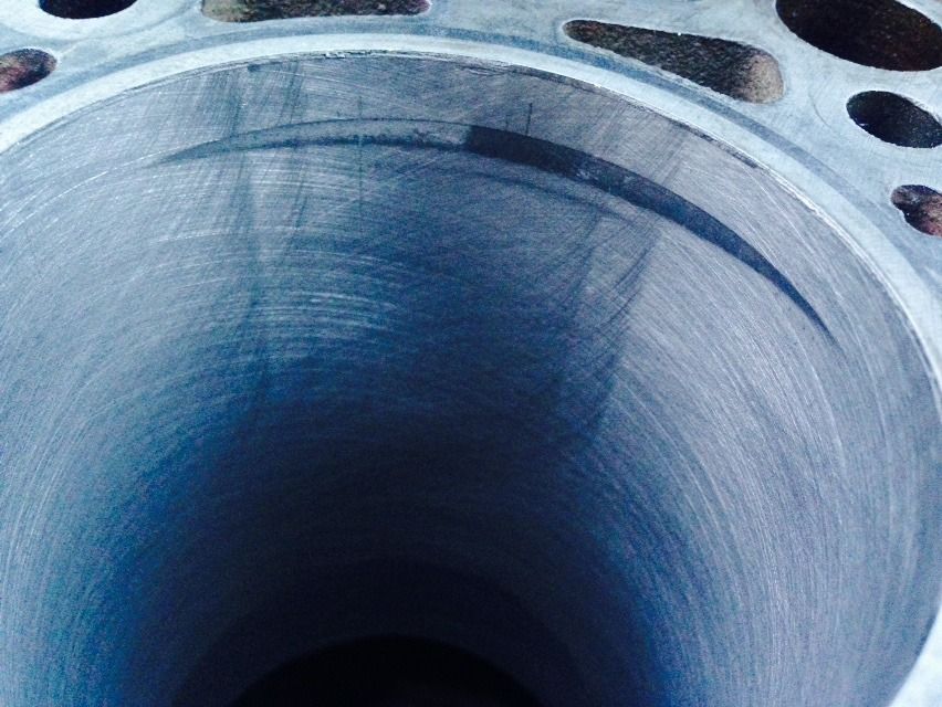

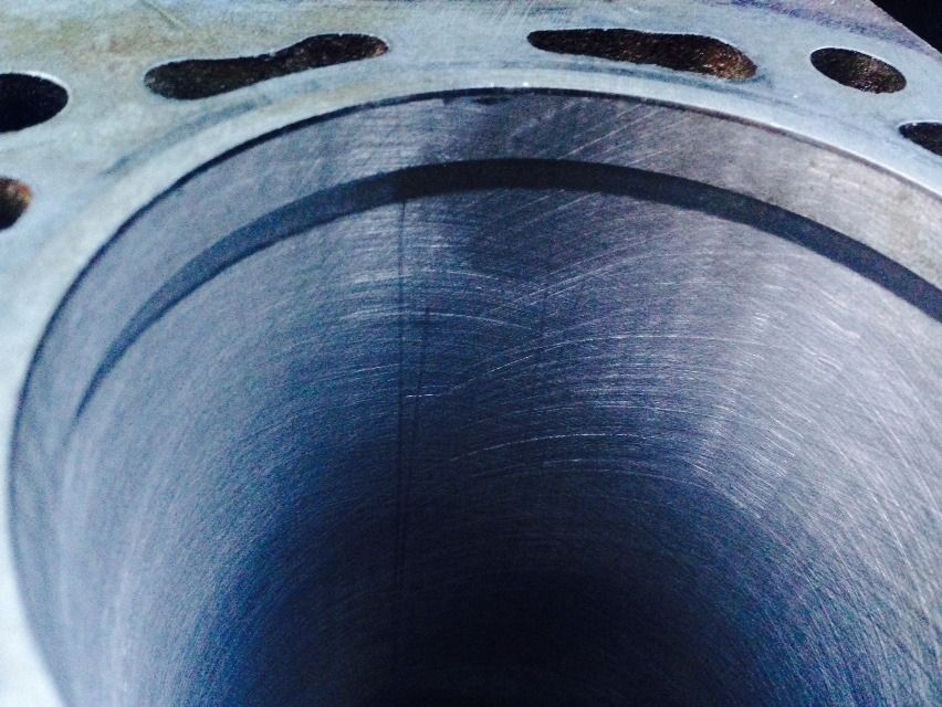

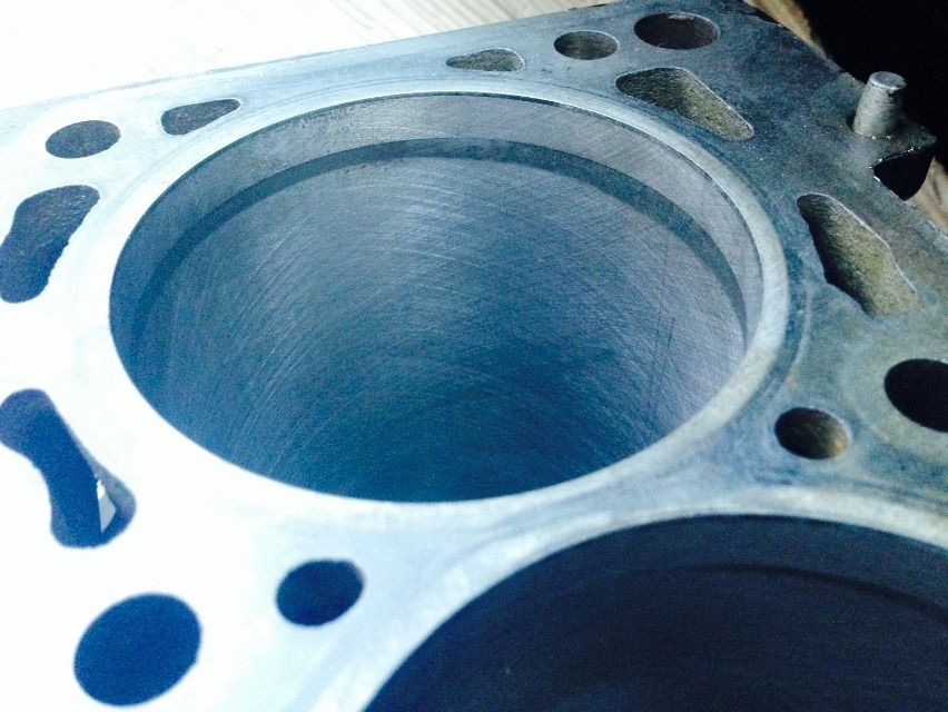

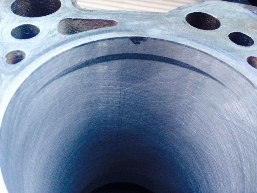

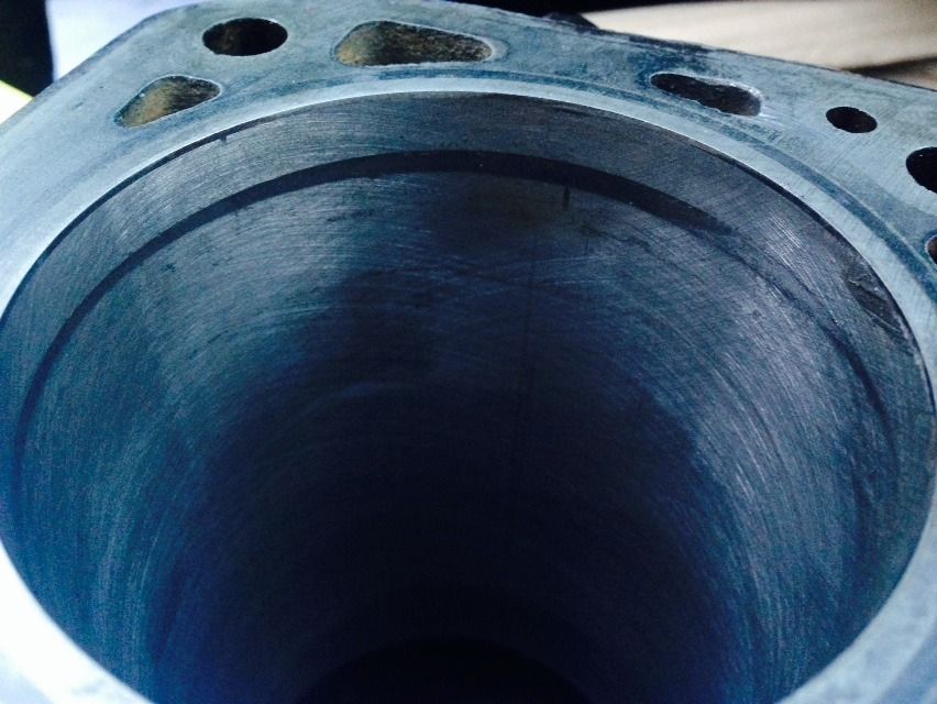

After getting my block sand blasted and painted I found out a machine hone wasn't good enough for it and the 120k block would need reboring to be built back up.. a massive arse and more £££!! You can see the wear in each cylinder..
One bore was so bad it had wear around nearly the whole circumference

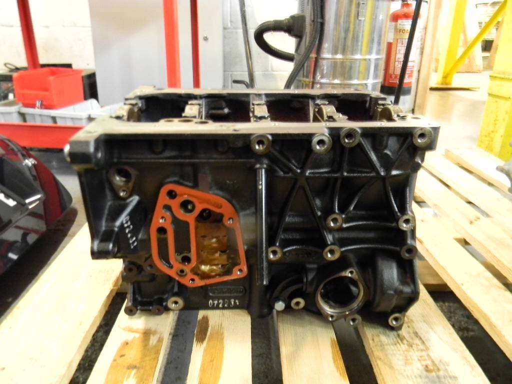

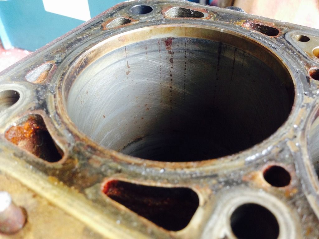

The machinist was surprised I didn't have oil blowby and a smoky exhaust! With the price of a rebore and new pistons and rings I decided to look for a new block as I already have my rings and pistons waiting to go in! I managed to find an Audi A4 cabriolet block on ebay that had had turbo failure. It only had 53k miles on it and looked in good condition.
Drove down to give it a health inspection and it still had the original cross hatching! The bores looked much better so I snapped it up!
I asked the machinist 'what's the advantage of you honing it? what's wrong with me just using a honing tool on a drill?' to which he quietly replied 'well my honing tool cost £60,000'. Good salesman..
