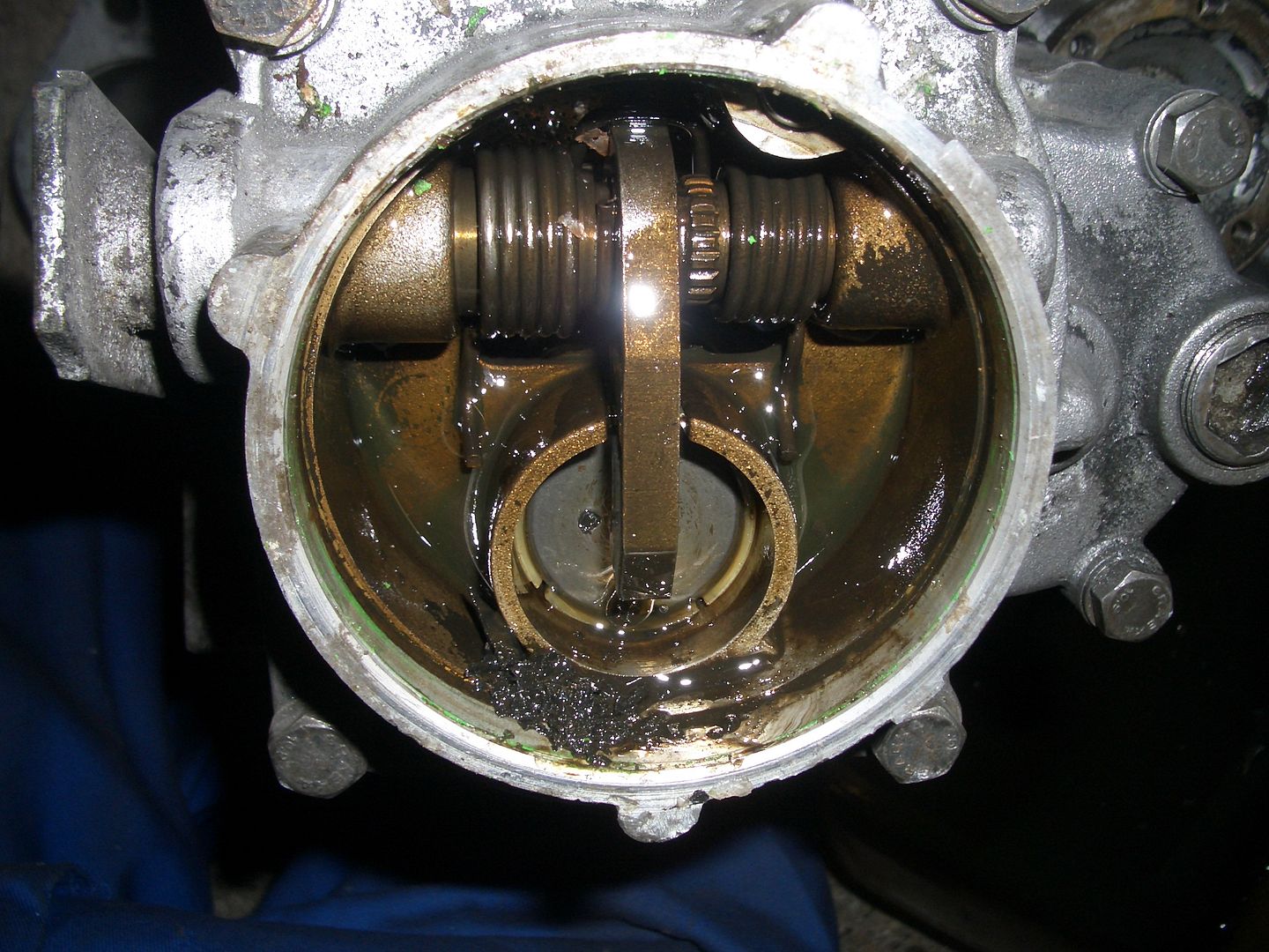

I also checked, cleaned out and changed the thrust bearing but this can be done with the gearbox on the car if you don't want to do it now.
Gunk I found behind my green cap.

how do i know if the trust bearing needs replacing? not really ever heard of one failing. i think i may leave it for now as its easy to access later on. those green caps are almost £15! last time i bought one it was £3.50!

Worn thrust bearing will make a grinding noise when you press the clutch down, I just changed mine as it was a 2nd hand gearbox and did not know much about it.
