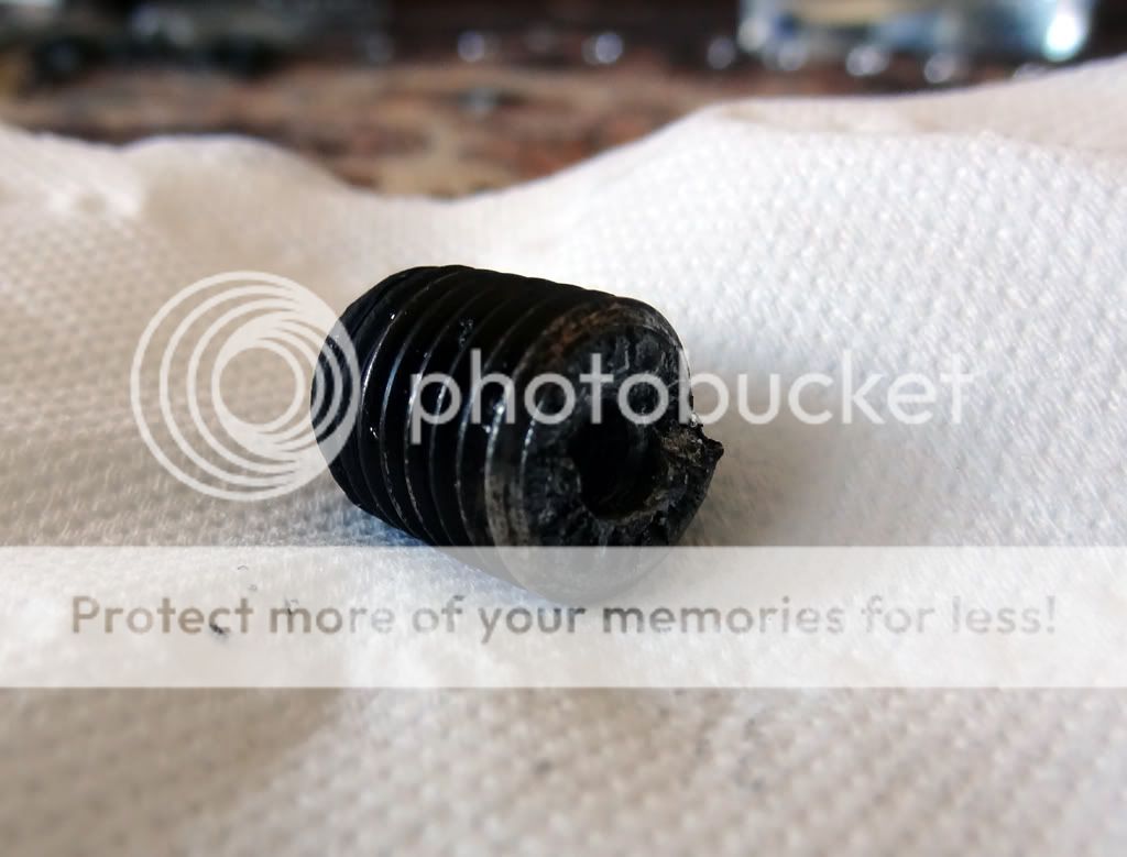

Re: Snapped wheel bolt...
Got it:
Carbide drill bit into the centre of the remaining stud, and then found that it suddenly freed off and came out with an appropriately-sized flathead screwdriver. Off to get new bolts this weekend.
